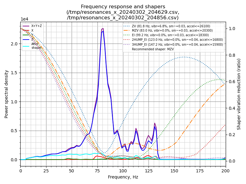

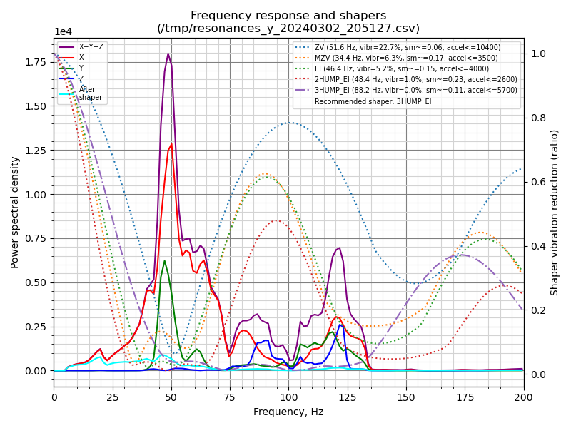

hmmmm… Its not liking something for Y That should be a lot cleaner graph, similar to X
Where did you end up with belt tuning?

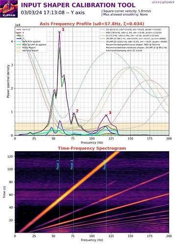

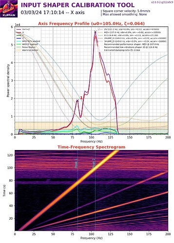

Okay did a belt tuning, GitHub - Frix-x/klippain-shaketune: Klipper streamlined input shaper workflow and calibration tools got them to 96%
Before and after X
Before and after Y
I am going to do a couple prints, before and after the tuning now.

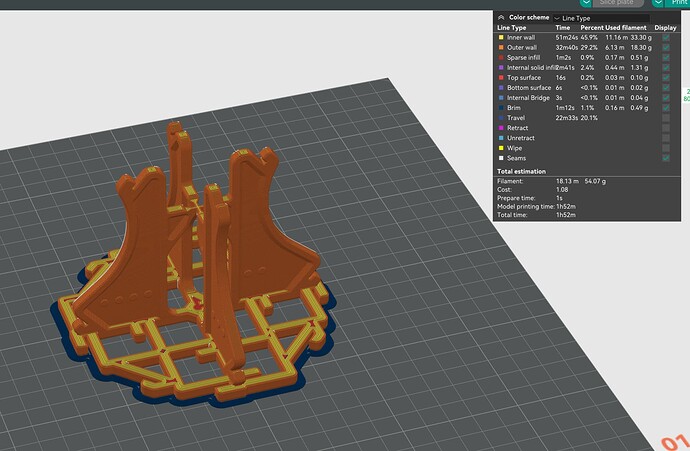

Printing at 85mm/s .3mm layers 0.5nozzle that should get my extruder to 90% capacity, 160mm/s travel.
