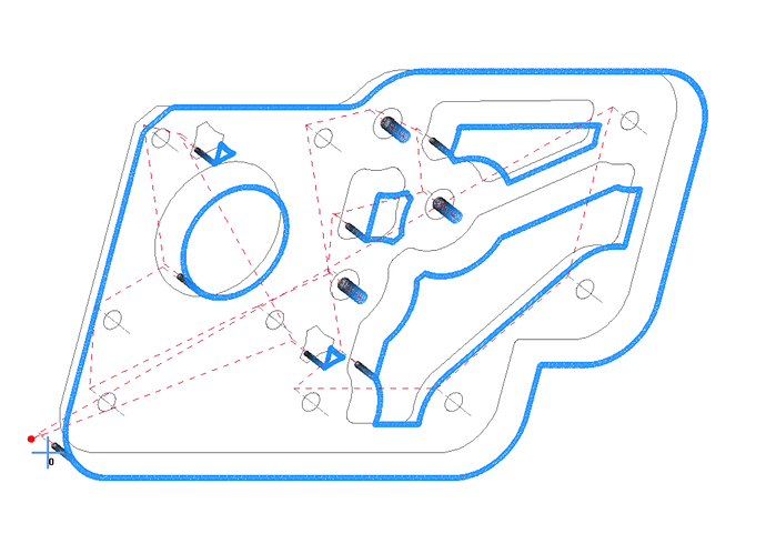

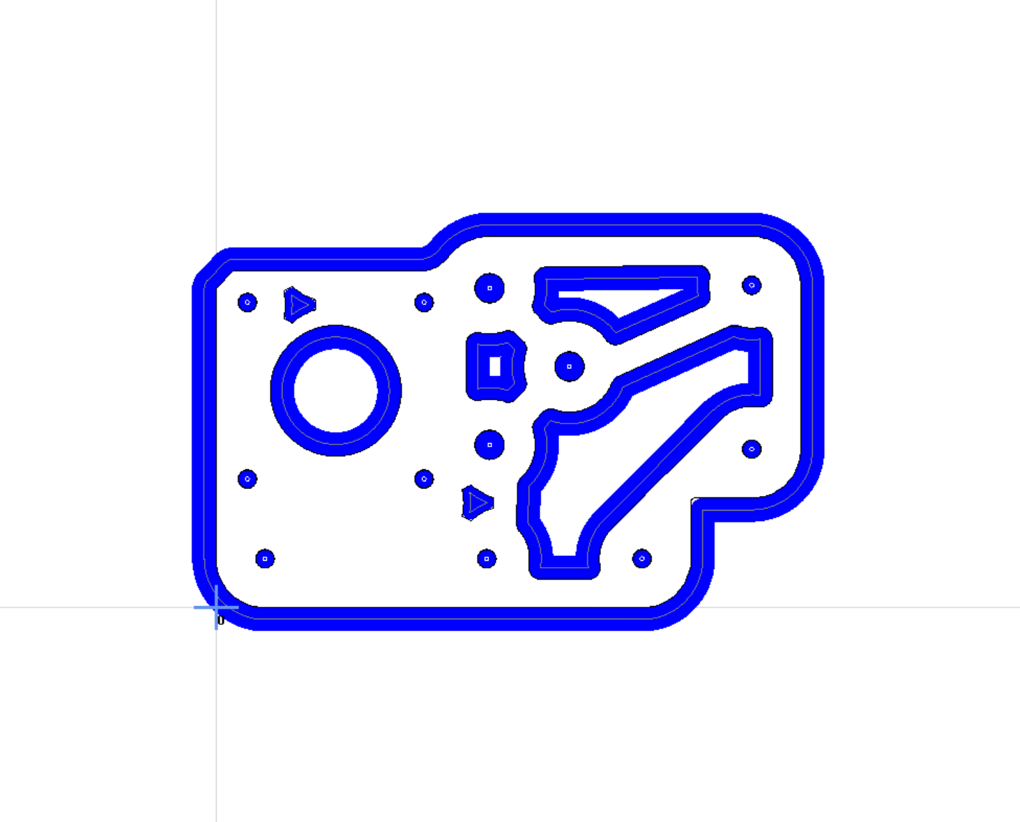

Looking like just shy of 20 min (with a bit change) to mill the largest part. That’s not too bad at all. And I know I could push harder and get it done quicker but no reason to.
So you are using aluminum? And lr? What bit? The logos look like a bit breaker.
Yes sir
Correct
This one for as much as possible…
And this one for the tiny logos
I have used the 1/16" in aluminum before and it does really well. Just have to take it easy. I do all my aluminum with Trochoidal milling.
Maybe try to grab some video if you can??
I will. I have some other videos of milling aluminum as well…
