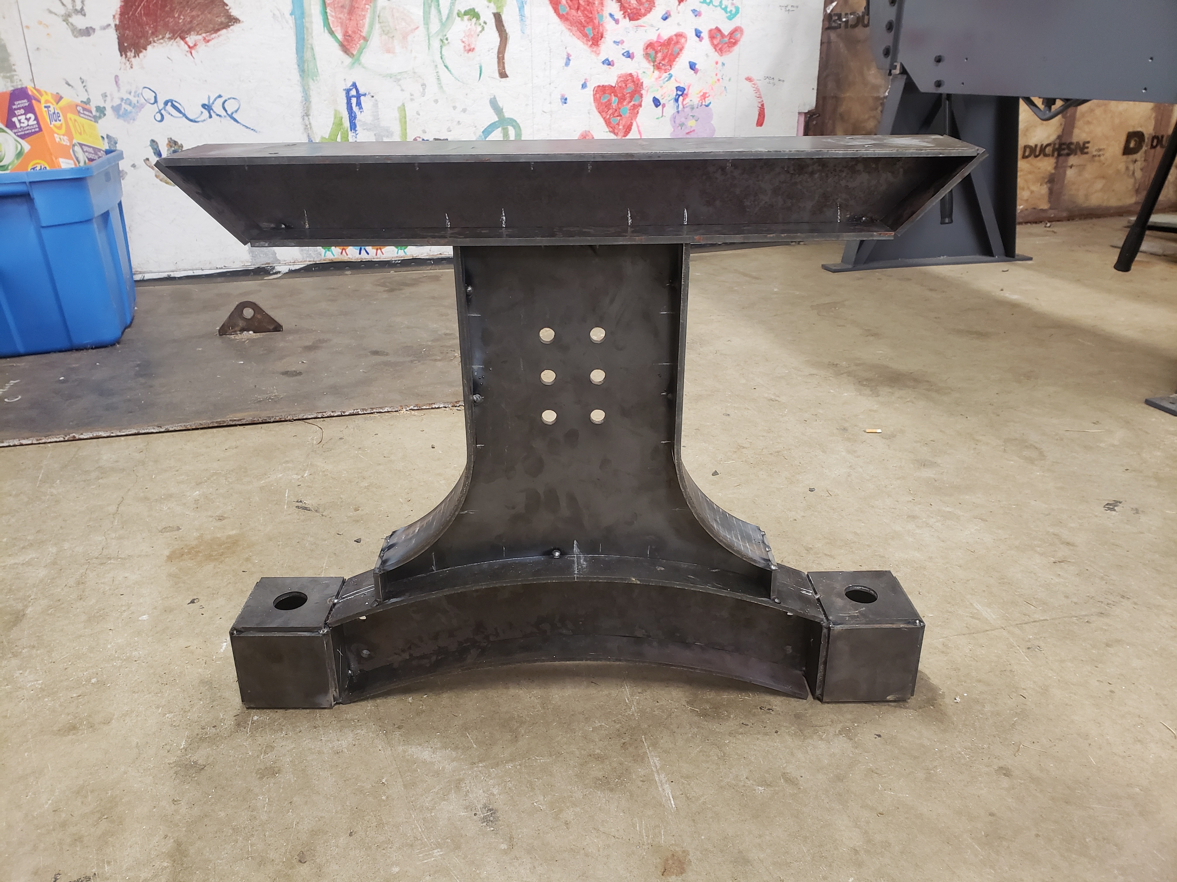

Heavy metal dining
Been tough, i will update

Dang, that thing looks heavy! How much does each leg weigh?

The arcs look pretty dang good, I hope you have some sort of automatic or semi automatic press, doing that on a manual would take some time.

Did you roll those plates your self or outsource?
Too thick for my rollers, had to brake every 3/8", thats whatt all the lines are. All by hand

About 75lbs id say…

Just have to verify measurements and weld. Also will be some lathe work for the feet.

That looks like a heck of a lot of fun, all except moving it around. Do you have one of those rolling shop cranes or a cherry picker to move this stuff?
I do have a gantry for handling .5 plates and larger but this all comes apart, heaviest part is like 75lbs
