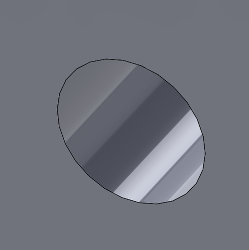

I wouldn’t be so confident about what is going on based on what is shown on the screen vs what is real. As I said above, Solidworks will render cylindrical features as faceted in some circumstances. Just because it looks one way in the tool doesn’t mean that it is. This is why there was the suggestion to find a different visualisation software to see if that was still the case. I think it would be obvious by the number of lines in the gcode, though.
Actually, what are you importing into ESTLCAM? That DXF or the step file? If it’s the step file then I’ve never worked with solid models within ESTLCAM. Perhaps try import the DXF and see if it works as a pocketed feature?
Just as an ‘out of interest’ example, that’s what an extruded cut looks like in Solidworks formed from a 6mm diameter circle. As you can see, it’s clearly being rendered as faceted. If I export that face as a .dxf then it has a circle field defining the position of the circle and if I export it as a .step file, there are circle entries that look like they’re being used to define the hole in the middle, so it’s clearly just rendering the part as faceted, not actually working with it as facets.

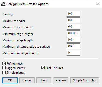

STL Files consist of triangles only - they can only approximate circles no matter if the design file format used real circles or not.
Some programs allow to adjust the conversion precision for STL export - and Estlcams 3D machining also has a precision setting - but for 3D in Estlcam the result will always be lines.
The 2D part of Estlcam uses real arcs and circles.

What is the minimun aspect ratio Estlcam can handle?
