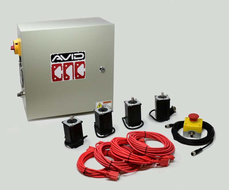

Someone mentioned Avid so I spent a while on their site. It is actually a good example of what prompts me to post this question in the first place.
I looked at the Avid 48x96, which should be very comparable to what lowriders are capable of size-wise. What makes this machine cost $19,000??? It has Nema 34 motors, but you can find those for under $50 each online so that is what $250. It has all the channel aluminum frame, but there is no way that is more than what $3,000, so the only thing I can see that makes it worth the value is the control system. They have what looks like a pretty slick plug and play control system. What is really in that box?? Is it worth $15,000???
My point is there is a TON of knowledge in this crew. Can a design be put together where a budget of a couple thousand dollars that can actually compete with a $20,000 machine? You see it all the time on youTube videos where someone compares some $100 tool to a $10,000 tool and the $100 version does just as good. It could be a great ‘challenge’ on here to develop the next level or lowriders big brother. The challenge should require that the parts are built using a Lowrider and as many wood components as possible to keep cost down.
I am sure Avid has put a lot of engineering and make a great machine, but I feel like there is a good chance Avid is selling a LOT of blue sky at the same time.
The $19,000 pays for non-recurring engineering. The parts aren’t the cost, it is the design choosing and testing the parts. The development of the software, electrical and mechanical engineering. Because that is expensive labor and it is split over each kit, but they are custom (or nearly) kits. There aren’t many kits to divide it out. There is more engineering that goes into a samsung TV. But they sell millions of TVs and tens of thousands (I’m guessing) avid CNCs.
You also get support for that money. If your business is using that $20k machine to make parts for customers and they have deadlines, you are also paying to have avid on the phone if your machine isn’t working. Those smart people available all the time cost money.
You won’t find $15k in that controller. At least not without considering NRE. That said, you can’t develop one controller from scratch for $15k. Not even the grbl software would cost that.

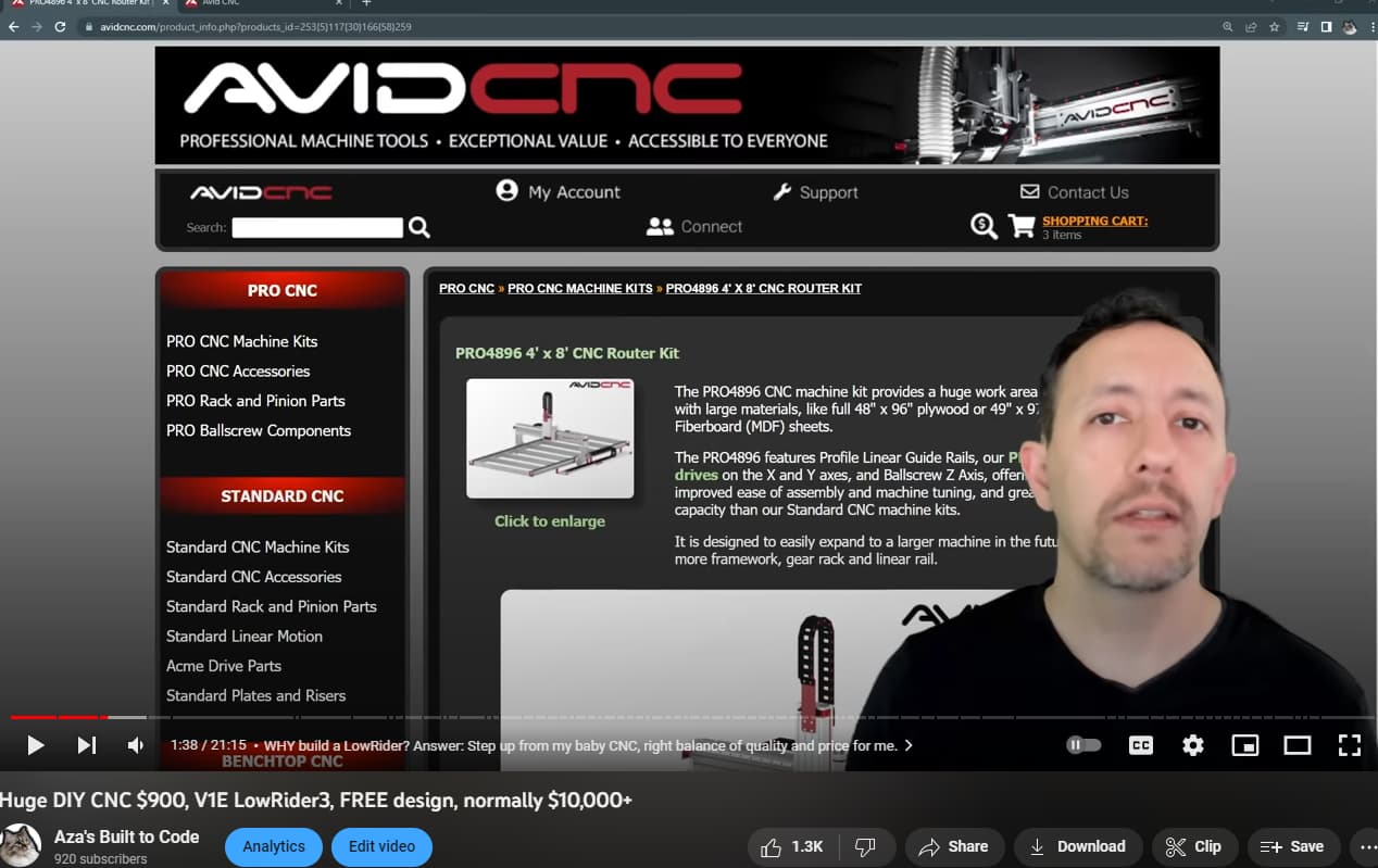

I know right, have you seen this joker comparing LR3 to an AVID CNC… This dude is a bit misleading, he mentions cuts being slower, but doesn’t acknowledge the beefier hardware, engineering costs and nice metal controller box that AVID has. Guy’s obviously just a hobbyist/DIYer.
