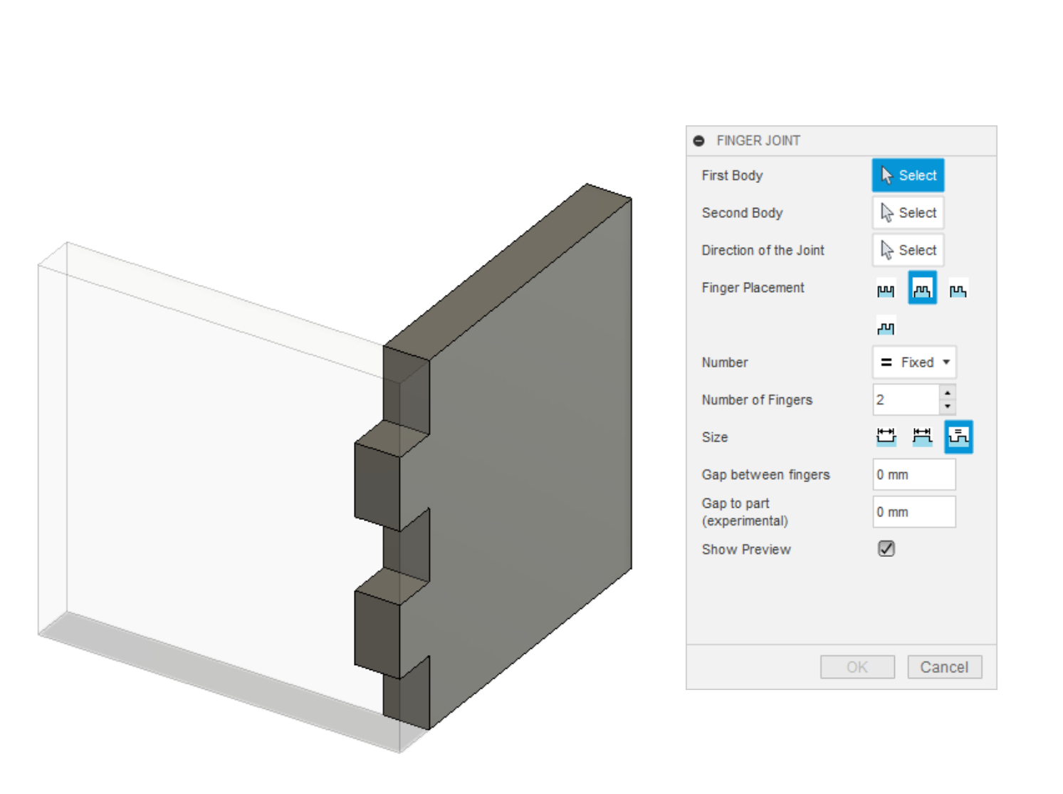

The Fusion 360 Add-In (not ‘extension’ in Fusion 360: I mispoke!) is the one here:
Here’s a 1-minute sample use for two boards/components that are drawn first as overlapping.
Trigger the add-in, select the 2 components and their joint line, and you’re good to go.
The instructions for installation are on that GitHub page if you scroll down, along with usage instructions.
Once the script is installed, you can use the Fusion ‘s’/search tool to find the new ‘FingerJoint’ command, which gets you to the screen shot above.
