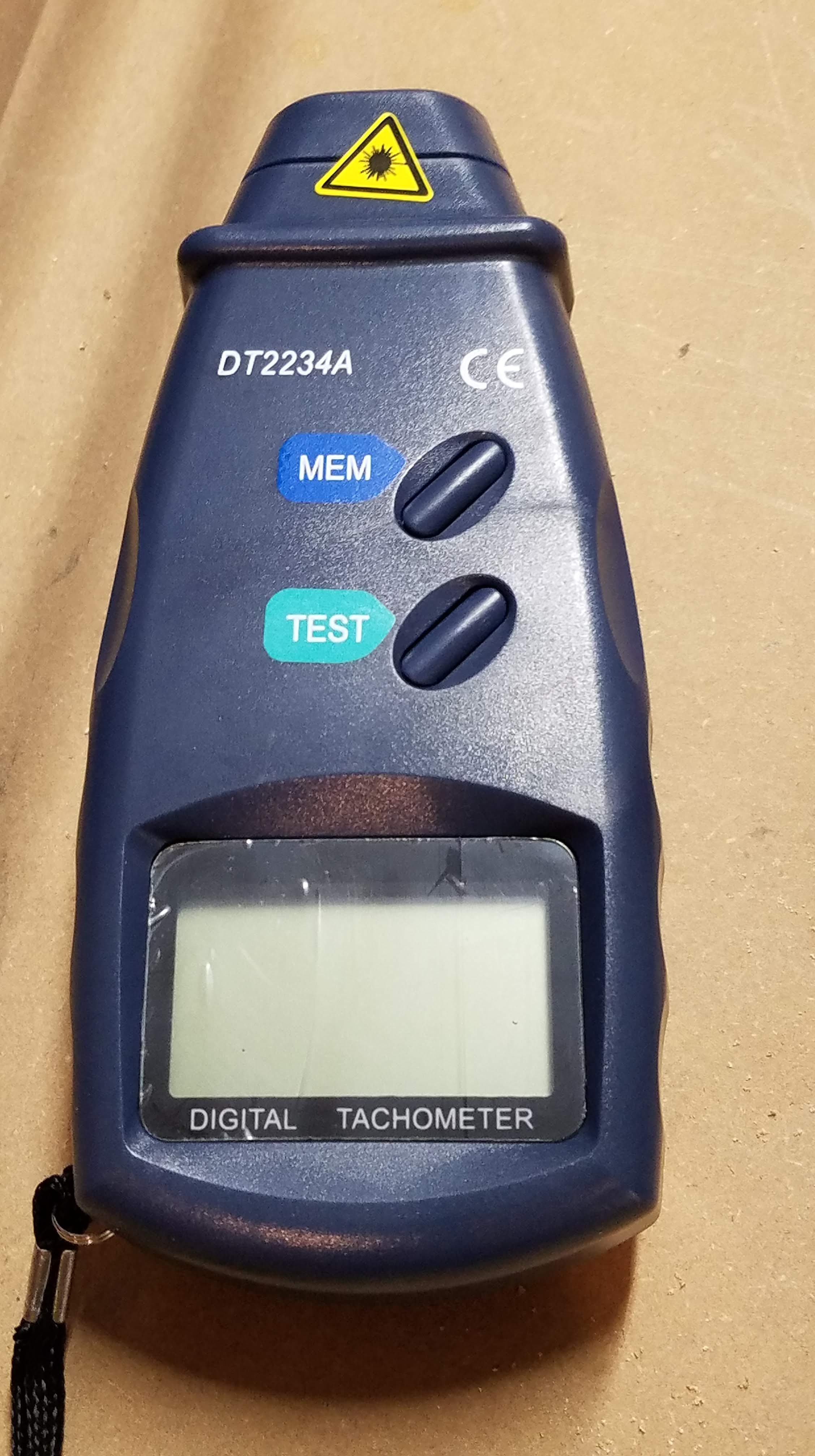

Just turn the dial to adjust the desired speed. So how do you know what the speed is? For that you’ll need a tachometer, which I bought just for the occasion. [attachment file=69050]

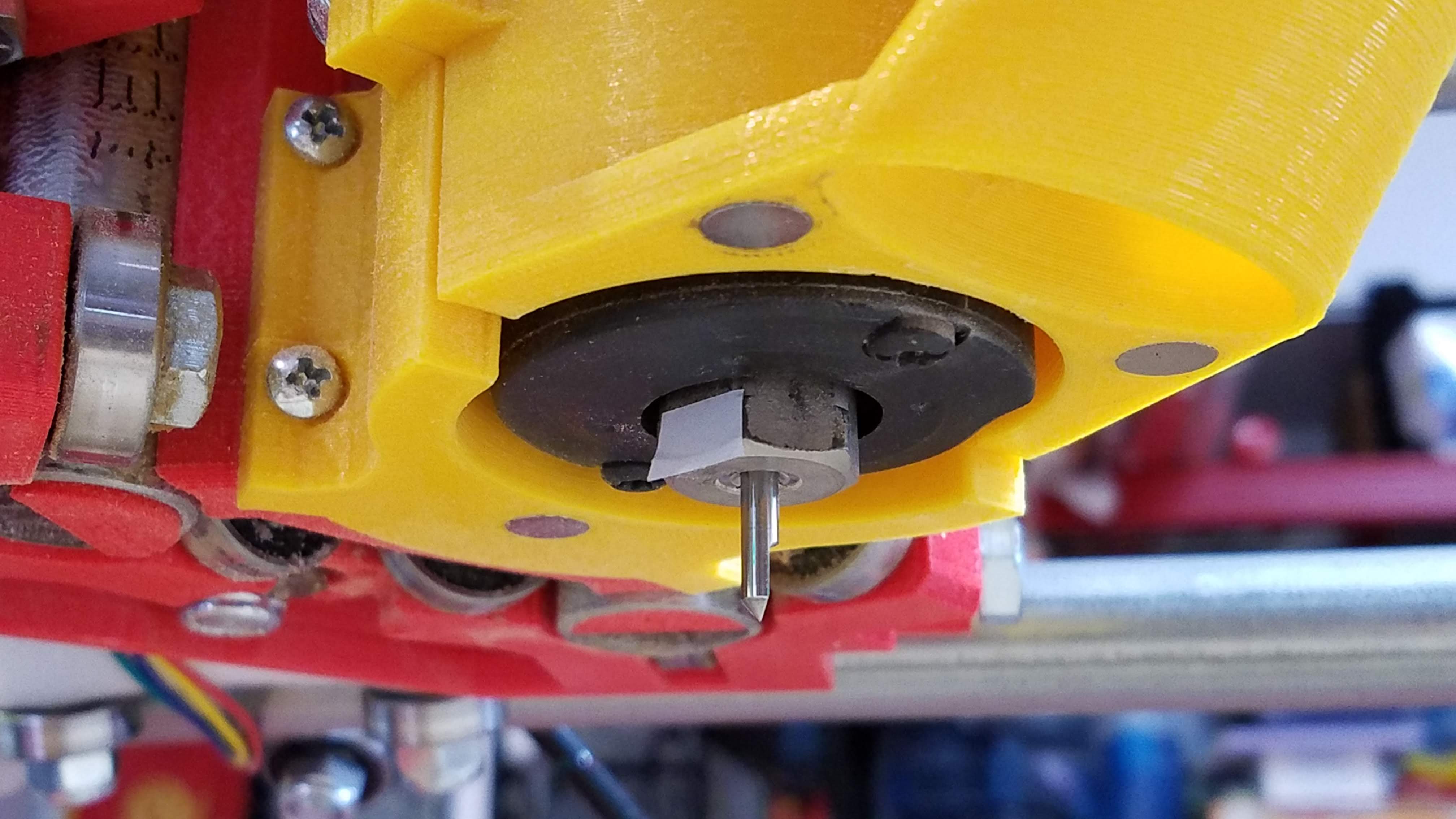

Then you put a little piece of reflective tape on the spindle and measure the speed.[attachment file=69049]
My results (with the controller in variable) were approximately:
Full power 27700 RPM
Turned all the way down 17000 RPM
Top of the Black Marking 19000 RPM
Top of the Green 21000 RPM
You can see in the picture where I penciled in the RPMS. I’m using very low end tools (controller and tachometer) , so who knows how close your results will be with mine. All in all, the Harbor Freight Speed Controller is easy to use, gets the job done, and cost $15 (with 25% coupon). I do wish it would turn down the RPMs even more, but I can’t really argue too much with my initial successes using this controller.
