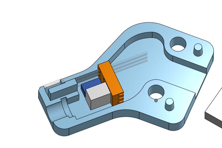

HALL Switch Endstops LR4
Would work for Jackpot V1, not for Jackpot V3 (No 5V unpopulated through holes on that board)
There’s always the expansion connector as a place to pick off 5V or to host any required circuits. Maybe even as ugly as a ribbon cable to the endstop headers and then a header on an expansion module.
The data sheet indicates the capacitor is for “power stabilization” and “noise immunity”. Generally, you would want to place this as close to the device as practical. However, the pull-up resistor should be okay mounted remotely.
hahah very glad someone else has this pet peave. Most of the time youtube woodworkers etc say “over engineered” it means overbuilt because I didn’t know how to engineer it.
edit: didn’t see Cortex already said this.
I think it may be important to have the capacitor near the sensor. That capacitor is to keep the 5v DC power stable. I’m not sure how sensitive that part is to a noisy power source or how much the wire from the board to the sensor would pick up interference so I think it’s safer to keep the cap close. I also liked Sam’s idea to have an led on the package. Having the led and all the other components in the package makes it easy to test the sensor without installing it and connecting it to the board. So I’ve added a place for a 3mm led to my little box thing.
LED shown in the video I linked may be what Sam was responding to. Regarding that, in the “FWIW” category, several days ago I asked Gemini AI for advice / blueprint help on a possible PCB design regarding the use of hall effect sensor for endstop switch, with adding bi-color LED (one color for operational, another color for when triggered) and the following was its advice/reply:
The reason I finally posted this is because it mentioned resisters for the LEDs. If this, 1kΩ Resistor per LED, is a legit need, then consider it regarding the plans.
See AI Gemini indicating resister needed per LED

I bought this endstop hall switch and it came with three wire to my LR4
Brown- +
Black-300mA
Blue - -
do recall on the video I watched and it recommends you connect the 24VDC voltage in combination with signal to the jackpot 3 board . Any advice with be high appreciated
https://www.youtube.com/watch?v=bZR_FiOQn9A 9:00 mins mark of the video
purchased LJ12A3-4-Z-AX
I just do not want to damage my Jackpot 3 by doing some stupid .
Great work Sam. Any updates? Have any of your designs been shared?
David, how did you get on with your Hall switch holder? Are they working for you? Anyone else?
I printed them, wired them, and tested them on a breadboard but haven’t had the time to install them on my machine. I’ll try to post the stl files tonight.
