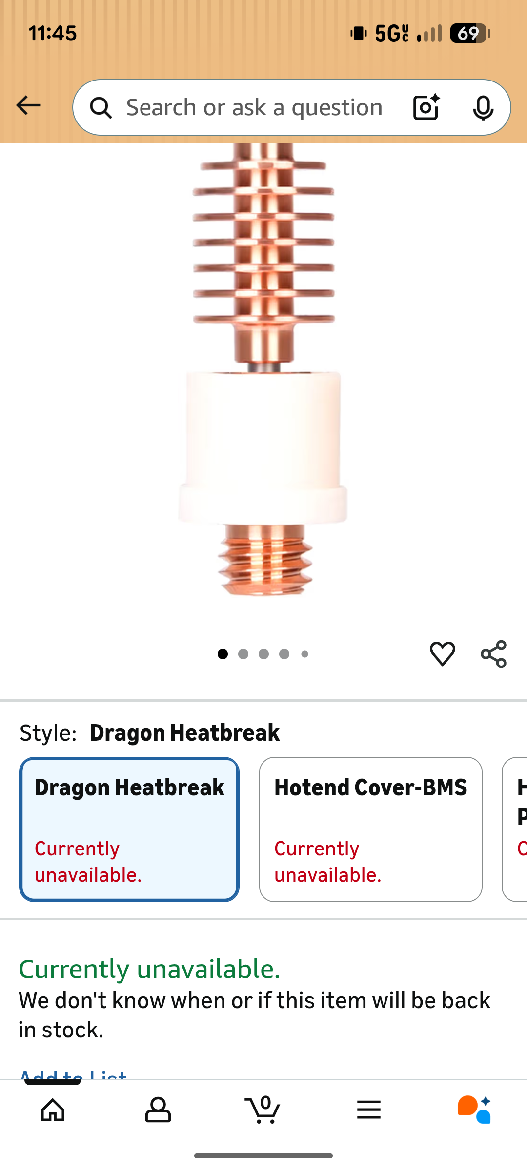

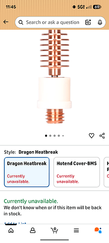

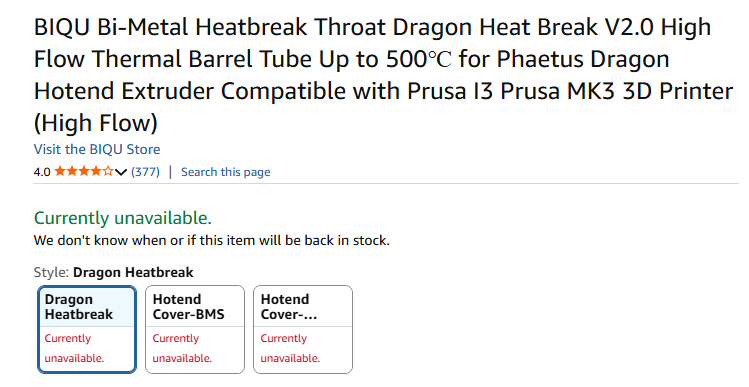

The issue is swapping the heat break. I have not yet found one for the lite. The link given is out of stock.
From what I remember yes. But I could be mistaken. Its been a few years since I did the upgrade.

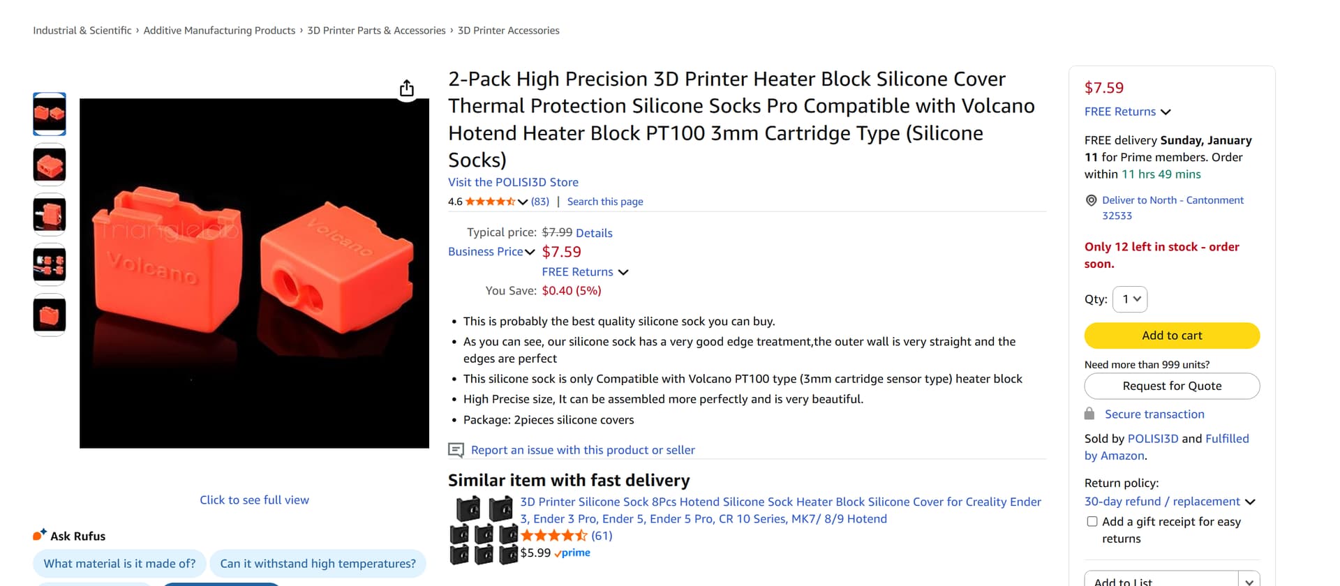

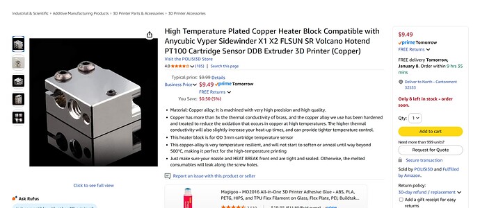

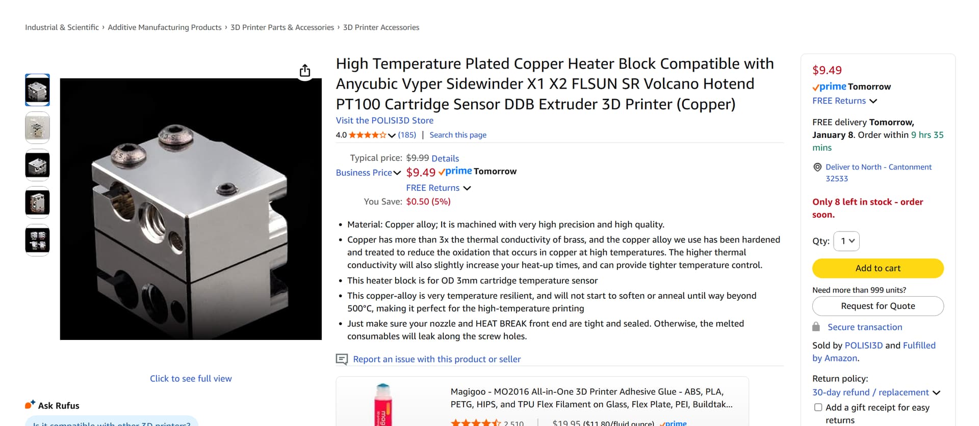

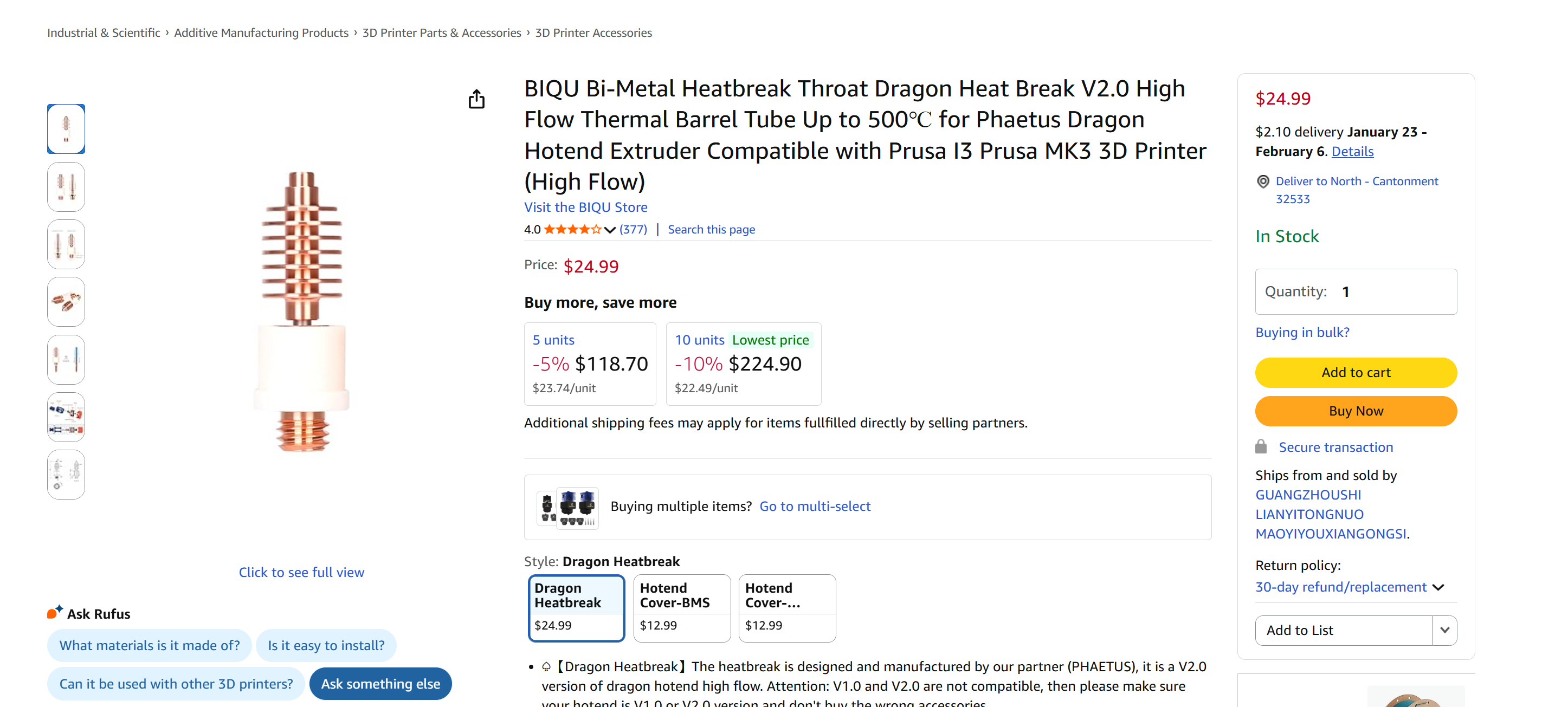

All 3 of the links show in stock for me???
This is what i see
That makes no sense…
I clicked the links one by one and took screen shots. Why are they showing available for me but not for either of yall???
You’ll have to ask GUANGZHOUSHILIANYITONGNUOHAOYYOUXIANGONGSL why he won’t ship it to us…
I just had @CarmenJ check and she can get everything but the adapter on our “normal” amazon. IDK why its different on my business amazon account. :poop: makes no sense
