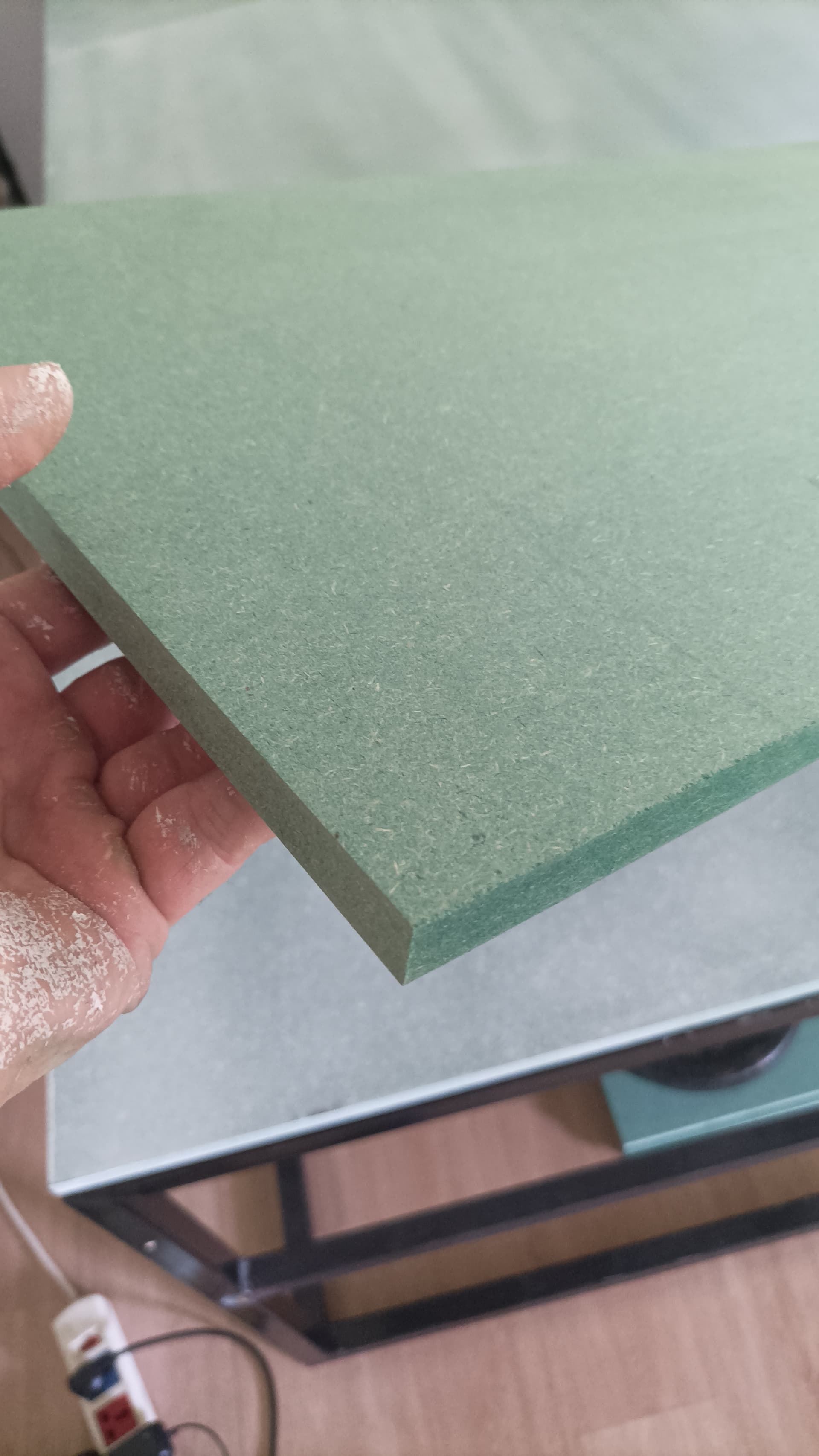

Interestingly, I discovered MDF is a bit of a no-go here due to humidity - it’s sold, but warps and moulds very quickly. Instead HMR board is used, which is a high moisture resistance form of MDF treated with some kind of special glue resulting in a unique green color.
So humidity is definitely an issue to deal with, but I think there are ways around it, I just need to figure them out as they come up.

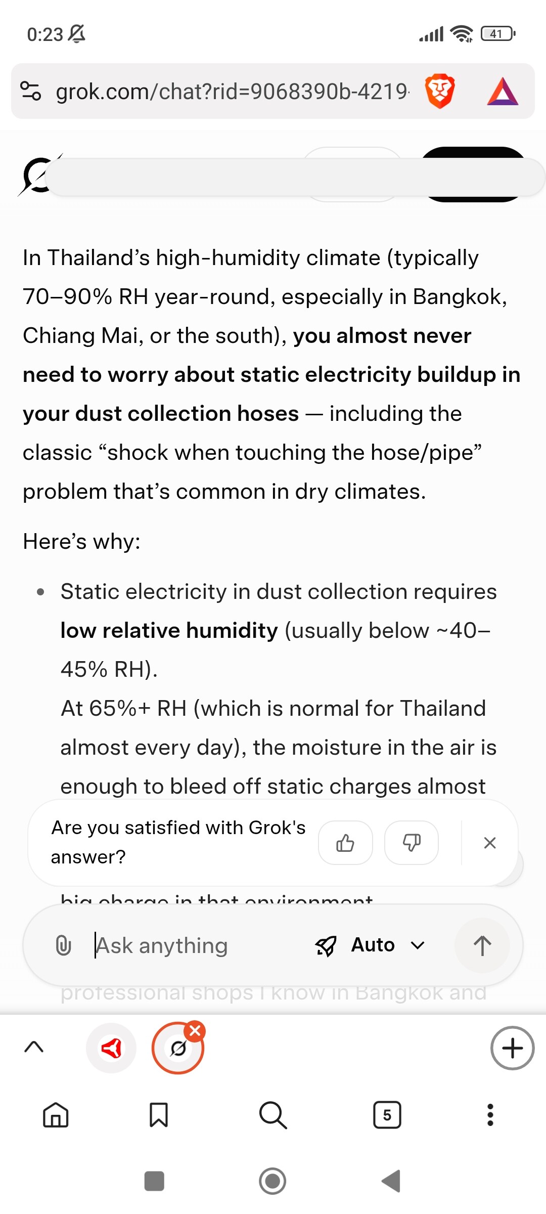

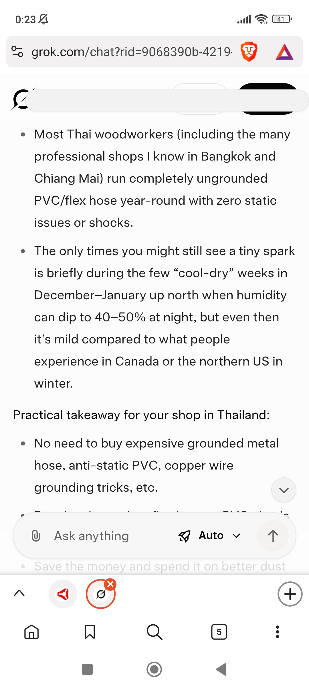

I think I might be ok actually, not sure how accurate AI is but seems that high humidity might remove the need for grounding the dust hose altogether? Great news if so.
We have options for if you do have static issues, but at 60-70% RH, the air itself will act as a (crappy) ground wire. For now, I’d just pick an end of the dust hose where it is convienent to attach a wire and leave that exposed for later use, if you need it.

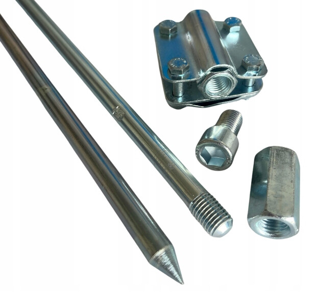

There are special grounding bolts you can buy in electric shops. IIRC they go as 2m pieces, and you use 2 or 3 and you just use impact drill to put them in the ground (deeper better of course). Then you have proper ground and you can even connect your home electric box to it, and feel safer :wink:
I’ll try to find some links in a sec.
EDIT:
I’ve found photo:
EDIT 2:
(Disclaimer: if you want to connect your home to it, it has to be very deep (few meters) and installed by proper electrician! (who will actually tell you how deep it has to be in your region)
Cheers, if I can find a competent electrician then I might get the house grounded if it’s not too difficult.
