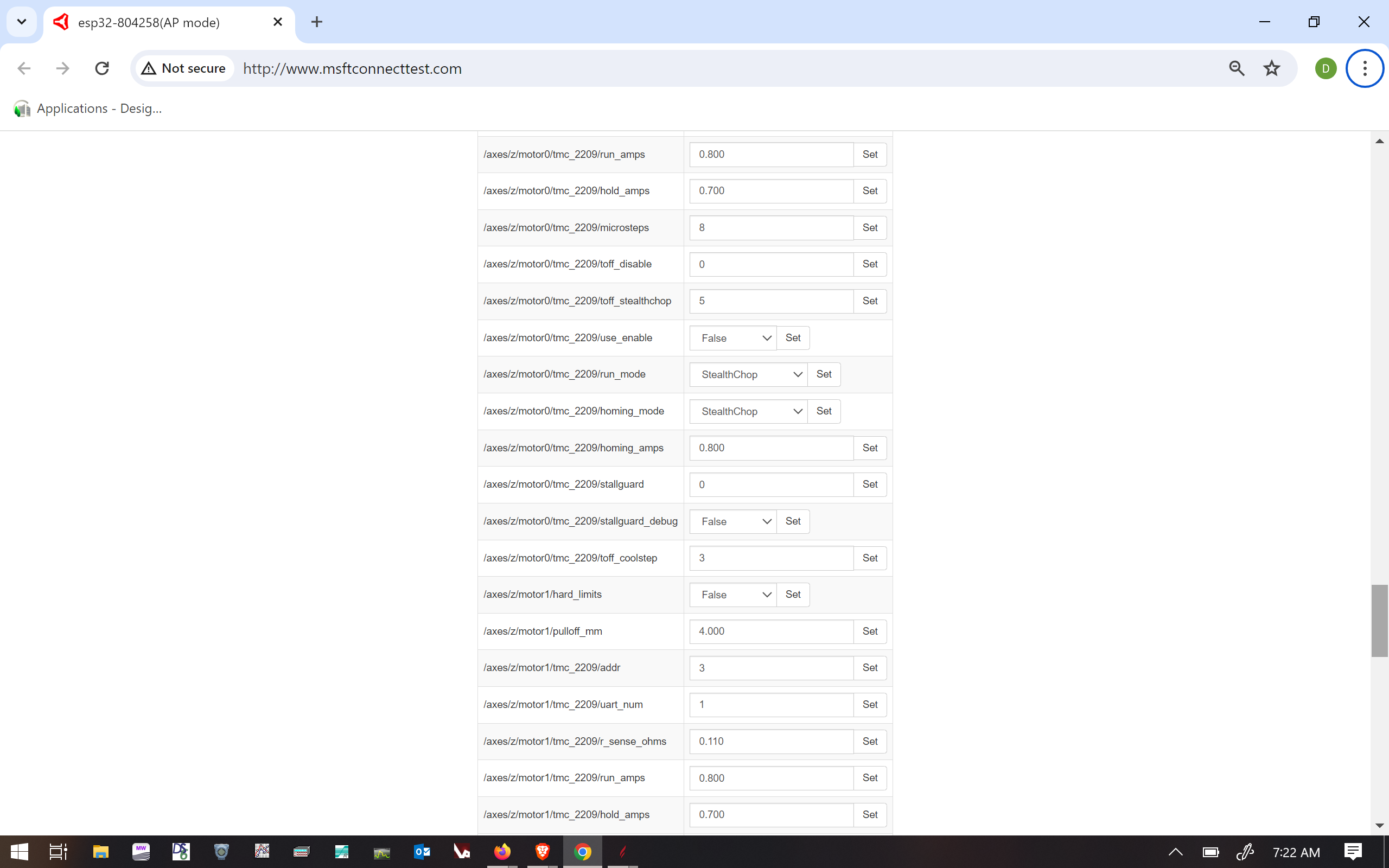

First of all: can you show us your Run_amps part of your z axis in the config. Yaml?
I will probably do that after I find out what is going on, for now I have the vac turned off and hose disconnected and I’m still dropping z.

Do you see anything in the FluidNC terminal window when this is happening? We may want to see that, or better still have FluidTerm running while you’re testing so we can see any log / error messages.
I did not think of that, but this afternoon when I run it again I will watch it, and save the log.
