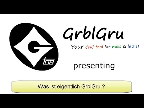

I am just reviving this, because he has been working on the program and it looks really, really good. The video‘s subtitles are German, but you can still see what kind of features he has:
It also runs with FluidNC, so it might be an alternative to Estlcam? I really like the 3D animation of the CNC before the cuts and I really dig the idea of doing lathe stuff like JeffH has done above. I have a spare motor lying around that I haven‘t got around to making into a lathe Addon for the LR… it‘s been lying there for years… Argh.
