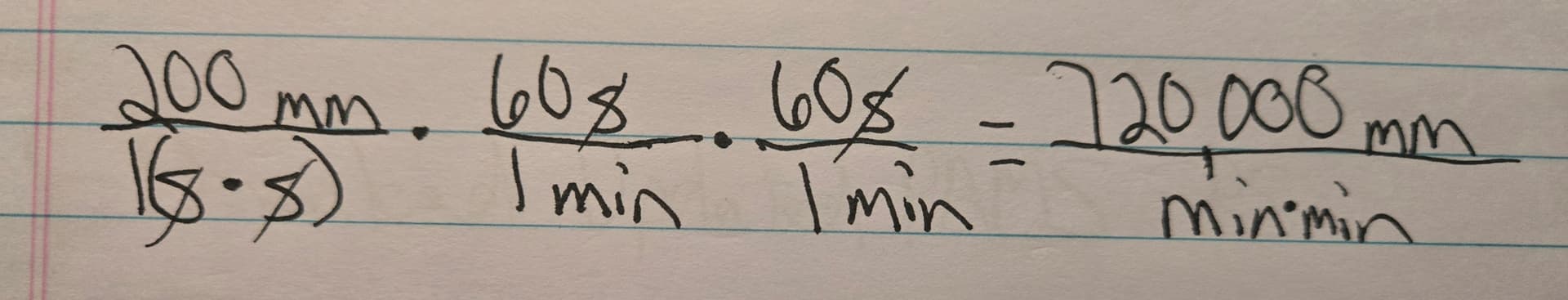

In the meantime, I’m trying to figure out the fluidNC units for accel. The default in my config.yaml is 200 mm/sec^2. The Copilot generated code specifies it wants mm/min^2 and its example uses 300 mm/min^2. I think 200mm/sec^2 converts to 720,000 mm/min^2. Seems kind of big. Maybe it’s a typo by Copilot?
That checks out.
