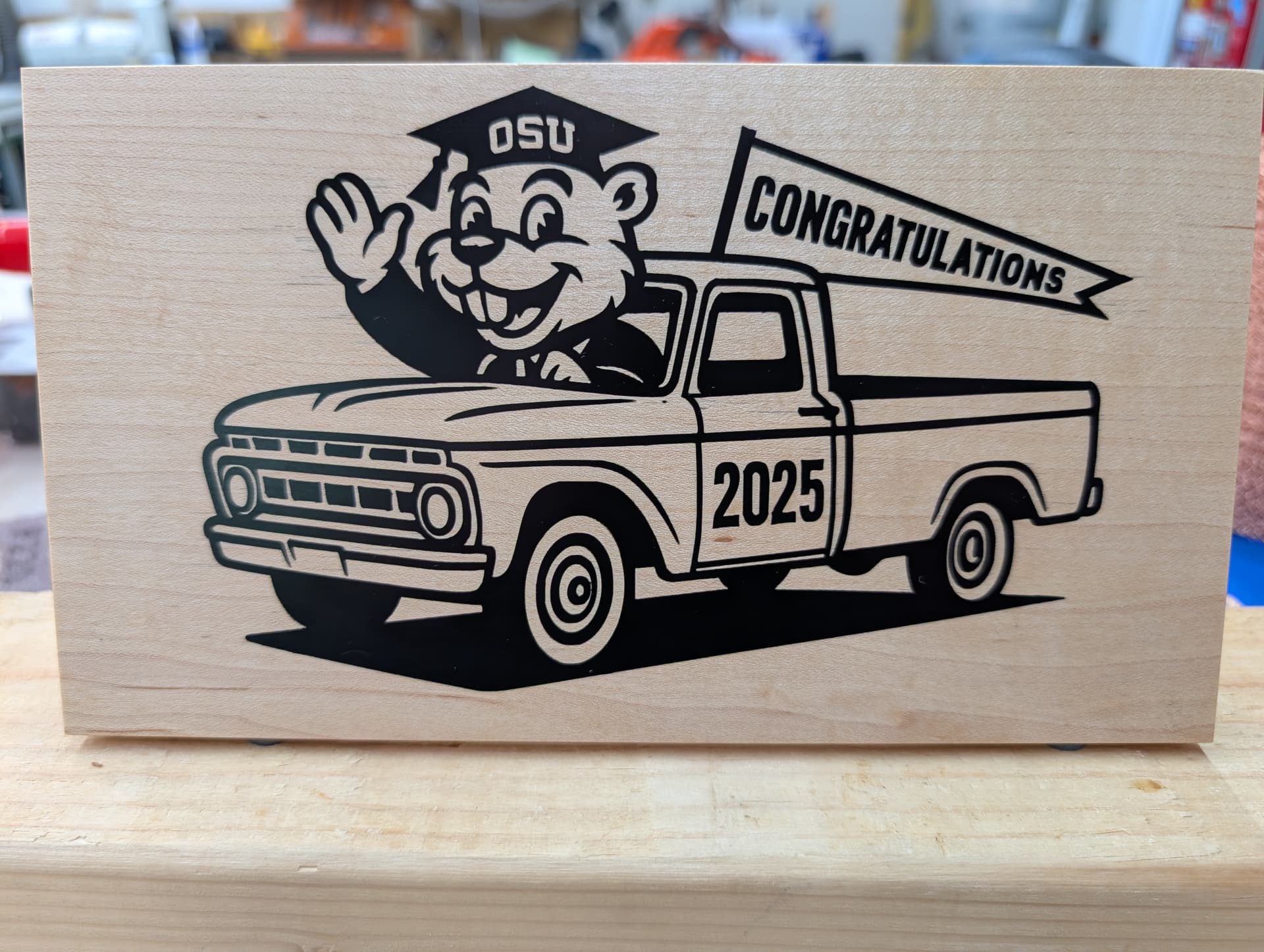

A quick little graduation plaque, v-carved and then epoxy filled, came out pretty nice :slight_smile:
The recipient has an old truck hence AI generated Benny the Beaver driving an old truck.

Could you describe a bit more your epoxy method? You make it sound so easy :rofl:.
Is it carve out at set depth (how deep do you find is effective?) then pour in the black epoxy and sand any over splash?
The pocket for the epoxy in this case was about 1.5mm deep, it’s a standard vcarve toolpath done using VCarve Desktop, and a 30 degree bit. So wider lines the bit plunges in more and finer lines are more shallow, there is also a flat area in the really wide bits that are cleared using an 1/8" bit.
After carving coat with shellac to prevent the epoxy bleeding into the grain.
Circle carved image with a ring of hot glue
Pour in the epoxy, and let it cure, total depth is about 2-3mm at this step.
Remove the hot glue with some isopropyl alcohol, comes off really easily.
Clear the epoxy using a 1/4" end mill to just a tad above the surface of the wood.
Finish off by sanding, going through grits 150-400.
Final finish with Rubio.
The whole process took a couple of days :slight_smile:
I will say that the epoxy came out so flawless that it almost looked printed which kind of hid the effort that went into making it :slight_smile:

One last question: I assume you use VCarve just because that’s your CAM of choice. But why the vcarve tool? Would not a straight downcut end mill achieve the same conditions to pour the epoxy?
You can’t get the same level of detail if you just use a regular end mill, with a v bit your lines can be super thin, as just the very tip of the bit is cutting.
The hat is a good example, with just a straight end mill you couldn’t get those sharp points, they would be the same radius as the bit.
