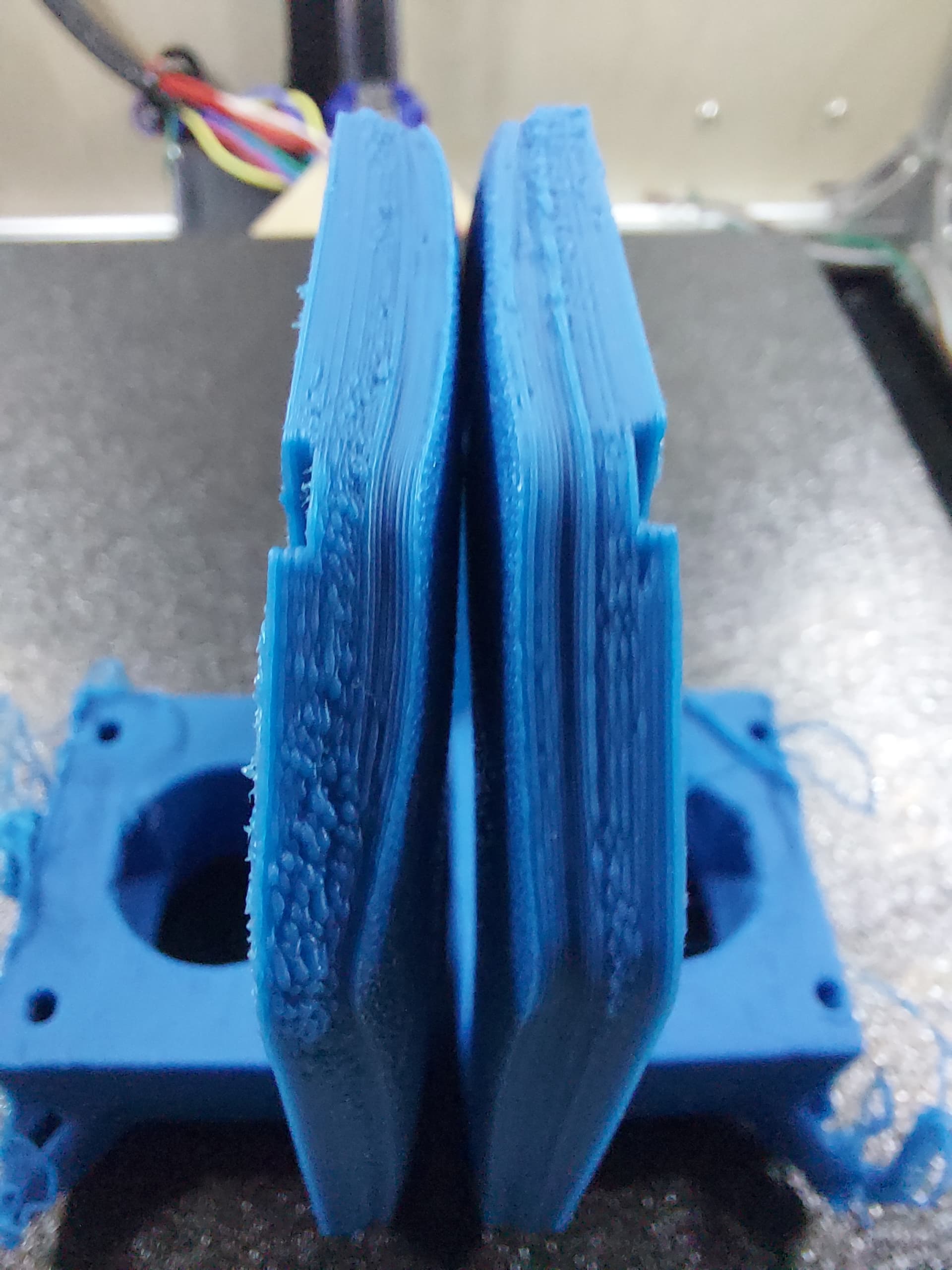

When people ask me why I do most of my printing with PETg and not PLA…
I have had perfectly reasonable prints with PLA, but this wasn’t one of them…
