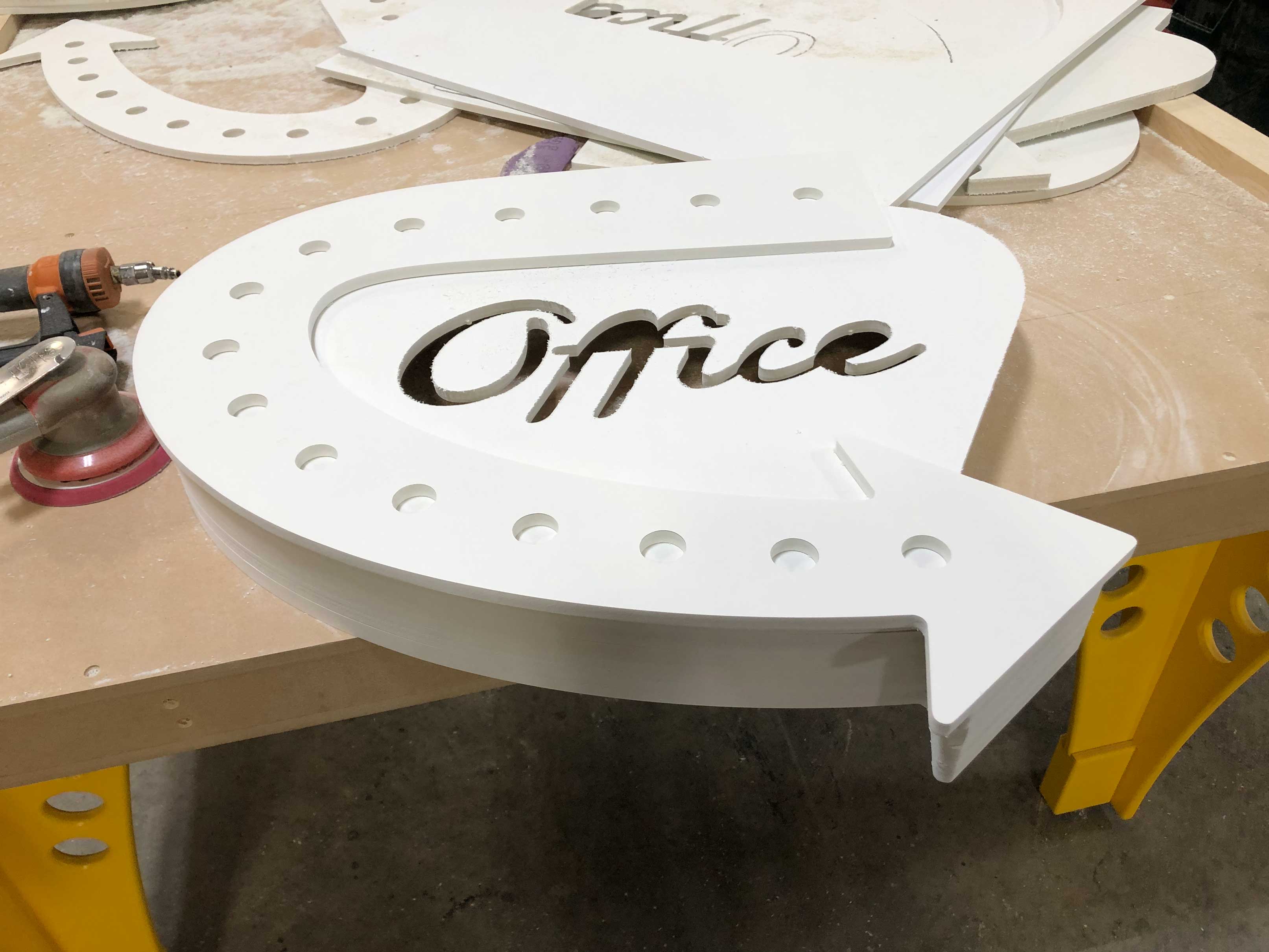

This was the first project I cut on the Lowrider. I needed something to cut while learning how to run it. It will hang in the new shop pointing to the office. It was inspired by Wesley Treat’s Googie sign. https://www.youtube.com/watch?v=OK8Eyxx9xz4&t=289s
[attachment file=108226]
[attachment file=108227]
The arrows are 3/8" pvc, the body is 4 layers of 5/8" pvc glued together. The body cover is 3/8" pvc on each side. So, about 4" thick overall, roughly 24" x 24"x4".
[attachment file=108228]
the Lowrider will happily cut through 3/8" pvc in one pass using a 1/8" two flute bit.
I cut pieces of opaque acrylic to cover the letter openings and the arrow holes. Led strip salvaged from a retail store remodel was added around the body inside. Also, I used aluminum tape on the inside to help reflect the light.
[attachment file=108229]
Wow! That’s amazing! Clean but with a classic look.
That’s really impressive.
Is that your shop in the background? That’s a pretty large work space!
That is CLEAN!!!
Thank you for the kind words, I’m really proud of my shop and the people who have chosen to work with me. How I got here is a long story, just know that a lot of work was involved. Work I didn’t always get paid for. I’ve always had this thing where I get an idea and can’t rest till I’ve tried it, usually having no idea how it will apply to making money. But it seems to always work out. Time spent experimenting is time well spent in my book. What you see in that picture is maybe 1/5 of the shop. Presently I have 12,000 sq. ft. but we’re constructing a new location where I will have 22,000 ft. plus a 4,000 ft mezzanine. I turned 65 in December and it seemed like a good time to expand!
