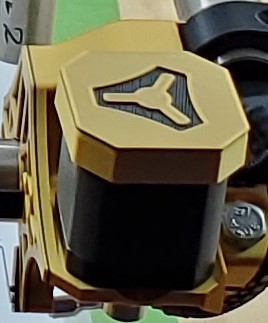

Btw: Do you have an STL for those stepper caps? They look neat. :slight_smile:

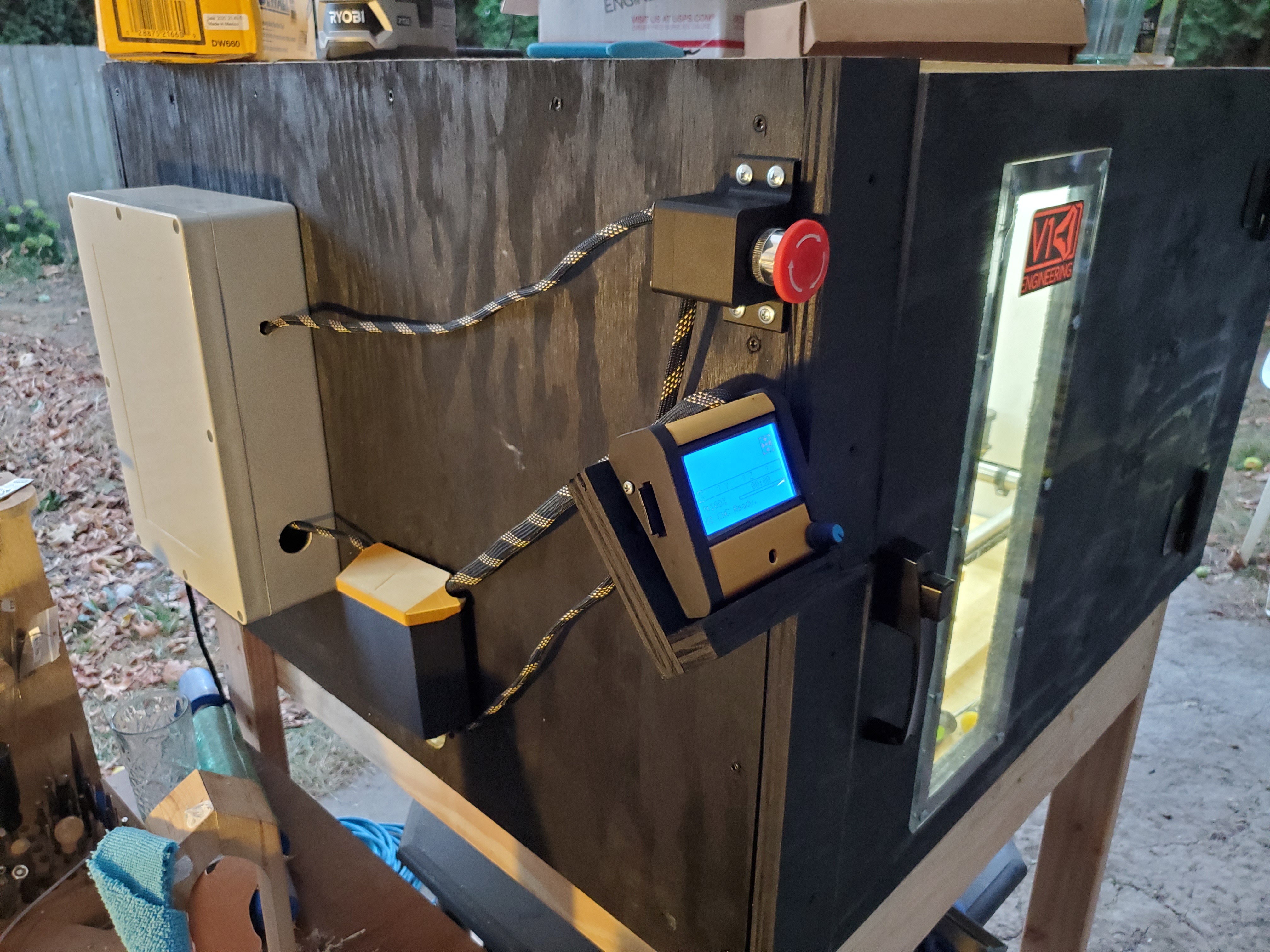

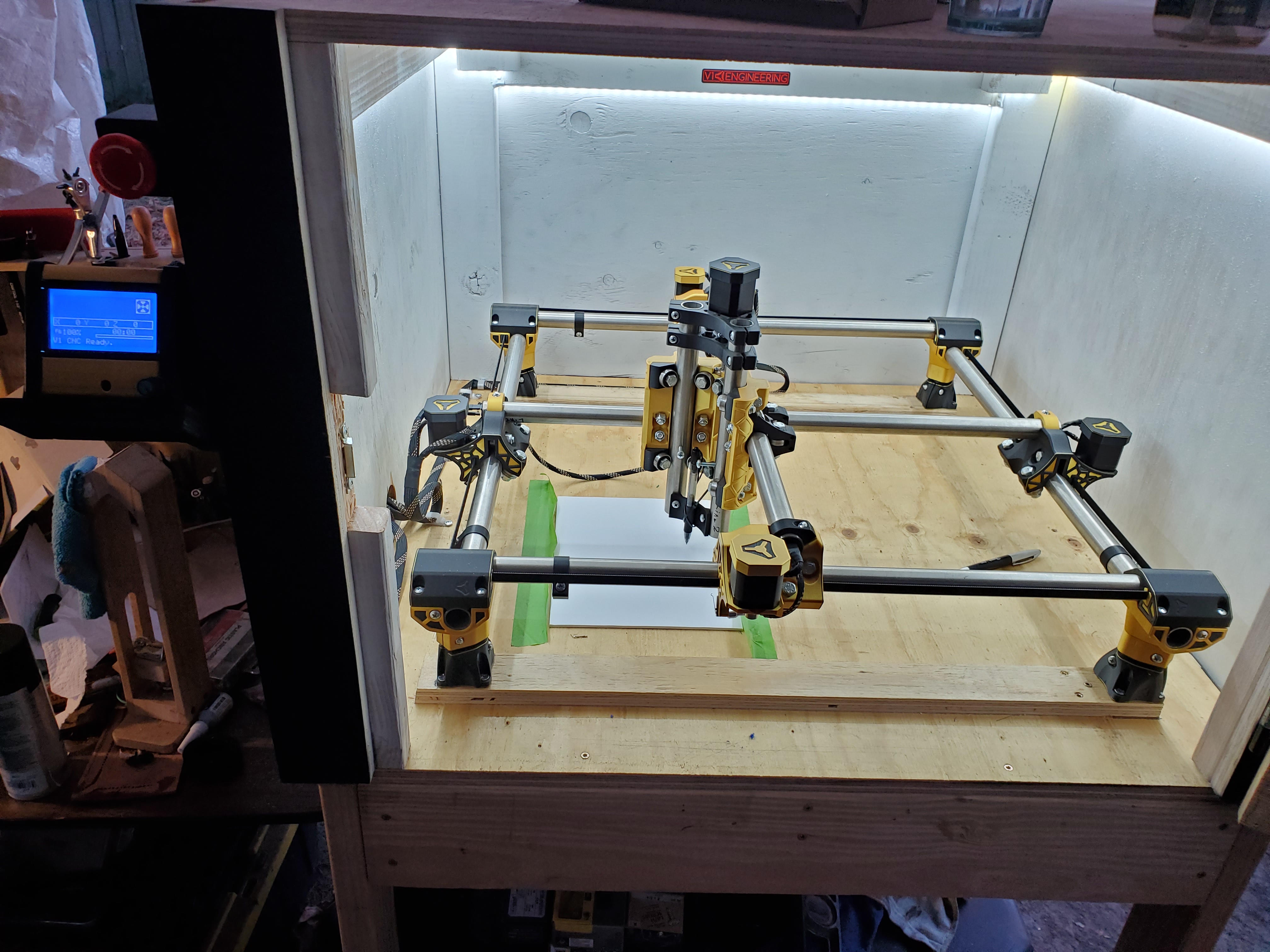

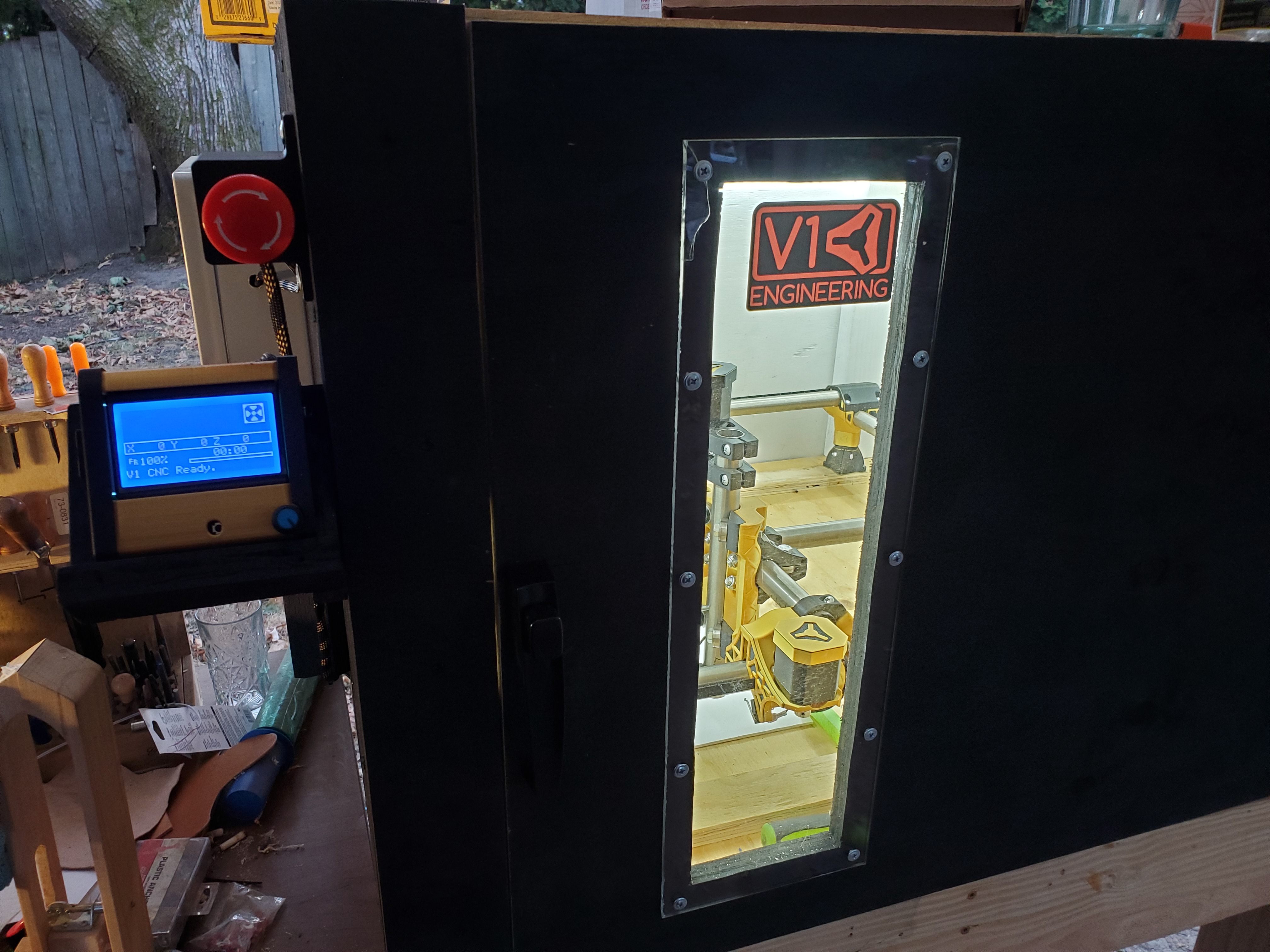

Success! Wire management is complete aside from the router cable. I think I mentioned before that I’m going to play with the pen for a bit get used to setting my paths.
I’m also not entirely sure how I want to manage the router and z cables but I’m sure I will figure it out when I get to it.
Thanks for the advice! I redid all the wiring for the Y. I tried to make sure everything was as clean as I could get it. Hooked everything back up and all is running well! :grin:

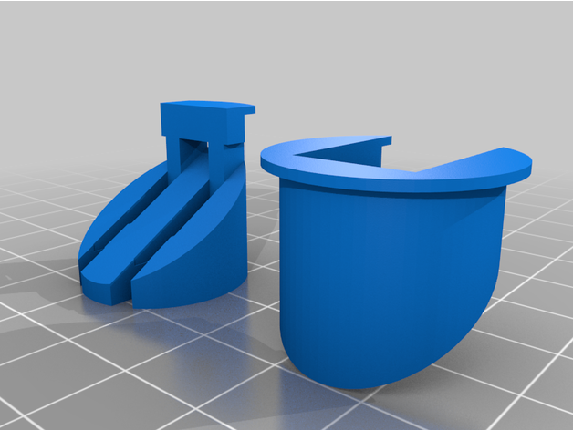

This is the Dupont one I created
And here is a blank for anyone who may want to modify it for there needs.
Thingiverse is being kind of weird right now so let me know if you have any issues with the links.
Sorry I didn’t respond sooner I was focusing on the build.
Thanks for the caps, but I meant the other caps. Those:
20200823_195146
Oh! My apologies. Those are actually made by David Walling[niget2002]
This is his thingiverse post

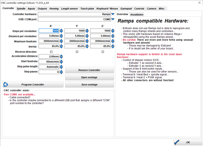

Alright so I finally have a laptop that is dedicated to this machine. So my next quest is to start controlling it with the laptop. I like the idea of how estlcam works but I’m running rambo so that’s a no go. Is there anything that functions similarly to estlcam that is compatible with rambo.

You can control it using repetier host or cncjs from a laptop. Not every function from estlcam is available, but you can do just about everything. There is some more details in the software workflow doc.

If the estlcam firmware was open source, then maybe. But it is closed source, precompiled binaries for specific hardware and the rambo uses different pinouts and has digipots for the driver config, at least.
