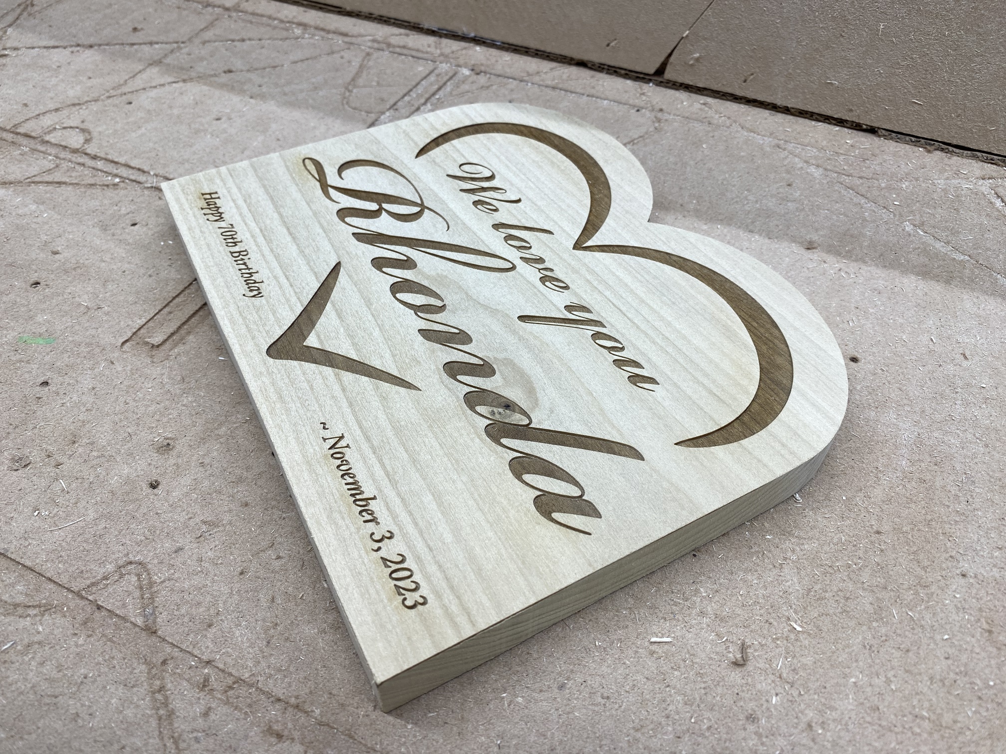

Early this morning I made this from a slab of Maple hardwood using a combination of my 100-watt CO2 laser (for the engraving) and my beefed-up 1.5HP bandsaw (for the outer profile shape cutting). The design is my own work.

Looks great. I’m always amazed by the fact these lasers provide so much visual depth
Very nice Doug.
This was done at a speed of 300 mm/sec running at a power rating of 70%. One pass.
A 100W CO2 laser, at least mine, can cut through 1/4” thick of hardwood, I’m talking Red Oak, in a single pass. It’s a workhorse for me.
