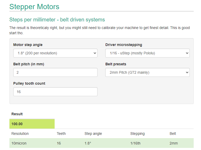

I spent the vast majority of the evening configuring FluidNC on my TinyBee, and , while I think I got everything working (dual endstops and such…) I’m getting super-weird values for the steps_per_mm params
axes:
  x:
    steps_per_mm: 98
  y:
    steps_per_mm: 62
  z:
    steps_per_mm: 3200.000
Z is ok, because I’m using a 1mm pitch lead screw, so the value is quite high, and on par with the calulator (Stepper Motors Calculator)
For X and Y, I’m a bit at loss here…
The calculator for 16teeth and GT2 belt says 100steps per mm, but this setting makes the machine overshoot quite a bit…
Adjusting the value by trial and error, I’m getting 98 for X (not bad…) and 62 for y (ugh?)
And why on earth would I get a different steps_per_mm value between x and y?

Messing up the microsteps settings would be off by 2x or 0.5x, at least.
A 20T pulley (they could have given you the wrong one) would be 80 steps/mm. So that looks closest.
If you had one motor on 1/8th and one on 1/16th, then you could get 68 steps/mm. Make sure you are making very large squares.
I am skeptical of the 98 too. How are you measuring it? Share some photos of your build. Make sure your grub screws are tight and the belt is staying in the track (not riding up onto the rim of the pulley).
