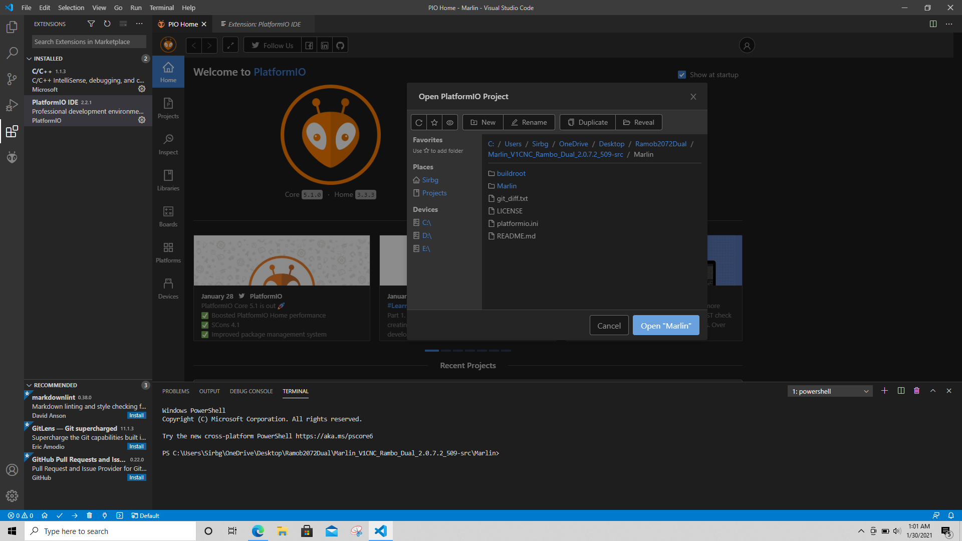

I have followed all the steps to build the firmware in the instructions and it always fails what am I doing wrong

open the configuration.h file in the marlin directory, then compile?
Make sure the power is plugged in rambo board, make sure there’s no other programs scanning the com ports like if you have arduinos or something like it plugged into your computer for something.
This error looks like you are compiling it with vscodes regular tools. It needs to be opened from the platformio tools as a project and built with the platformio compiler.
The instructions say to plug the board in the next step after building the firmware
jeff is right. You need to pick open project then go to the folder you downloaded the firmware, open the v1cnc marlin file in there, open that folder, open the marlin folder, then pick open marlin.
It looks like this on my computer
Once you do that it should open into a workspace, look at my last posts picture. Then you can compile it.

Here in the platformio Home tab under quick access Open Project

everytime i click open marlin in platformio it does nothing, platformio just disappears
You’re looking for “open project”. It is in the screenshot Jeff shared. On the right side.
I got that part and had the file just like in his post and clicked open marlin and platformio just closed
This is all I get after clicking open marlin, the screen disappears and nothing happens
If I click platformio build I just get the error again
3 days now and over and over have followed the instructions @Ryan has posted and every time it fails, it don’t even load the folder anymore it seems it just appears in the list I have even uninstalled and reinstalled and it still shows up surely there is a better solution then VSC
