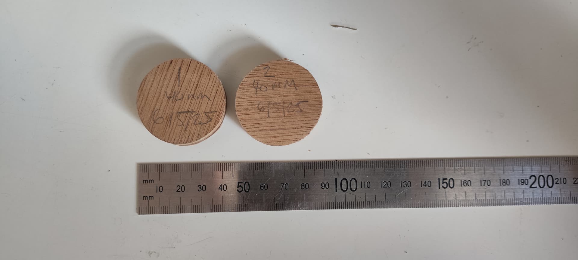

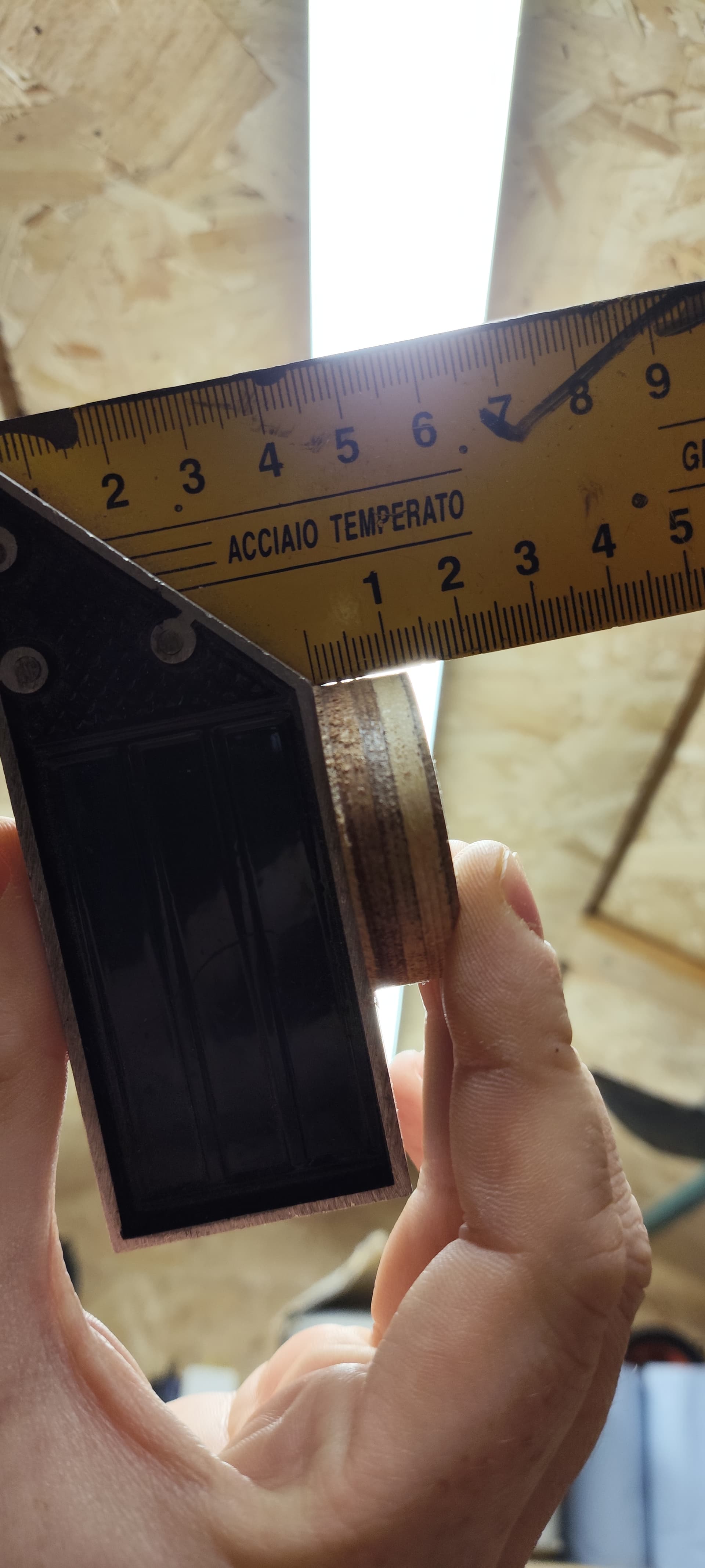

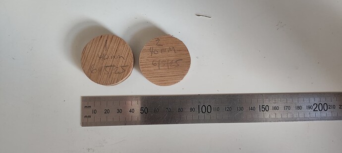

As a test, I’ve been cutting 40mm circles in 12mm ply with a 3mm endmill, and they’re pretty good dimensionally, but I’ve noticed they aren’t quite true circles, which is going to be an issue.

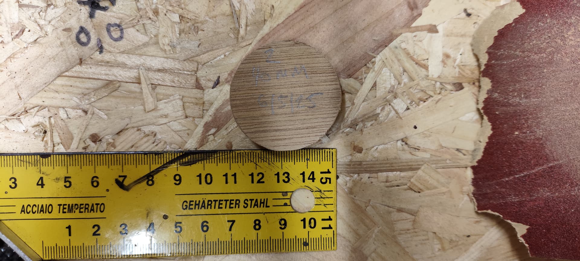

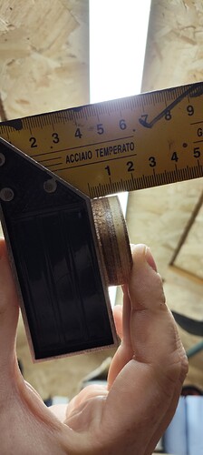

I also noticed that the cuts seem to draft inwards towards the bottom a few degrees, even though in my CAM setup I’ve set cuts to 90º.
I havent fitted my X strut plates yet or my permanent XZ plates, so this could probably account for some of it. This will come soon, but accuracy is important for this too so it’s important to minimise any problems where possible.

I wouldn’t consider doing anything until you have aluminium plates and strut plates installed.
It will probably happen this week. But I will need a certain level of accuracy to get these made up.
I expect you’re right, but would you mind explaining why?
And, assuming these parts were fitted, what would I be looking at adjusting to help rectify the issues I raised above?
Because both of those are essential to preventing twisting or deformation under load, I.e. they add rigidity.

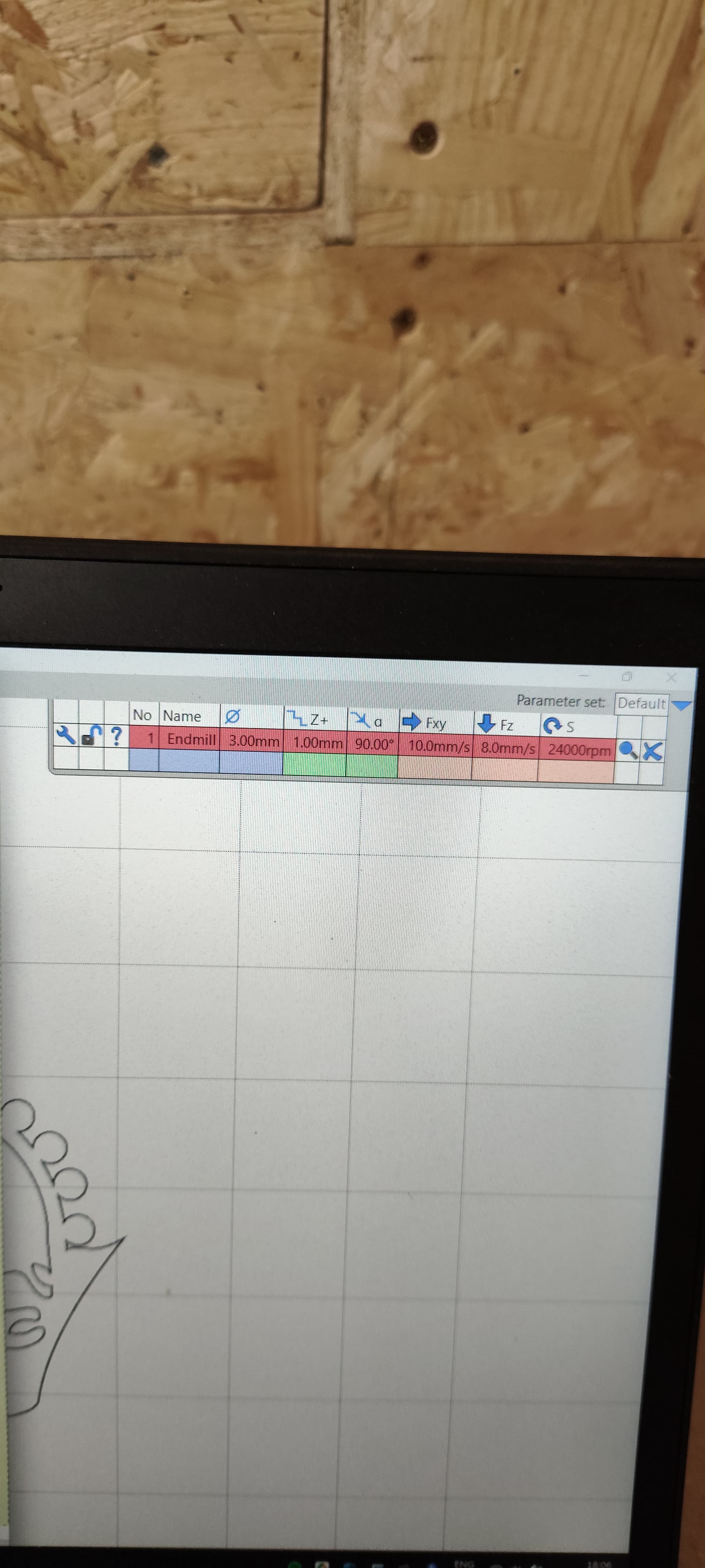

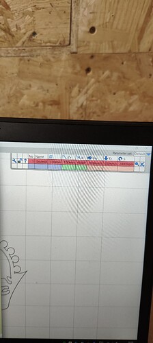

@maht , are you using a finishing pass? That would probably be the next thing after you add the plates.
finishing pass set to 0 in estlcam, which I think means it will do 5% of DOC setting.

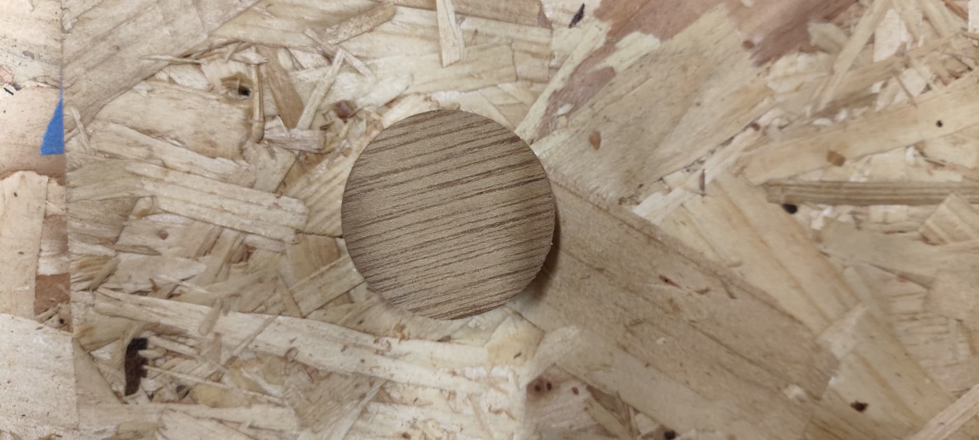

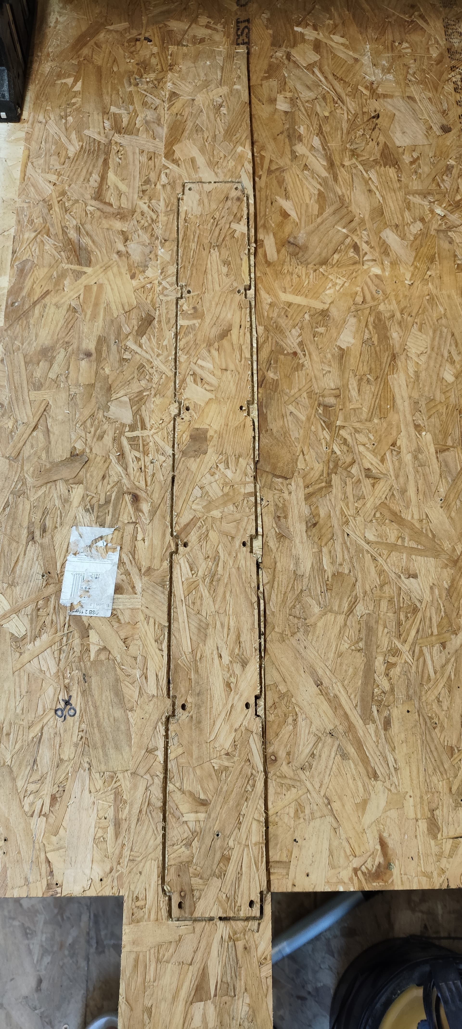

here’s a test cut strut plate I did on a scrap of OSB.
xy dimensions generally pretty accurate, but I notice the holes look very oval.
what should i be doing to stop holes being oval? im thinking belt tension. any other tips?
also i didnt set the DOC properly so its gone in 10mm instead of 12mm which was the actual thickness of the material on closer inspection. but i know how to solve that one.
according to docs I should be using stock around 6.35mm thickness for strut plates. closest suitable bit of MDF i have on hand is 5mm, which should be adequate.
Probably not belt tension unless they are so loose they’re floppy.
Have you tested motion (put down some blue tape, move out to around the machine limits with gcode move commands, and measure how far each move command moves.). Use a v bit to poke holes in the tape for measurement.
So for example if you move the machine 300mm in X and 300mm in Y, how much does it actually move. How repeatable is it?
Edit: Also, with the router off and the Z axis up in the air, push on the router bit and see if you have any significant slop in the machine when you push it +/- X and +/- Y.
I’d say the accuracy of the strut plates isn’t as important as you’re probably thinking – get them cut the best you can now and install them to stiffen up the machine. Cut new ones later if you need to.
