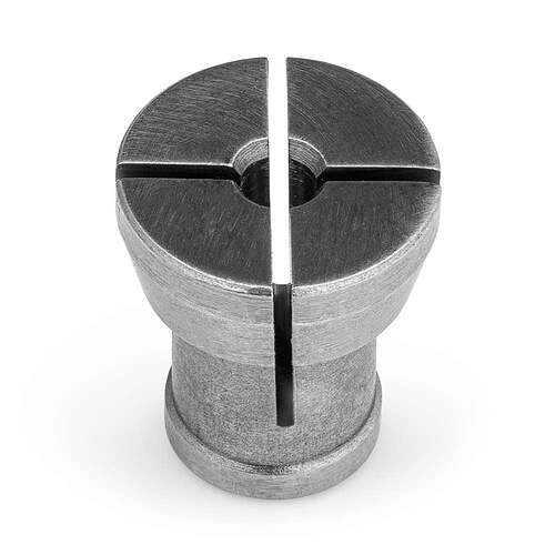

Hi Frosti,
what collet sizes do you have and what sizes do you need? A cheep option could be to use an adapter like Reduzierhülse 6 auf 3,175 mm.
I have a Makita and use the special collet for 3,175 mm and an adapter from 6 to 3 mm and do not see any difference in runout.

Thank you very much, I’ll try the adapter – it sounds good for the money! I need an adapter from 6mm to 3.175mm, and thid fits perfectly!
Plus, I can continue using the existing hardware – I was worried that the accuracy would suffer, so thanks for your input!
Should I order several of these at once, or do I only need one?

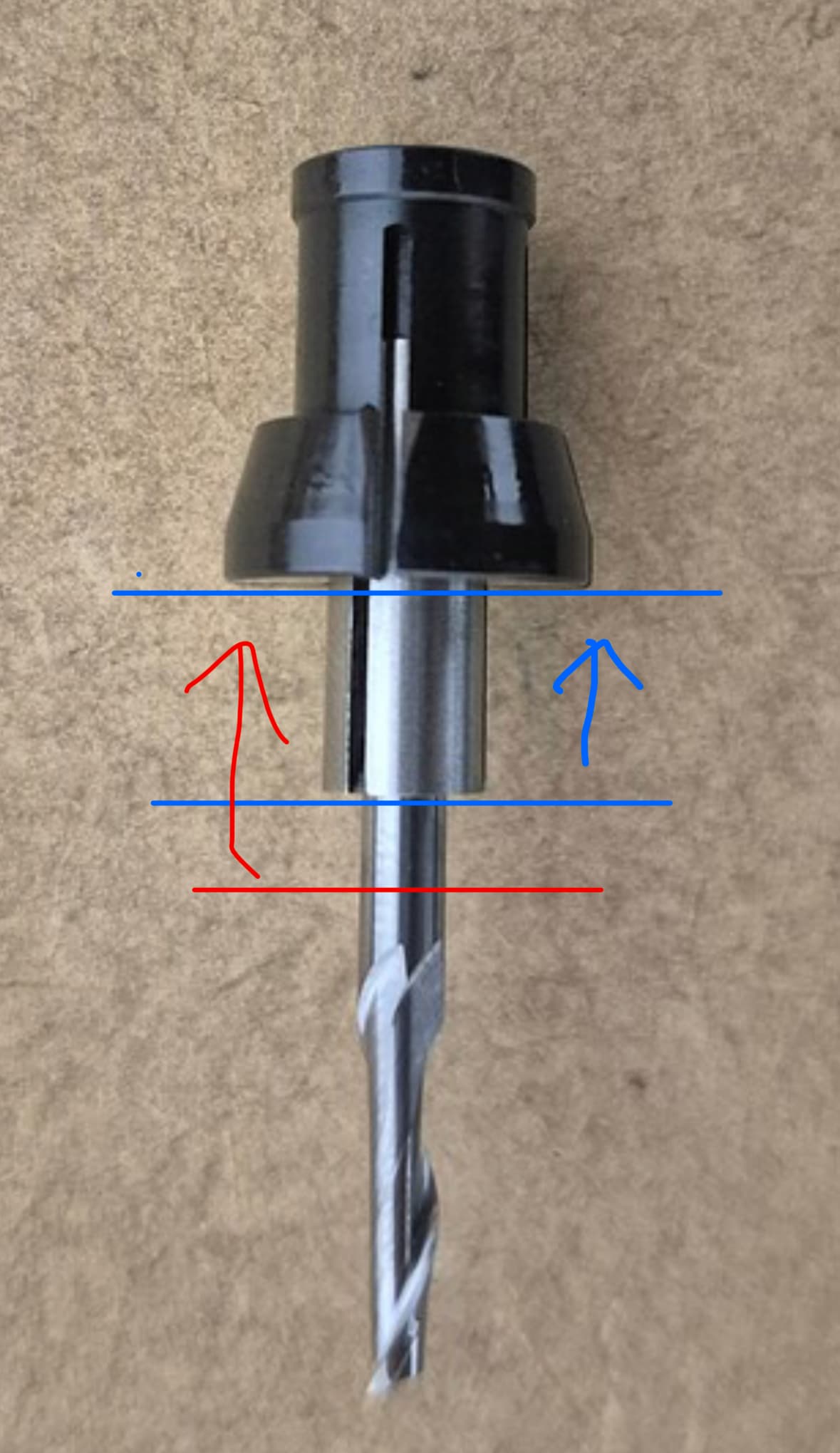

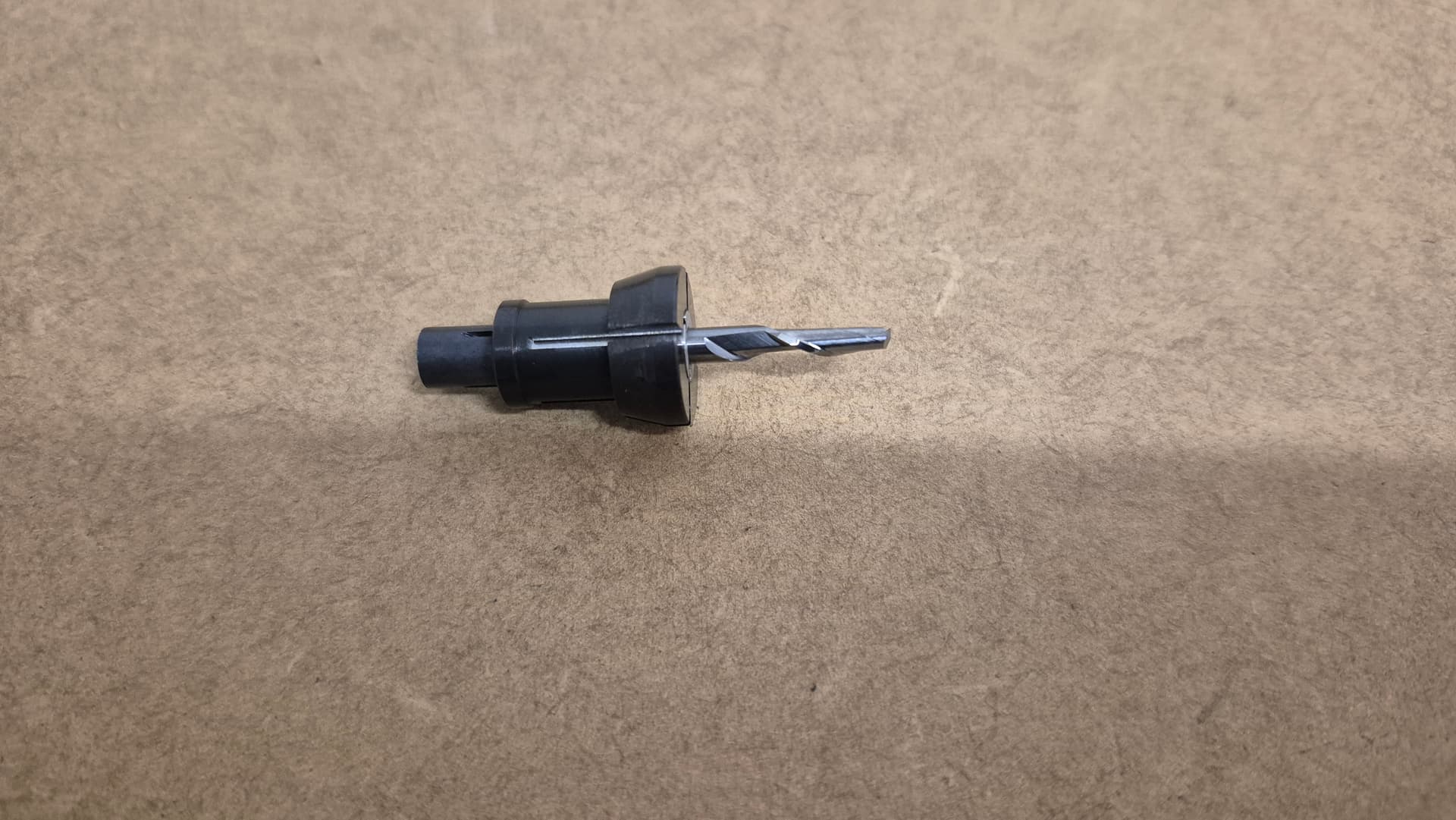

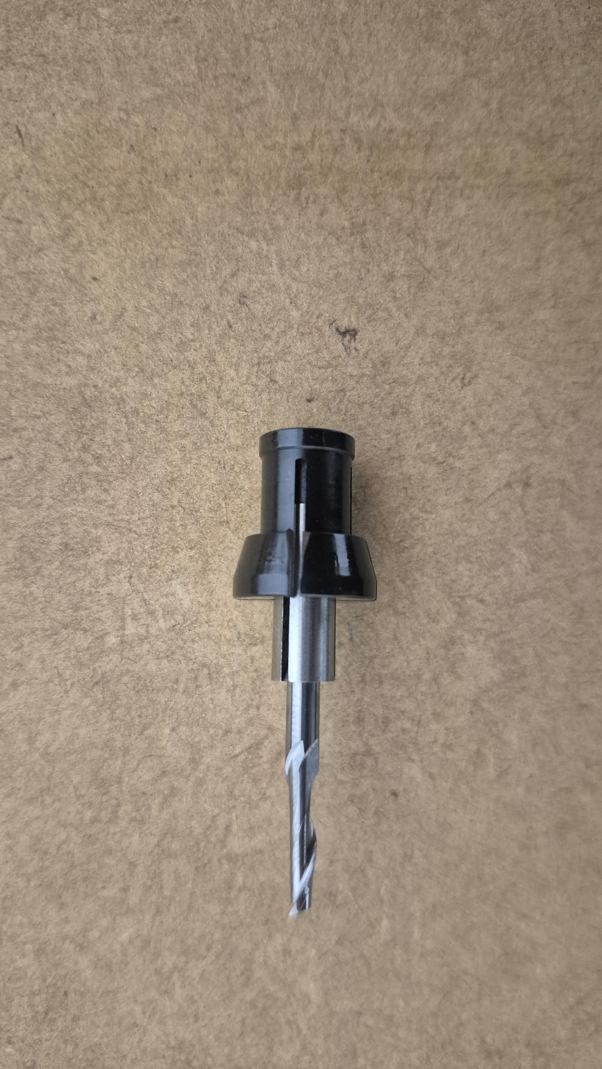

When clamping the cutter and the reduction sleeve, however, I was wondering how deep the cutter needs to be inserted into the sleeve (Reduzierhülse) and how deep the sleeve should be inserted into the collet.
Is it OK, as shown in the picture?
The reduction sleeve is flush with the end of the collet.
Does the silver part of the sleeve have to be completely inserted into the collet, leaving the black part sticking out?
Or does the sleeve have to be inserted the other way around?
When I’m using the sleeve, I insert it all the way into the collet, so it does not stick out anymore.
Regarding the bit, the longer int sticks out, the greater the flex will be. Keep it as short as possible, but pay attention that it clamps on the shaft and not the cutting part. I always try to have 1-2 mm safety distance from the cutting part. You also need to account for the collet nut which is a few mm thick.
Assuming that you do not need the full depth of the flute, I would insert the bit up to the red line into the collet, with the sleeve flush with the collet.
What Bastian says. :slight_smile:
Thanks a lot - that looks better! :slight_smile:
If in doubt, the cutter could come out a little further, right?
Yes that looks much better. It won’t break anything if it sticks out more, but it is advisable to keep it as short as possible to minimize flex of the bit.
