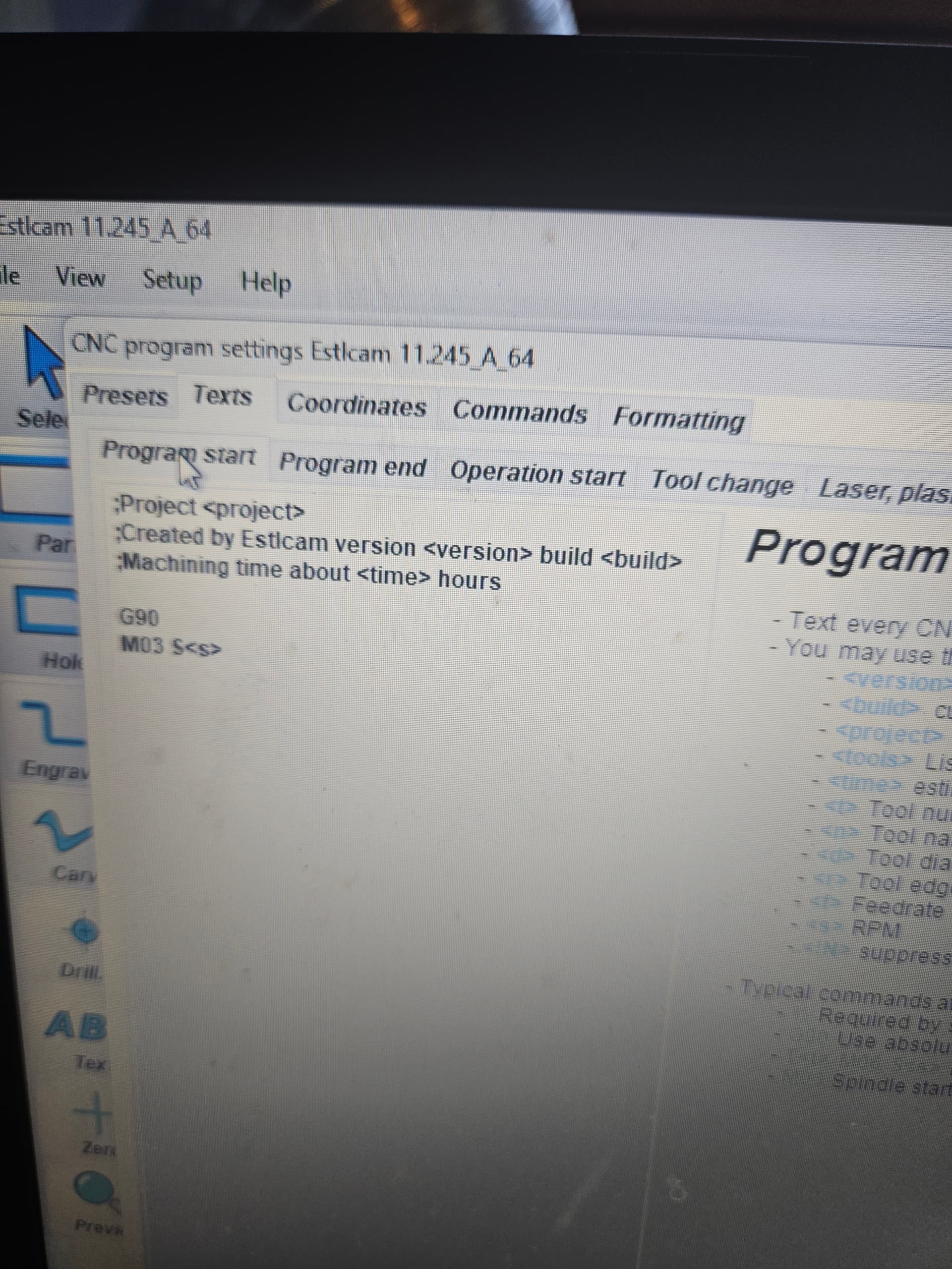

Oh, also check your Estlcam start code. I specifically put a G90 in mine to ensure it is in absolute mode before it does anything else.

Well, the “easy” fix is to put a G90 in your start code in Estlcam. Thos will force it into absolute mode no matter what has happened in between.
I didn’t think the movement commands in Marlin mode set relative movements, but I could se it being so.
I know that my Slicer settings for 3D printing set absolute positioning as a matter of course, so no harm in adding that to your start code for CNC programs, and isn’t too hard to do.
Edit: just opened Estlcam and checked Setup | CNC programs | Texts | Program start

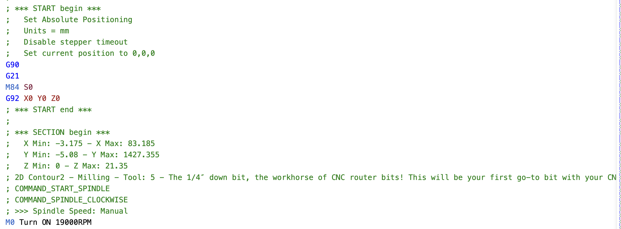

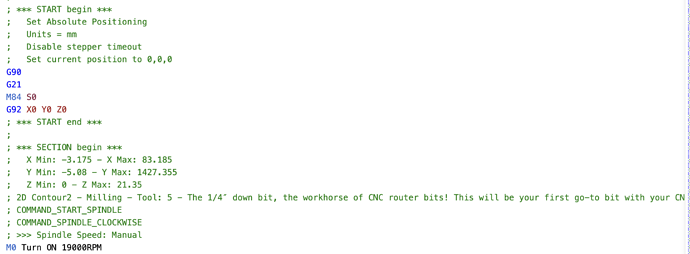

I wish it was that easy. I already verified that there’s a a G90 at the beginning of the gcode. This is the start code generated by Fusion 360
But somehow it’s ignored or overridden by Marlin if the in-controller move feature is used.
