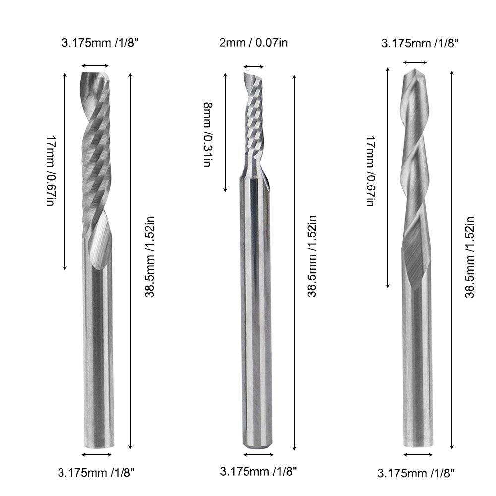

The little CNC use Arduino Uno r3 and shield loaded with the GRBL firmware. Material will be Wood or Acrylic. Bits as in the picture 1/8"

The estlcam settings should be close enough for grbl. In most cases, Marlin is more strict than grbl. You can do this whole project with the 1/8" bit. No need for tool changes.

All 3 type bits are 1/8"s, but I assume that you mean the upcut one to the furthest right on the pic?

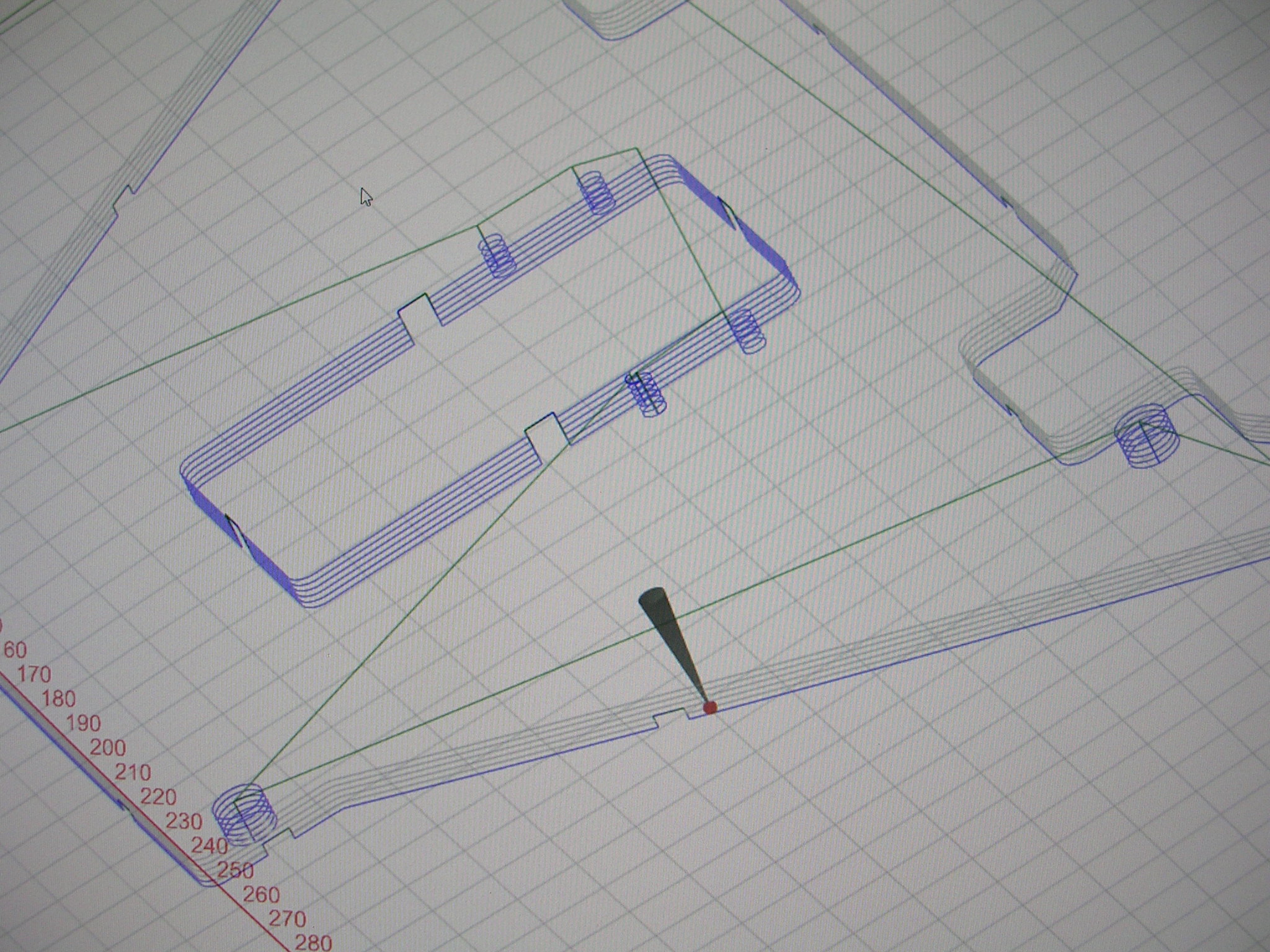

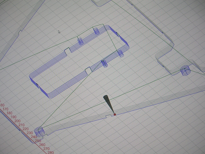

Anyway I tried ESTLCAM per instructions and think I made something that might actually work in the CNC i building. Anyway a loadable file was created and the shape looks good on the workspace of the milling program, in my case CNCjs.
I’m running the steppers on the table and they so far behave good, I don’t know if the orientation is right but that will of course be obvious when the CNC is assembled!

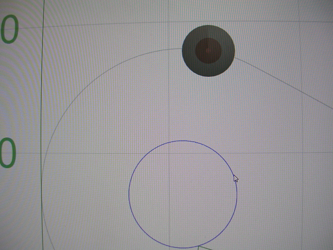

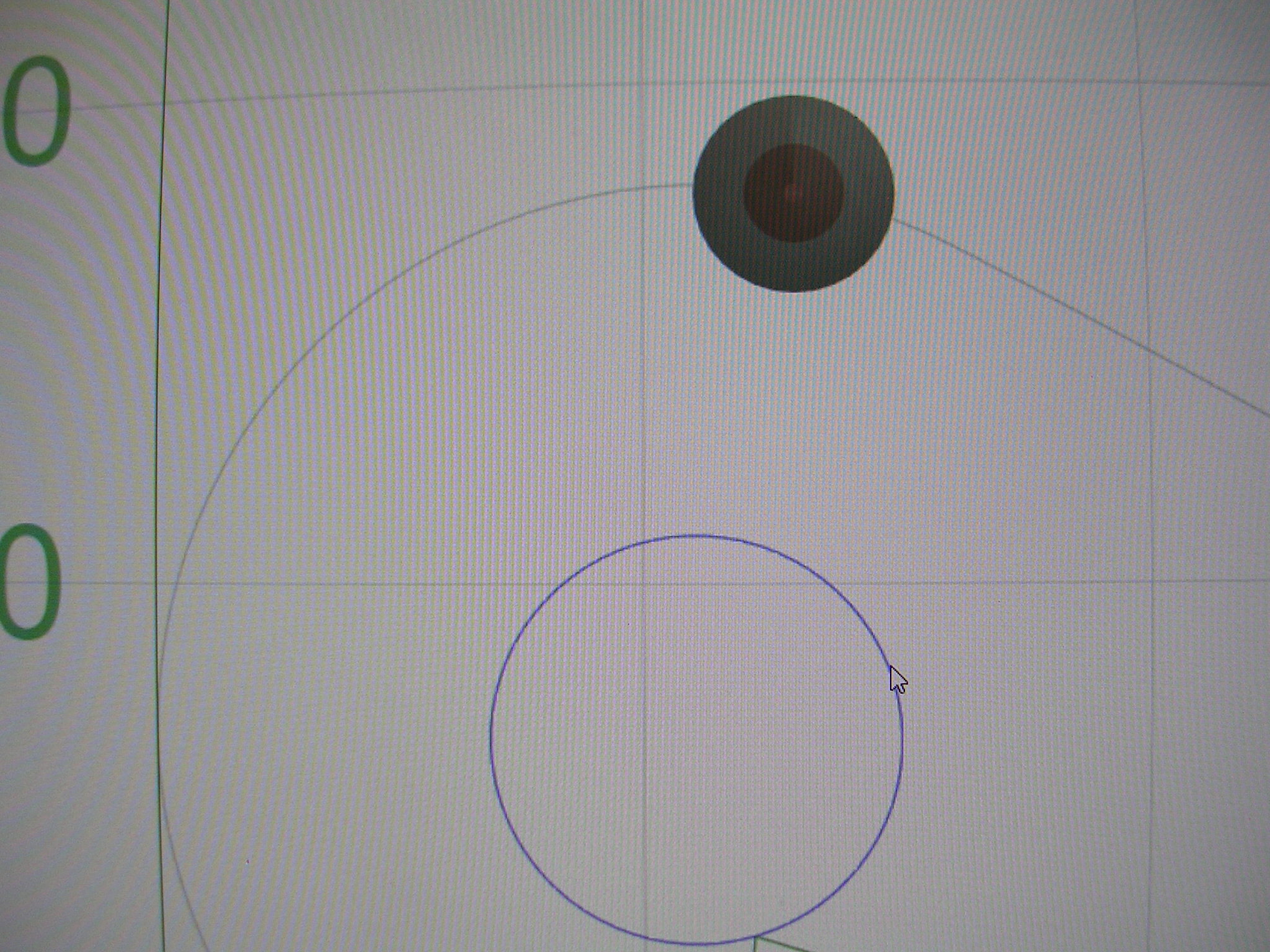

A question though as per the pic’s, will the bit be in the middle of the path decreasing the part with whatever radius the milling bit have or will it just be right on the edge of the line?
If not how do you set the bit so it cuts on the edge of the perimeter?

Generally the tool path shows you the path of the center of the cutting bit. It’s up to your CAM package (estlcam in this case) to take the cutting bit diameter (and shape) into account and adjust the tool path appropriately (as it generates it).

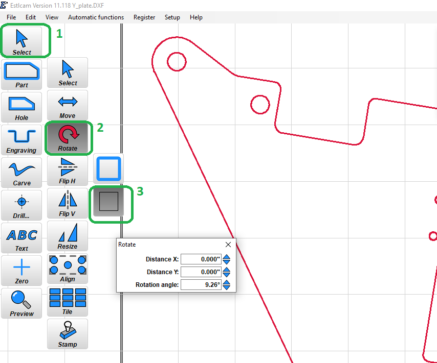

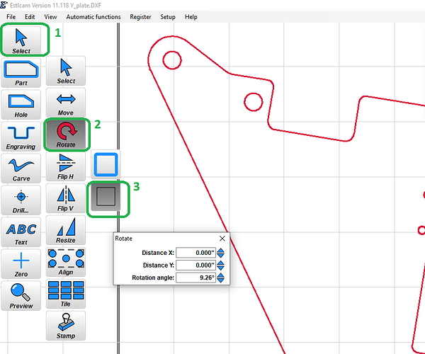

How can I rotate the 2d piece, in my case the 611 and Y plate so the longest cut will be in the y axis direction, since the small CNC i will use is to short in the x axis direction, so the piece doesn’t fit unless I can rotate it 90 degrees.
In estlcam or the cncjs or ugs or before that in a CAD program?
Because when loading the .dxf file in estlcam it is alreday oriented so the longest milling cut will be in the X direction not Y, as seen in the pic above of the Y plate where the red line is the X axis!
Grateful for any help how to!
Estlcam has a rotate feature. You might need to create the milling paths first, can’t remember.
https://www.estlcam.de/e2_objekte_bearbeiten_menue.php
Thx! I think I got it now!
