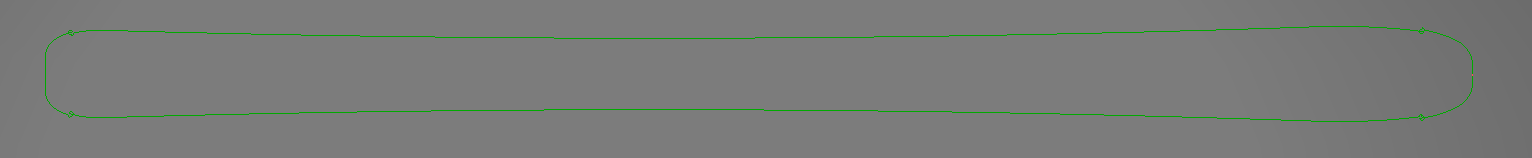

I have the attached GCode which I use to cut a 1.2 mm plastic sheet with a drag knife. The program runs 4 time with a 0.3 mm step down after each passes.
During the third pass my machine always fails when doing the second rotation to accommodate the 90° change in direction.
On the figure below the program starts in the middle of the right segment and runs CW

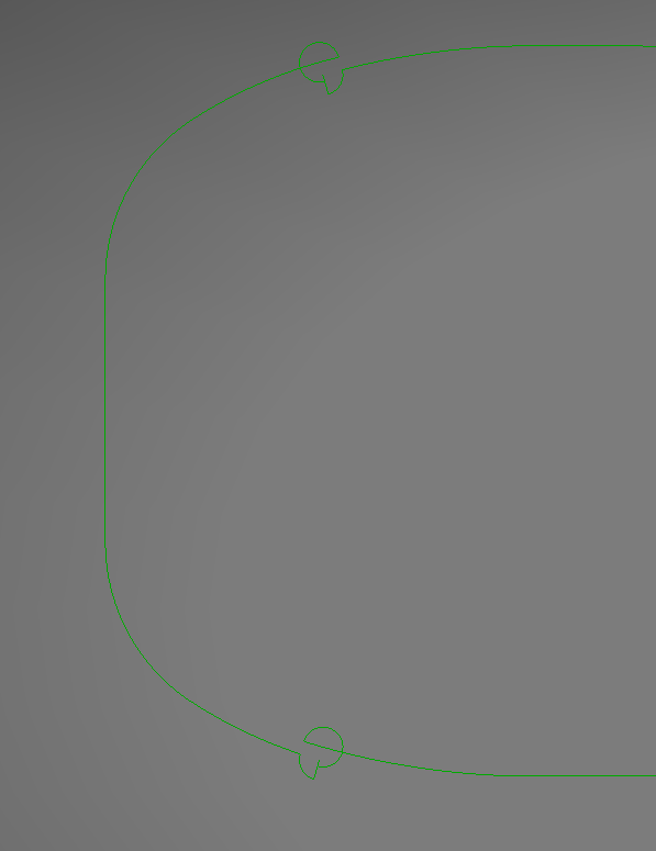

It fails at the bottom left turn on the third pass. See zoomed in image.
Can anyone point me in the right direction to find a solution or workaround?

I’m about 95% sure the massive G3 commands are doing it. There are 2 on each pass such as:
G3 X60.499 Y190.000 Z0.900 I24257.794 J-696.764 K0.000 F500.000
That “I” value is huge. It’s a tiny piece (but the whole left or right side of the drawing) of a massive arc.
The part that does the handling for the drag knife looks fine.
It seems you may be able to fix this in FreeCAD by enabling “Split Arcs”:
Indeed using the SplitArcs always solves the problem. I had similar issues in the past but failed immediately at the first dragkife turn. I was trying to see why it failed only on the 3rd pass.
