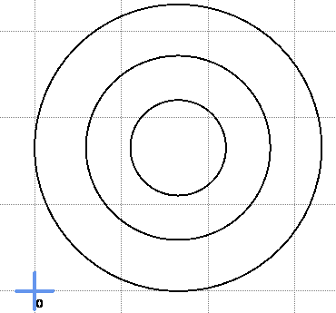

It sounds like you have a Jackpot, which runs the FluidNC firmware, which is based on Grbl. So, as long as you are generating Grbl gcode, you should be fine.
No, you don’t need Repetier Host and I wouldn’t go that route. You just need some type of CAM software to generate the gcode. Around here, EstlCAM is quite popular and likely has the lowest barrier to entry. Even though I usually use Fusion to create models, I find EstlCAM to be way easier than the Fusion CAM. There is configuration that will need to be updated for starting, tool change and ending gcode. Milling Basics - V1 Engineering Documentation
Once you have the gcode, you’ll just end up uploading it to FluidNC via the WebUI. You do this using the Upload button in the “SD Files” section.
Typically, before running a job, you’ll home the machine and use the jog controls to move to the starting point. You’ll want to note when you generate the gcode file, where the CAM software has the origin set to. I typically manually set that to the bottom left corner, but it can be anywhere.
For example, when I load this into EstlCAM, it defaults to the bottom left corner:
But you can put it anywhere you want:
And click the “Play” button to start it:
I hope that helps!
