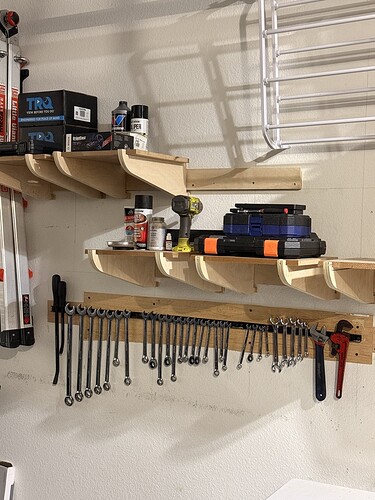

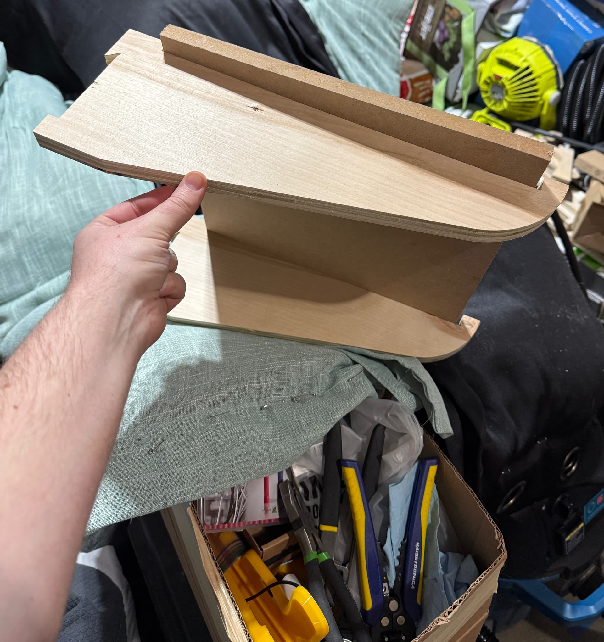

Since French Cleats are ruling my life right now (in the best way), I used the plywood to mass produce French cleat supports for my MDF pieces. I just held the wood in place and shot it with the brad nailer a few times. Good’nuff for me! I intentionally left that little gap between the front of the support arm and the MDF, mostly because I didn’t want to measure all 11 pieces and it worked out as a handy little hook for plastic bags (trash can wherever you are), zip ties, cables, etc.
Couple 11 of those with some magnetic strips from HF, and you got a stew goin!

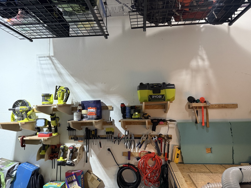

^ the ryobi display lasted like a week, I ended up moving everything around (glorious French cleats).. makes for a fun pic though lol.
And the car stuff! Most of the Ryobi shelves were later added to this area to hold all my car shit. Pro tip: Buy tools at HF, buy car parts off Amazon, learn how to do the work from YouTube, and save thousands per year in vehicle maintenance! You also get cool scars on your knuckles and can be the person that’s like “ya I do my own car work, it’s nbd really” #worthit :joy:

shelves look good. super simple and very practical. how long did it take you to cut the cleat parts?

Thank you!! It’s been a little while so I’m not sure, settings were something like 15 mm/s, 6mm DOC, 10k RPM, no finish pass via 1/8” single flute V1E bit so probably 10 mins each leg, if not less? Also I meant to have this quote up top first, but that’s mobile posting for ya lol

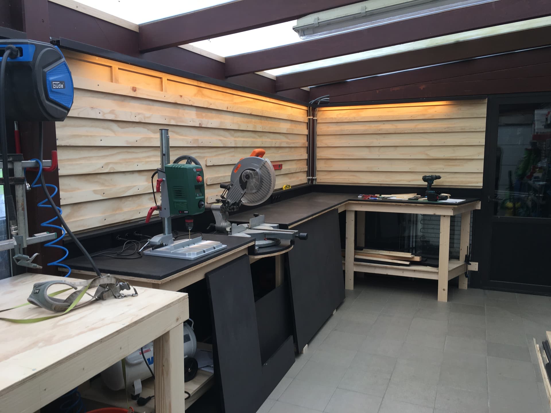

Is that glass panes for roof???
