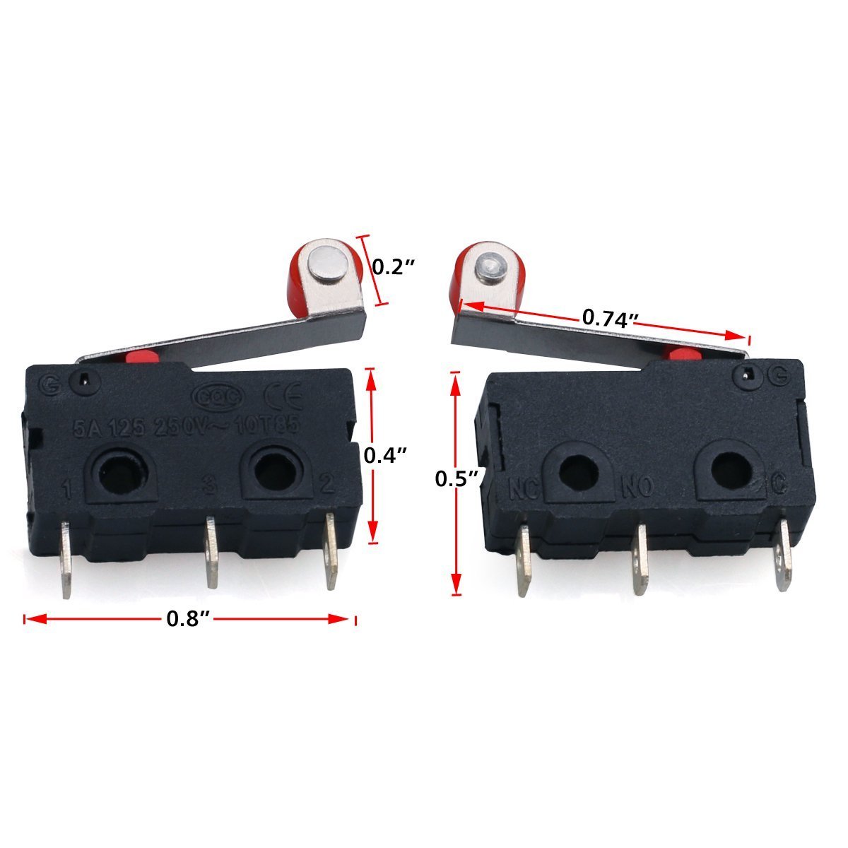

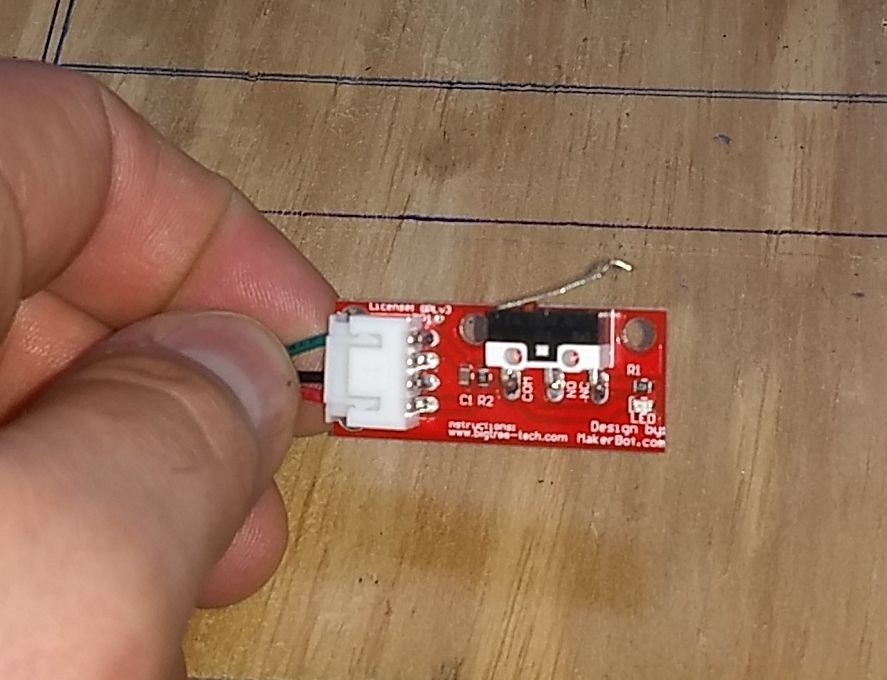

Yes, dual endstop version from shortly after it was released. Not sure how to tell exactly which version it is though. Using these switches:
[attachment file=51673]
Wired into the Ramps board as NC (Normally Closed) per the endstop instructions. No changes to Marlin except for the pin mod to use PWM control for the laser.
