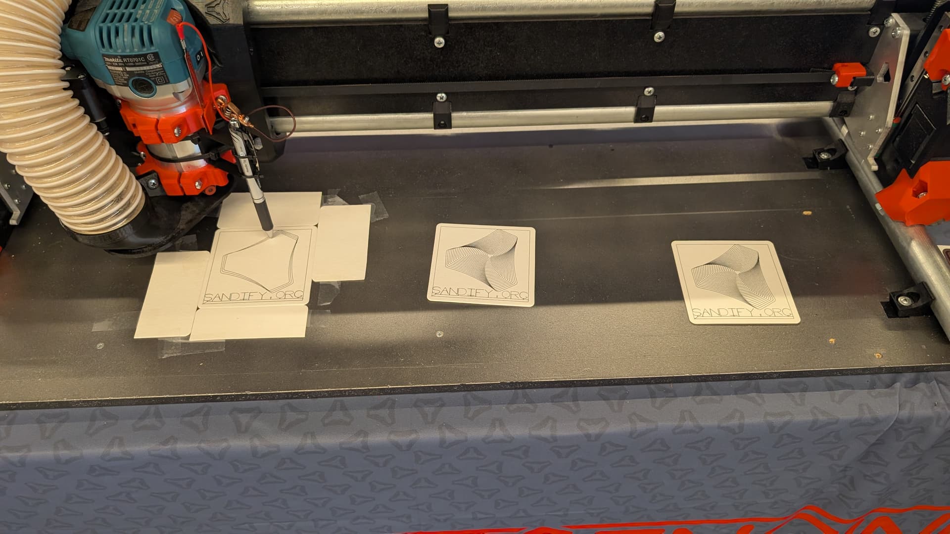

Hey @vicious1 @jeffeb3, are you able to share what Pen and Pen holder was working for you at Open Sauce?
I don’t see the holder pictured below in https://www.printables.com/model/1034840-lowrider-4-cnc/files, or, https://docs.v1e.com/lowrider/#printed-parts. Doc’s Initial Squaring step currently shows a neat no mount solution that just uses zip ties through router mounts. Nice, and good enough for first crown.
Maybe you’re using LR3 Fancy Pen holder at https://www.printables.com/model/662275-lowrider-3-fancy-pen-mount/files ?
Edit: AI thinks Pilot G2 05 fine point 0.5mm pen. But it’s wrong…
I’m 99.9% sure this is the pen Ryan uses. Amazon.com
That is the pen. 0.3mm is clutch.
The pen holder looked like the same compliant mechanism as years past and I’m pretty sure those holder were printed at RMRRF or earlier. I think Ryan was hoping he had a few more in the box than he did. But they held up ok to the curious fingers.
He also wired an endstop switch to the macro button. That was nice. It did weird things if you pressed it before the last pattern finished. But we could be in the middle of a sentence and pop a new coaster in and press the button from either side of the table.

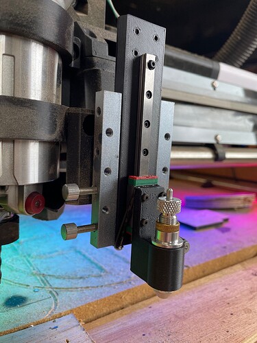

I made this one which uses a small linear rail to keep it rigid but allow vertical movement. Loom bands act as a preload spring. It’ll hold a drag knife or pen. It mates with the dovetail mounting of my diode laser so not really much use to anyone else.

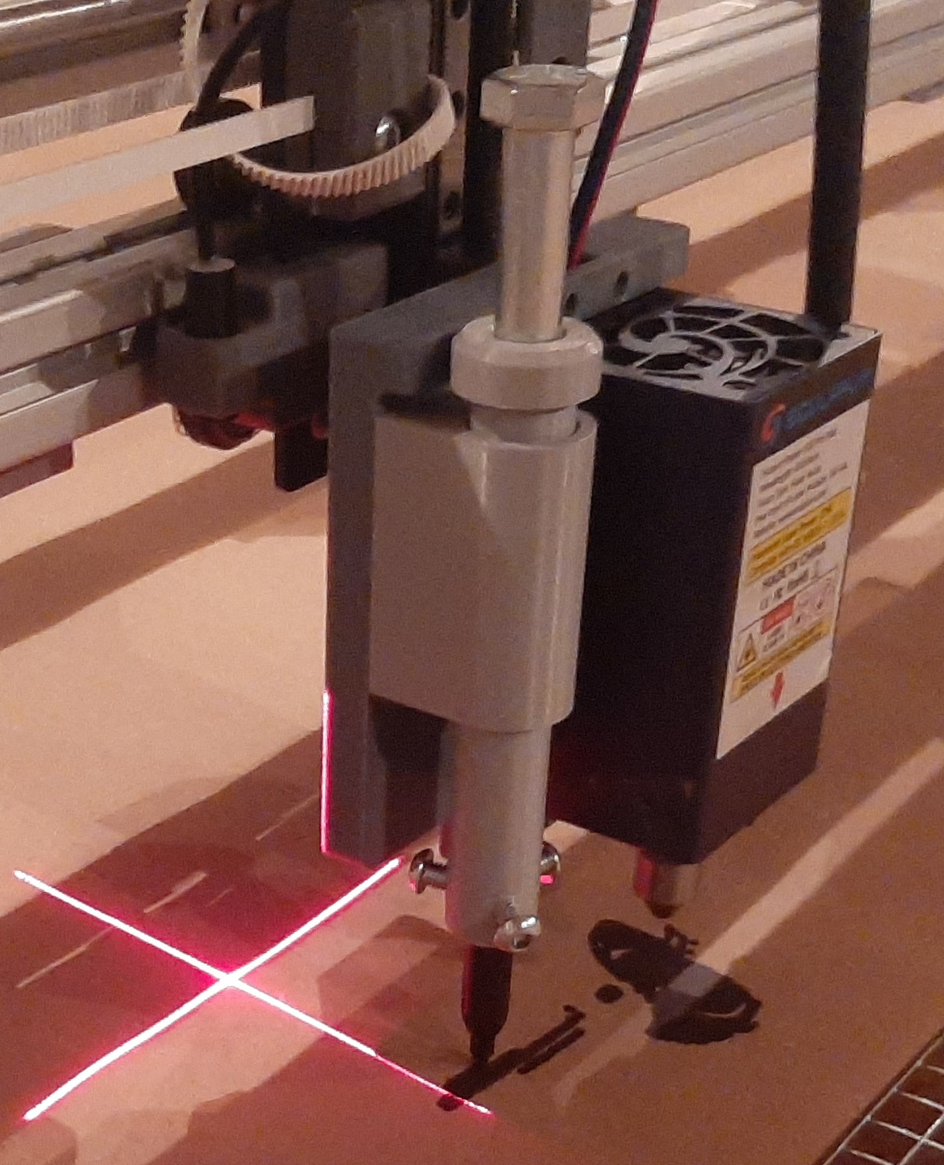

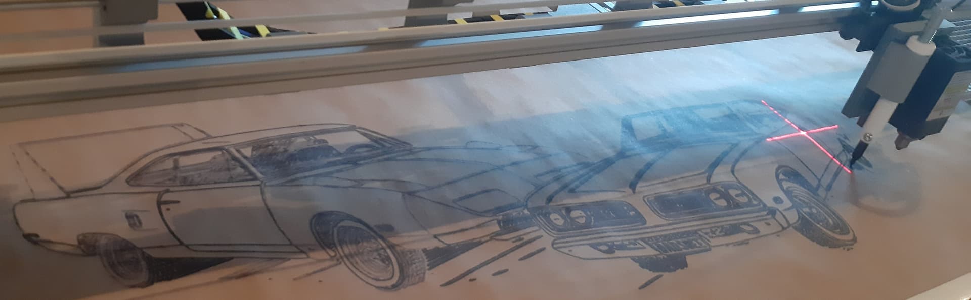

I’ve found that an assorted length of 1/2" hex bolts work great to ā€˜pick your pressure’. It eliminates the issue of varied pen tip to work surface offsets altering spring pressure.

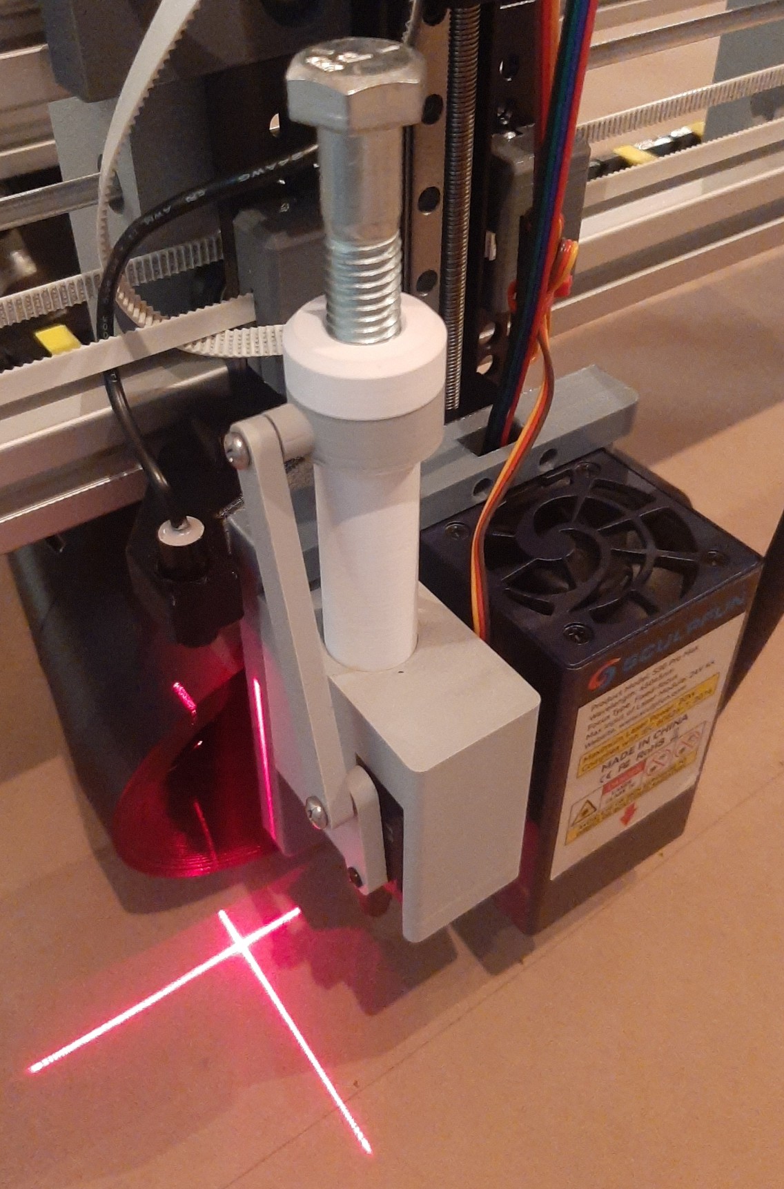

Now with servo pen lift… so much faster.

So you have a floating pen mount with a max drop position you can raise to lift off the page? The bolt holds pressure on it instead of it being rigidly mounted?
Yes, that’s correct. I use different length bolts for different markers (fine tip vs. not, etc.) to get different amounts of down pressure. It’s the result of researching recommended tip pressures for various pens and markers and thinking ā€œthese random bolts here on my desk probably weigh that muchā€.

I have tried various pen mounts but even the slightest variation in the height of the paper/surface make the drawings fail. Applying pressure through springs or rubber bands appears impractical because they are really hard to adjust.
It isn’t really, you only need very little tension to keep the tip in cotact with the paper.
true, my problem might be that i have not found the right pen mount/pen configuration that provides enough stability in the x/y but is loose enough for the z axis. any recommendations?
Do you have that servo pen lift stl published anywhere?
Servo Pen Holder.zip (2.1 MB)
22G RC Servo (Amazon)
#6-19 x 1/2" Phillips Drive Pan Head Grade 18-8 Stainless Steel Thread Rolling Screw for Plastic (Fastenal) to connect the servo linkages.
1x 1/2"-13 bolt (ranging from 1" to 2" in length, depending on Sharpie marker / felt marker / paint pen)
2x M6-1.0 x 20 screws to mount the assembly.
3x M6-1.0 x 8 screws for securing the pen – you might want the pen holder to be longer if you use the screws and the servo version of the pen holder-holder… I just use tape around the pen as the screws are a pain to remove and re-insert each time you want to take the holder out… which you may or may not need to do depending on your useable Z height.
