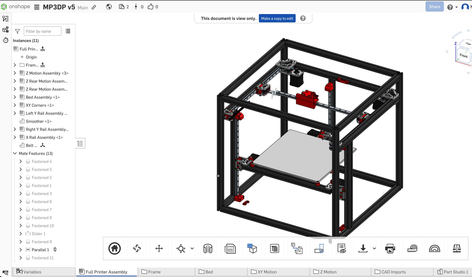

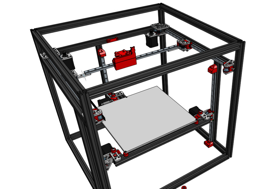

I rebuilt almost the whole thing in OnShape. I think it was missing some of the tool mounts, and maybe the panels.
I used it as my “Learn Onshape” project. I never posted it because
  1. it’s not 100% complete, and
  2. my printer is already built, so I’m not using it to verify anything. So any mistakes I made would not be found by me. I didn’t want to put a model out there with errors.
It would take someone with the time and the will to verify some things, and maybe even complete some things.
The last time I worked on it, which appears to be about a year ago, I think the parametric stuff all still worked.
It also has, I think, all of the hardware put in, so realistically is not far off from an accurate BOM.
I just don’t know if it’s worth the effort unless we know it’s the last MP3DP version, otherwise a V6 will replace it anyway
I have no issues with you posting a link. I trust it is close enough if not a perfect copy.
I sure hope not!
Still, considering my stalled build, this sure looks like I should take a close look.
Turns out the document has been public anyway.
Here’s the link. It should be open to make your own copy and do whatever with
I haven’t opened it in a while, and don’t remember the exact state of everything.
I was trying to learn so I spent a bit of time filling out all of the hardware, and trying to get all of the assemblies just right.
Right as I was about to do the other tool mounts, I was starting to see how I could use configurations to make it switch out all kinds of things… and then I had big plans… and then… who knows… I went off and did something else instead…
It got to the point where I felt like I did enough learning and was ready to move on to something else.
I do think everything SHOULD be right, but I was redrawing everything from the Fusion file, and Fusion is an absolute pain to try to work out where all the projections, etc. come from… so who knows.
Working for me. Thanks!
