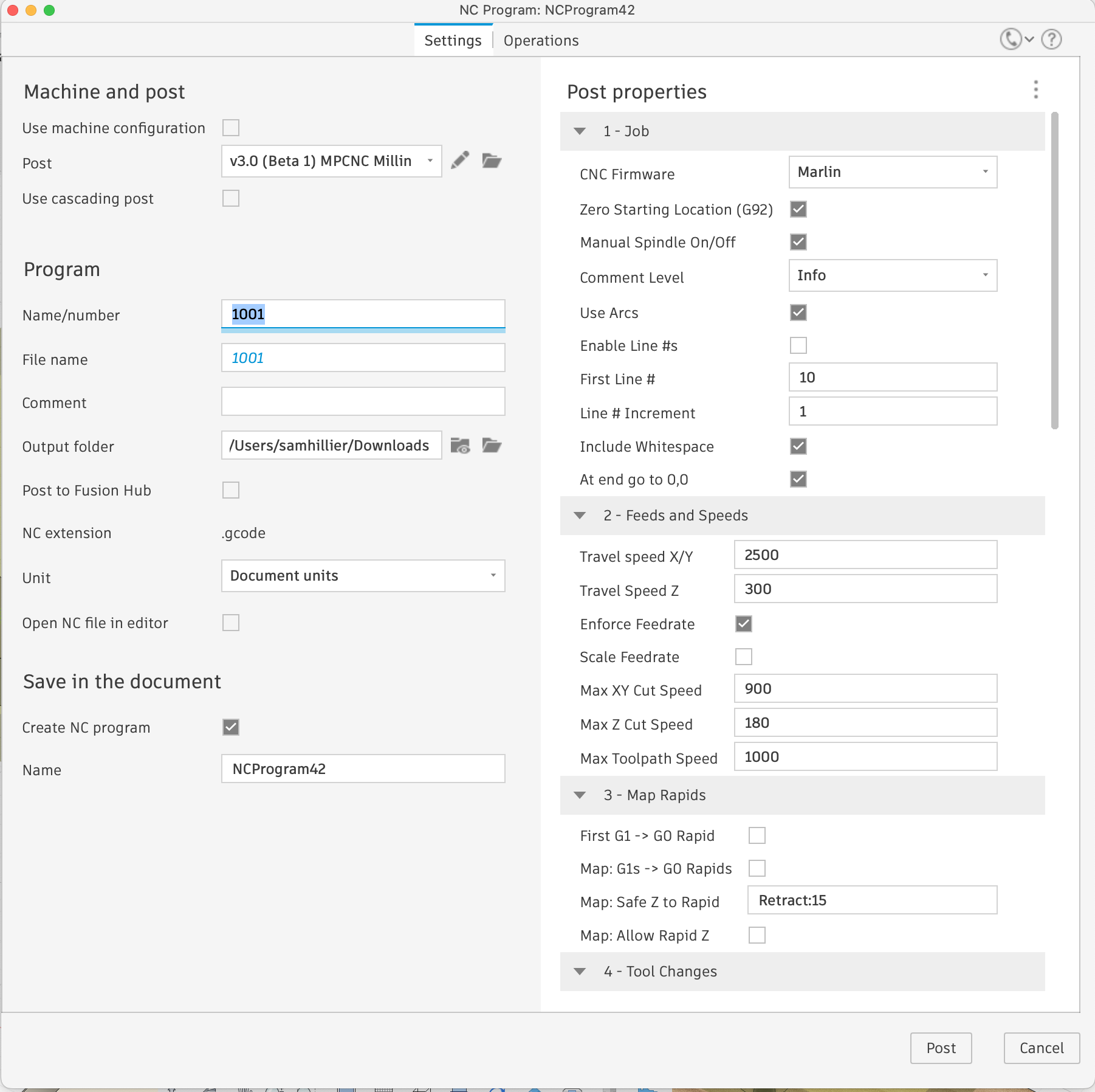

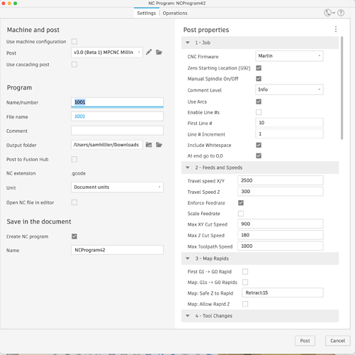

The post-processor, by default, enables no option that would not align with your F360 license. As the user, you need to determine what is enabled and how this aligns with your license.
Scale Feedrate should scale the Z feedrate, and for your configuration, I recommend setting it on. I would carefully check your GCode after making the change, as I would have thought the Max Z Cut Speed or the Max Toolpath Speed should have placed hard limits on the Z5 F3000.
I have now reviewed the code and with Scale Feedrate disenable there is NO Scaling or Limiting of the feedrates. This is why the F3000 is making it through in the GCode.

I’m on basic hobby fusion licence. I’ve notice my travel speeds in-between cuts are quite slow. Is there an option in the post processor or in Linking I should change?
Im having great results with fusion. But I’m a bit overwhelmed with the amount of settings. If you have any tips on settings that would help that would be amazing.
Yeah, that’s a limitation of the Personal Use (Hobby) license. I use EstlCAM for creating the gcode. If you have your heart set on using Fusion for creating gcode, you may need to manually edit the output to increase the travel speeds.
In the hobby version of F360 all moves are G1 (slow cutting moves), F360 sends no fast G0 (rapid moves) to the post processor. This results in very slow overall performance.
As a developer I have respected F360 defaults and pass G1s from F360 as G1s, and G0s from F360 as G0s. This creates a GCode file as F360 intended and as aligns with your license.
That said, if you are a hobbiest there are options in the post processor that you can enable that greatly increase overall performance - but you should not be enabling these if you are doing production work. If you are doing production work with the hobbiest version of F360, these options were not intended to bypass the need to be licensed correct - you should instead buy a production license for F360.
That said, as I hobbiest I do enable these option as my work is limited to small personal projects and nothing I create is sold or given to others.
The post processor can’t change the hobbiest output into the same as the production output of F360, but it can sure help. For clarity, get a production license if you need production speeds.

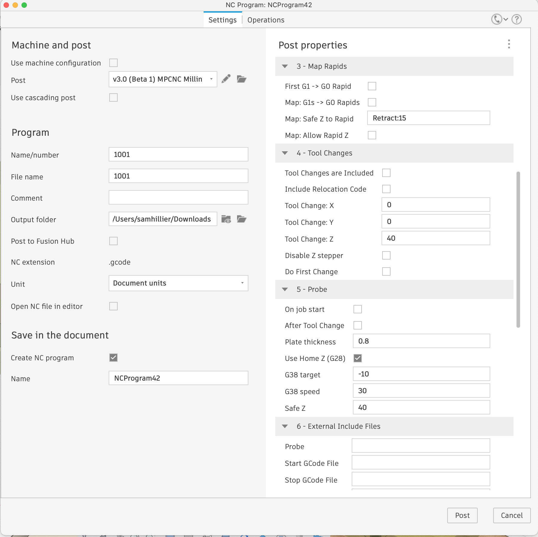

Options that help are:
converting G1 cutting moves to G0 rapids, if the Z position is above a defined Safe height
Convert G1 cutting moves to G0 rapids, if the move is only vertical, is going up, and the target is above the defined Safe height
Convert the first G1 cutting move at the beginning of a cutting sequence to a G0 rapid - as a cutting sequence always moves to the first location before a cut occurs.
For these to work you must ensure your Safe height is set to align with the clearance heights you used in F360.
As a hobbiest I consider enabling these to be within the spirit of how I’m using F360. If I was doing production work then I would purchase a production license, in which case these options would result in no conversation of G1s to G0s as they would all be correct prior to reaching the post processor.

Hobbiest should consider enabling all options in Section 3, but only if they are not doing production work. Safe Z to Rapid takes a layer name where rapids are safe (“Retract”), if this is not defined within the F360 environment for some reason then 15 mm is used. Users need to ensure this value is set correctly in their F360 setup.

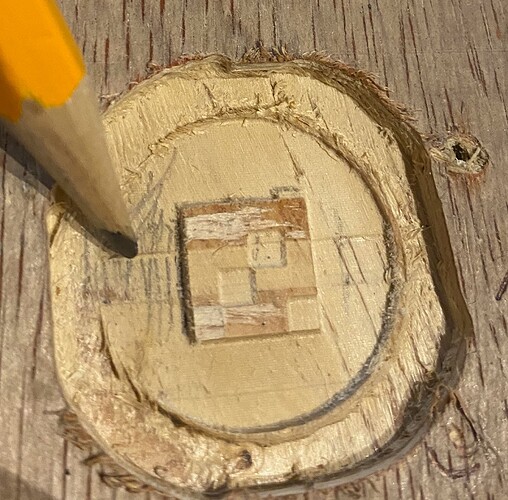

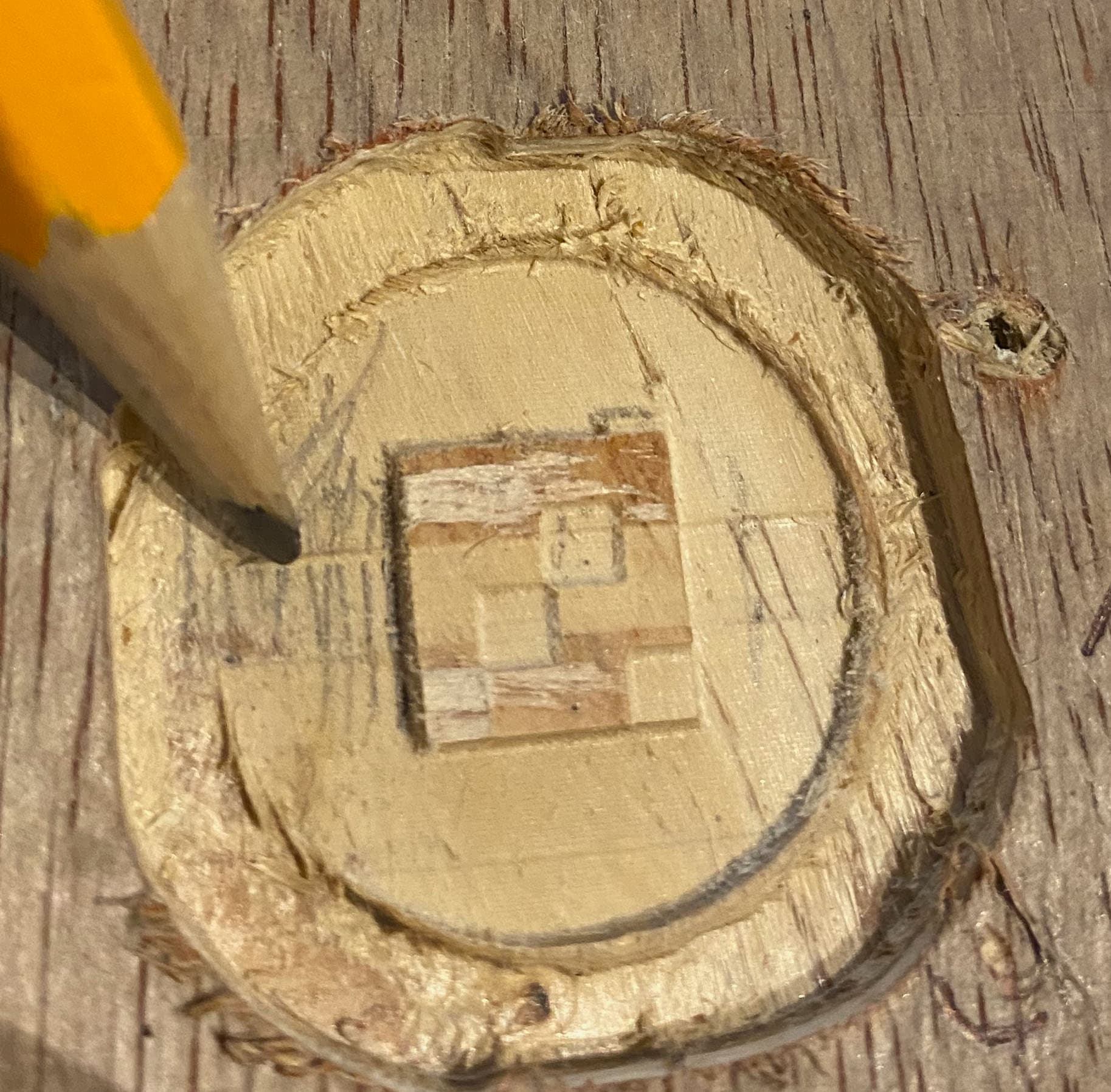

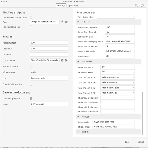

Hi there Im a new MPCNC user and Im using V3 pp with Fusion on the mac. I have a couple of issues with the a parallel pass. I would have put it down to an issue with slip on the machine but while watching i noticed a couple of moments where CNC seemed to just stop moving. Im new so Im not able to read or understand Gcode yet unfortunately.
the second image is a test pattern I did, and you can see a similar depression. on both parts I had two passes, an adaptive clearing, which seemed to work perfectly, then a fine detail parallel pass which both seemed to have issue.
