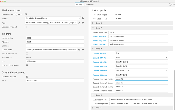

Hi. It was running perfectly until the Fusion 360 Update 2.0.21286 x86_64
I’ve filled a Issue:
Thanks

I’m now hearing that there are issues with Fusion 360 Update 2.0.21286 x86_64. I’ve gone and read the release notes for that version of F360, and yes they “enhanced” the core interface that drives all the post processors.
To be honest I haven’t done any F360 work in a few years, as woodturning and my YouTube channel (@DGWorkshop) have consumed most of my time. Right now I’m not even sure I have an operating copy of F360.
From the one picture I’ve seen of the problem it looks like F360 is trying to evaluate the option strings that contain values like “condition?true value:false value”. These were normally evaluated inside the PP based on the value of metric, if metric is true then the first value is used, false the second.
Can anyone confirm if you edit the parameters to just have the metric or just the non-metric value does the PP then run.
Any debugging would help. Also please chime in if this version of fusion is working or failing for you. This will help isolate this down. Also, when Fusion releases the next version, after Fusion 360 2.0.21286 x86_64, can someone comment if they fixed the problem - maybe other PP are having a similar issue.
