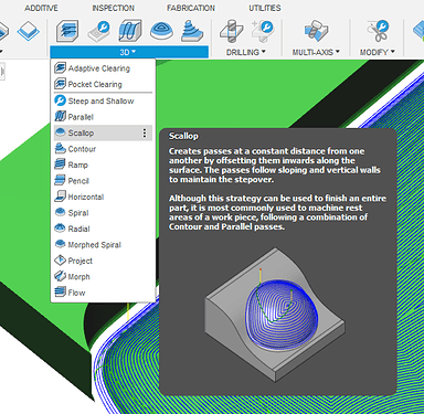

@jeffeb3 different from adaptive. I’ll get a screenshot later when I’m on my computer this afternoon.

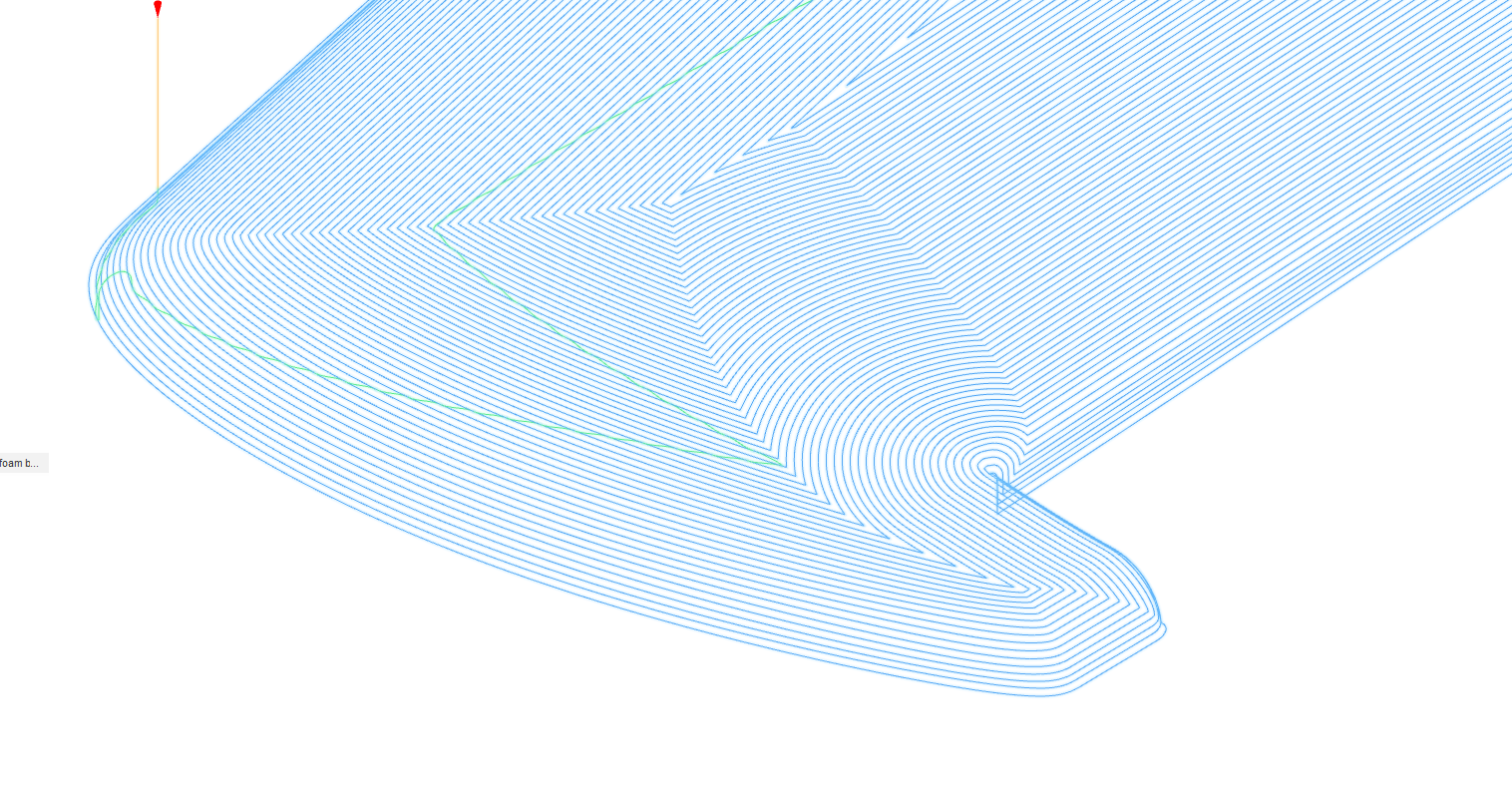

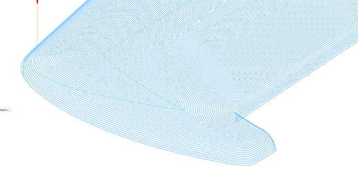

Here is the scallop toolpath I mentioned.
and works well for milling my rc plane wing
I haven’t done 3D milling in estlcam, but in a pocket, there is a pattern called “peel” that does that. I would have to poke around to see if there is something similar in estlcam.

Peel is different than scallop. Peel is a 2d process in ESTLCam. Scallop works in 3D space and moves x,y, and z as it moves around the part. Think of it like a 3d warped peel.

This sounds like “Waterline” machining in ESTLCam’s 3D module.
