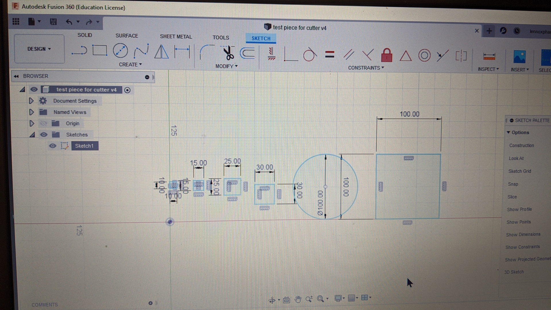

Well. Was thinking more about this so did up another piece in FS 360.
Took it into Estlcam
Then cut it out of some 12mm ply.
Consistent error across the X axis of about 3mm
So here is my looking at it.
The X axis error is pretty much 3mm too small right across the board,
10mm sq is 7x9.6
15mm sq is 12.4 x 14.8
25mm sq is 22.3x24.5
30mm sq is 27x30
100mm sq is 97x100
100mm circle is 97x 100 with X always shorter.
This is not a % error, it is consistent across all sizes.
What have I done wrong? Is there something in the CNC setup in Estlcam that could be doing this?

The estlcam toolpaths look a little funky to me. Like they are engraves on top of the lines. The bit is about 3mm, right? Can you post the gcode? We can probably look at the dimension on one of the squares and see if it is full sized.

Could it be short one diam of the cutting tool? ie 3.2mm? Is there some thing in the setup that starts it on the wrong side of the xyz zero point?

This is from one of the square holes on test 2.gcode. It is a little hard to see, but Y goes to 26.1850, then Z, X move around and Y goes to 45.0100.
So the Y length of this side is 45.01-26.1850=18.825. If you subtract 1/8", it is 15.65. Shouldn’t that be 15mm exactly?
The X also goes from 43.6390 to 62.464, which is also 18.825. So that doesn’t explain why it is different in X.
So, after looking at the gcode. I think it looks fishy, but it doesn’t explain that descrepency.
What does the machine look like when you send a 3mm move in X? Try switching directions. I am wondering if there is something loose (like a pulley) that is causing 3mm of backlash. 3mm seems like a lot for that though.
Have you done anything to adjust the steps/mm in either direction?
So what happened since here? I am confused how the error jumped 3mm.
does your machine have duel end stops? if so the x and y cuts start in negative space but that only explained that instance
