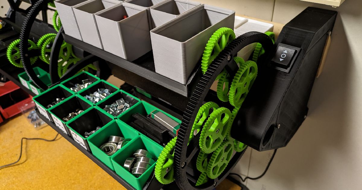

Ok. With large I mean a complex project, something that requires planning and some sourcing of hardware. Something like this:
Ooooh! Gears! and Motors! and 100% more of both!
I want to build that, even though I have no use for it.
