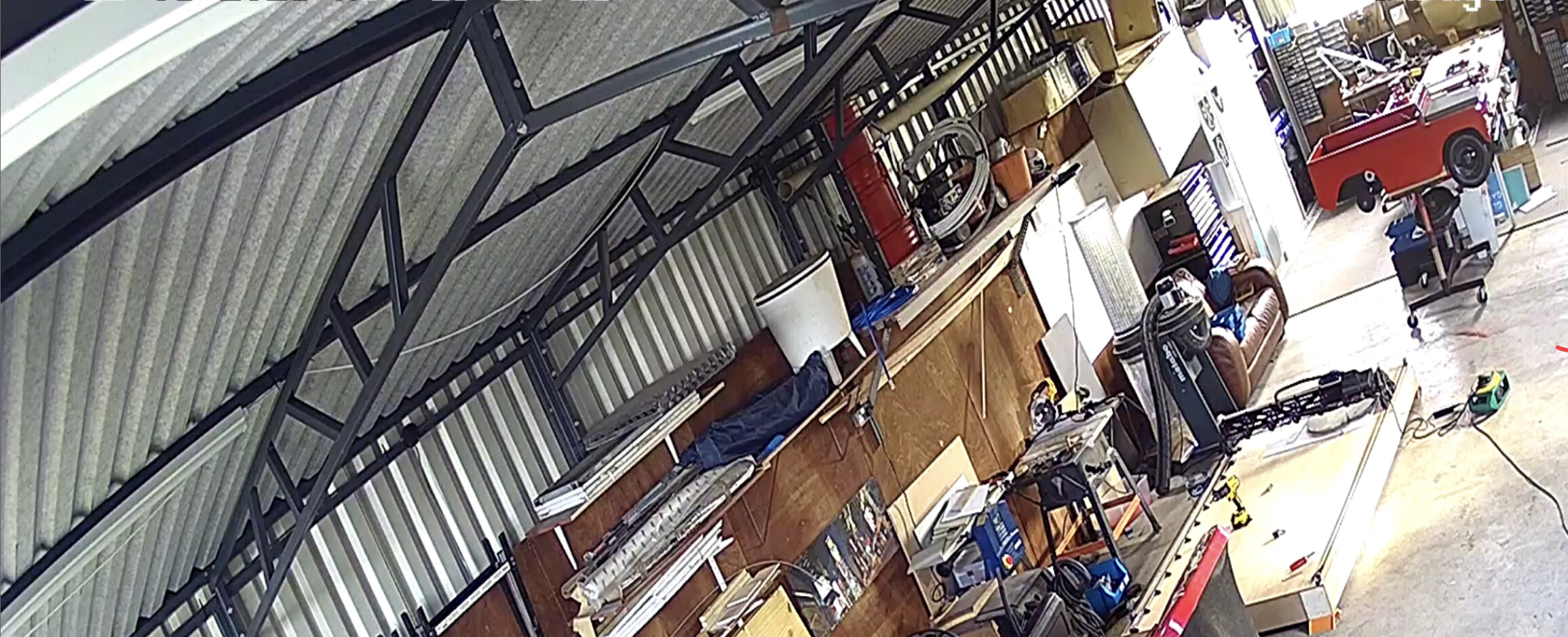

I’ve been pondering exactly the same thing. I have access to the steel frame of the garage but need a way to take a 4 point rigid sling/cradle and get it up there out of the way. It’ll fit between 2 of the trusses easily.
I was thinking of one of those cheap(ish) electric winches. That or I need to make friends with a rigger…
