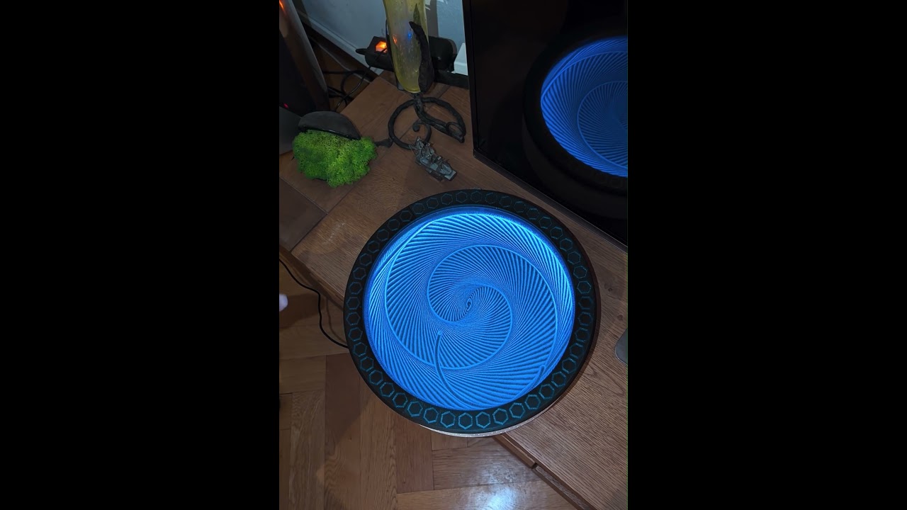

Full printed sand table
Hello I’m Christian
That’s my second build for something similar to a ZenXY. I designed all parts and everithing is made from PLA.
All the system is drived by a pi zeroW, connected to 2 Nema 17 with MKS servo42 drivers. strip light ans a home sensor are completing the setting.
The system itself is not a Scara copy like Sysiphus does. In fact, the support plate is turning as the main axis and a small rotor act the magnet. that’s complex… but really simple and get the advantage to be droven by real big gears in modul 3. The first setting is still working since more than one year 12 hours a day.
The main objective was to do something able to be connected to a phone, integrated or not to the home network, with a simple interface. Looks like that
Software is python, linked to node.js for javascript. The machine prepares a bunch of file for the following day during the night and start drawing them one by one. That’s all.
in manual mode you can play one choosen file
I’m currently adding the ability to play uploaded files from sandify… A big test for me. I discovered that my samsung gave the .thr.txt extension to the files… not so easy to solve. From a normal computer, there is no issue like that it works.
I will share that build on the bambu makerlab platform and put software on some github with a complete sd card backup… that’s not easy to configure a raspbian system with library changing over the time and making some code unable to work… Learning curve for me !

Awesome looking build.
When you say the support plate rotates, so you mean that when the pattern is being drawn, the existing pattern in the sand is rotating and the ball is just moving in a line, radially? If so, are there any downsides that you’ve seen to this approach? I’d be worried about getting motion sickness watching it!
Hello Jono.
I got one of these since 1 year, it’s working full time. The relative movement is with 2->5 cm/second, it’s slow and u will don’t became epileptic. If I don’t explain the system, people don’t find that the ball is not moving around all the pattern, because she is on a half circle. I lift the rotating plate and they understand, but the pattern effect stays. The bad side of that system is that you have to fight the noise of the system supporting the plate . Not so complex to do, the table is absolutely silent, the drivers i use are overkill but far better than tcm’s . The first build I made with wood was more loud.

Do you have any pictures of it without the top? It looks like it is a SCARA, but the shoulder joint is rotating the whole canvas and the elbow stays with the same rotation axis. Is that right? It looks like that especially in the initialization in “New sand table demo 2” about halfway through.
I was waiting for the request :wink:
here is the internal system. The sand support is PMMA then we can have a look.
Of course… V1_logo
Ok. That looks to me like it is a SCARA arm. But instead of the shoulder moving the whole mechanism, it moves the whole table. How clever!
