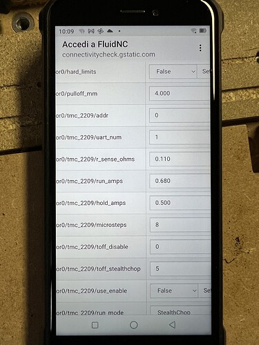

What stepper motor currents do you have set in your config.yaml?

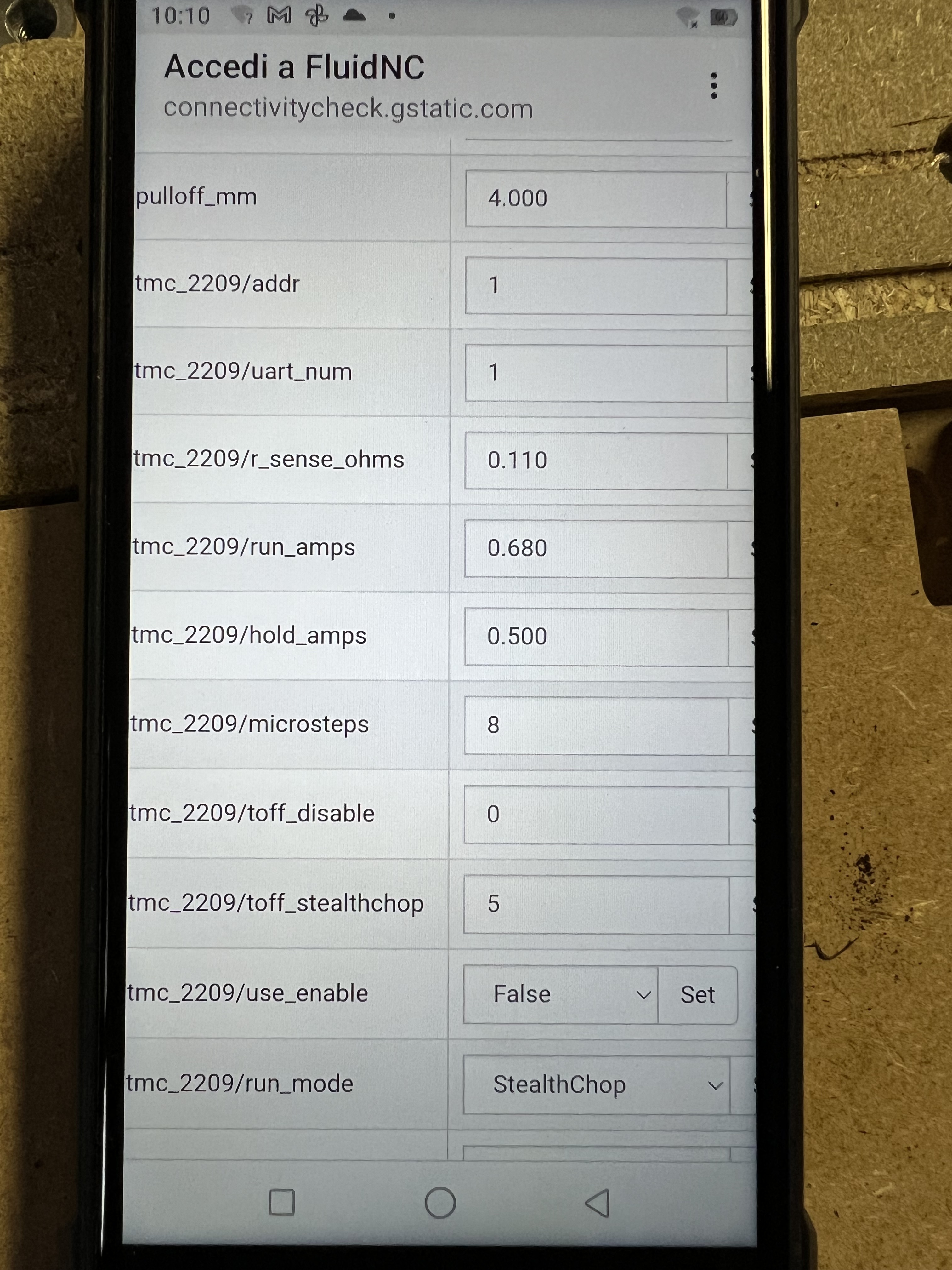

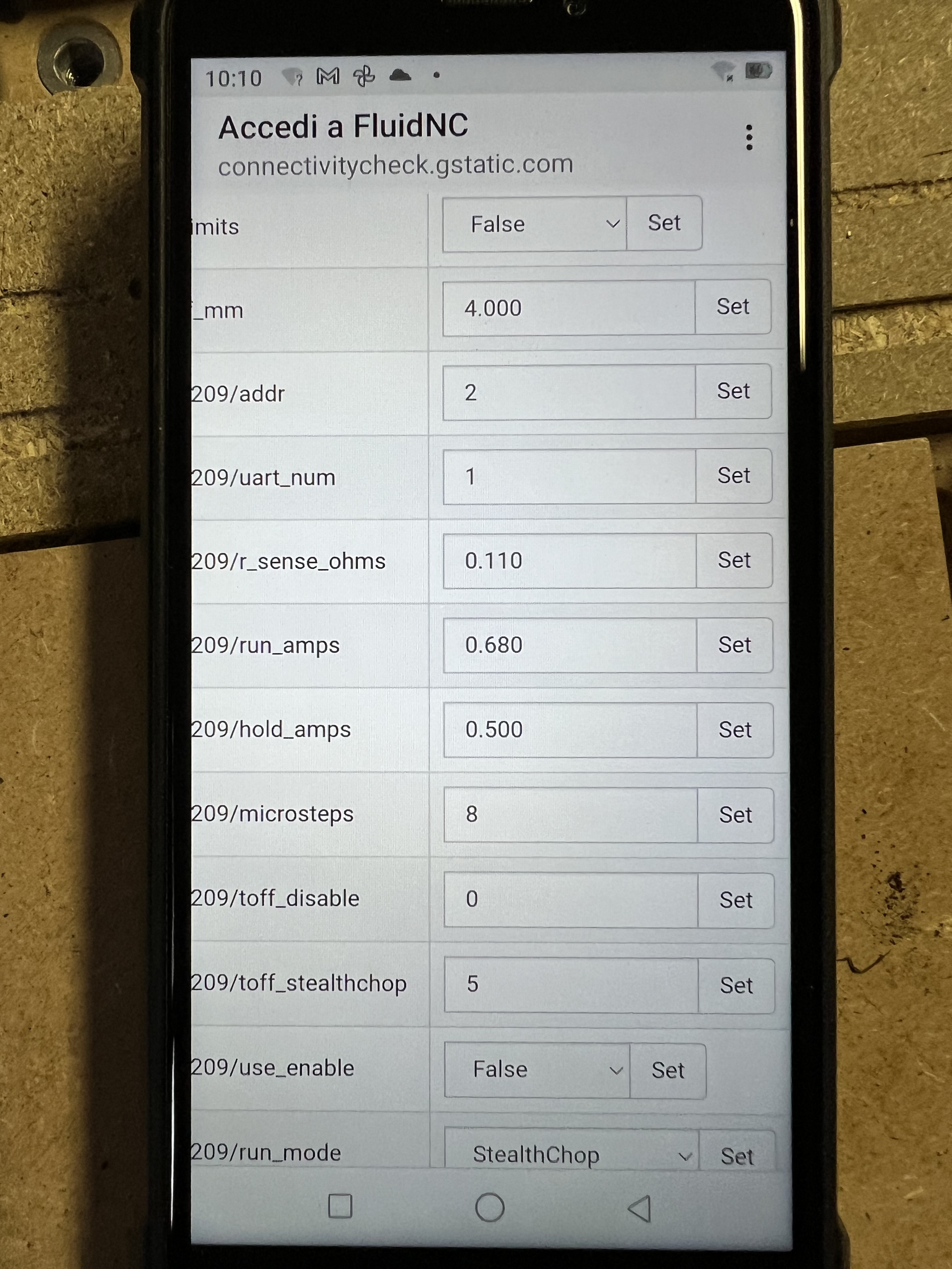

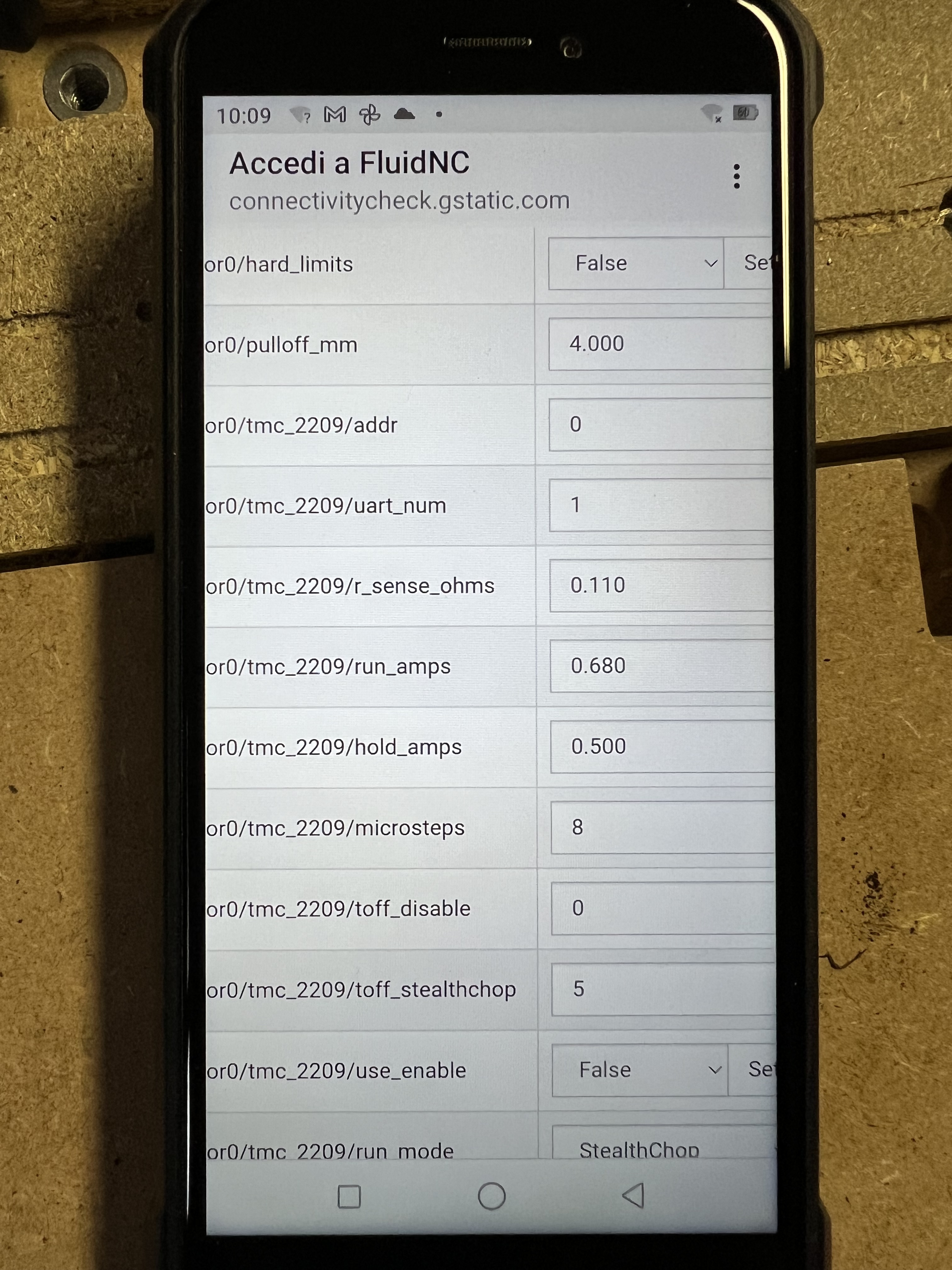

X:
Y:
Z:

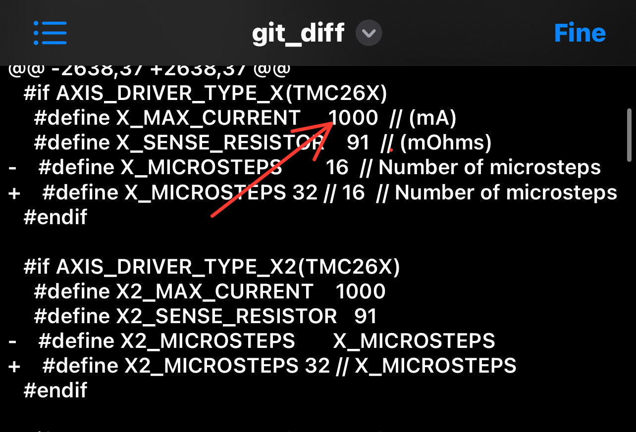

Ok, I checked for the Amp settings in Marlin V1 fw and I found that it’s 1amp.
Now the question is: why the skr default is 1A and the Jackpot it’s only 680mA? There’s something wrong with one of the two settings?
If needed: I’m using 24v power supply
That is not the right setting in Marlin. It is X_CURRENT, etc. thise settings are for TMC26x, we use TMC2209. It is set to 900mA in the LR config.
The jackpot configs have it set to 680. I am not sure why they are different, but I would just assume they are fine and adjust them however you like. They may have a different method to calculate what that amperage means. Or maybe Ryan has gotten more conservative with the jackpot.
A difference of 50mA can be a big difference. You want to make sure your drivers don’t overheat and your motors stay under 50C (or the mounts can get soft and deform).
