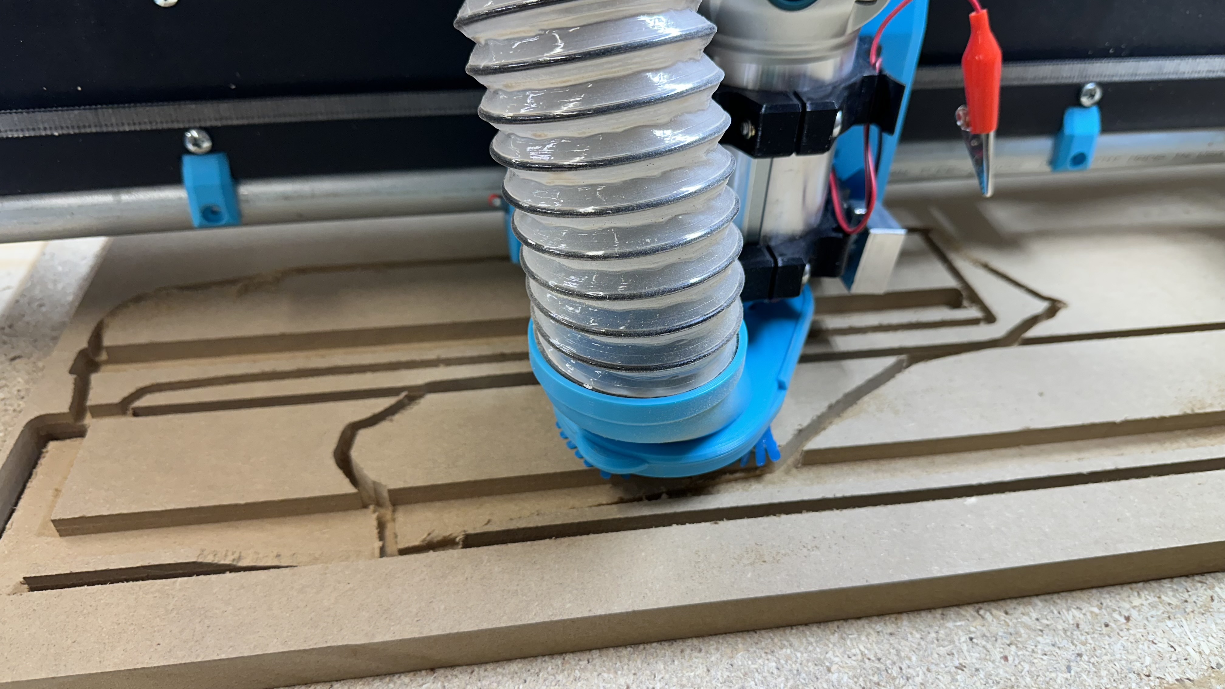

Think I’m making progress, at least a little.
When I select the faces and do the “project” bit, then export the DXF, it looks correct but EstlCAM won’t find the “closed” polygon that I need to create as a pocket for the dado cut into the piece.
My sketch looks like this:
But in Estlcam (aside from being rotated 180 degrees, which I don’t understand either):
I need it to see the “H” shaped bit as a closed polygon that I can use the pocket tool on, but it just doesn’t seem to find it. I can move the mouse around and it selects numerous other closed polygons, but never then one I want… I also need it to see the entire outline so I can cut it out as a part; sometimes it does, sometimes it doesn’t.
I’ve tried selecting faces, selecting individual edges, selecting the entire solid and projecting each of those in the sketch, but the results seem to always be the same.
Any ideas?
Estlcam lets you manually define profiles instead of automatically. When you do you can use left and right click to ‘follow’ the profile so it’s really quick to select the lines you want.
‘Manual shape detection’ the hover over tooltip explains it very well.
So when I’ve been projecting up to this point, I always select the “H” face and the back face (to get the outline).
If I only select the H face, project and export it, it looks correct:
But I really need both the outline and the “H” – one for the pocket, the other for the cutout part. And I really hope that doesn’t mean I have to do two exports and two separate cutting jobs, as that’s just obnoxious.
Bam! That’s the trick I needed!
It took a few tries, but I finally managed to get all the pieces cut and assembled, and they (mostly) worked out exactly like I expected. Only thing I have to figure out at some point is why the .75" wide dados ended up about .735" – a bit too tight for the MDF I was using. But I made it work.
