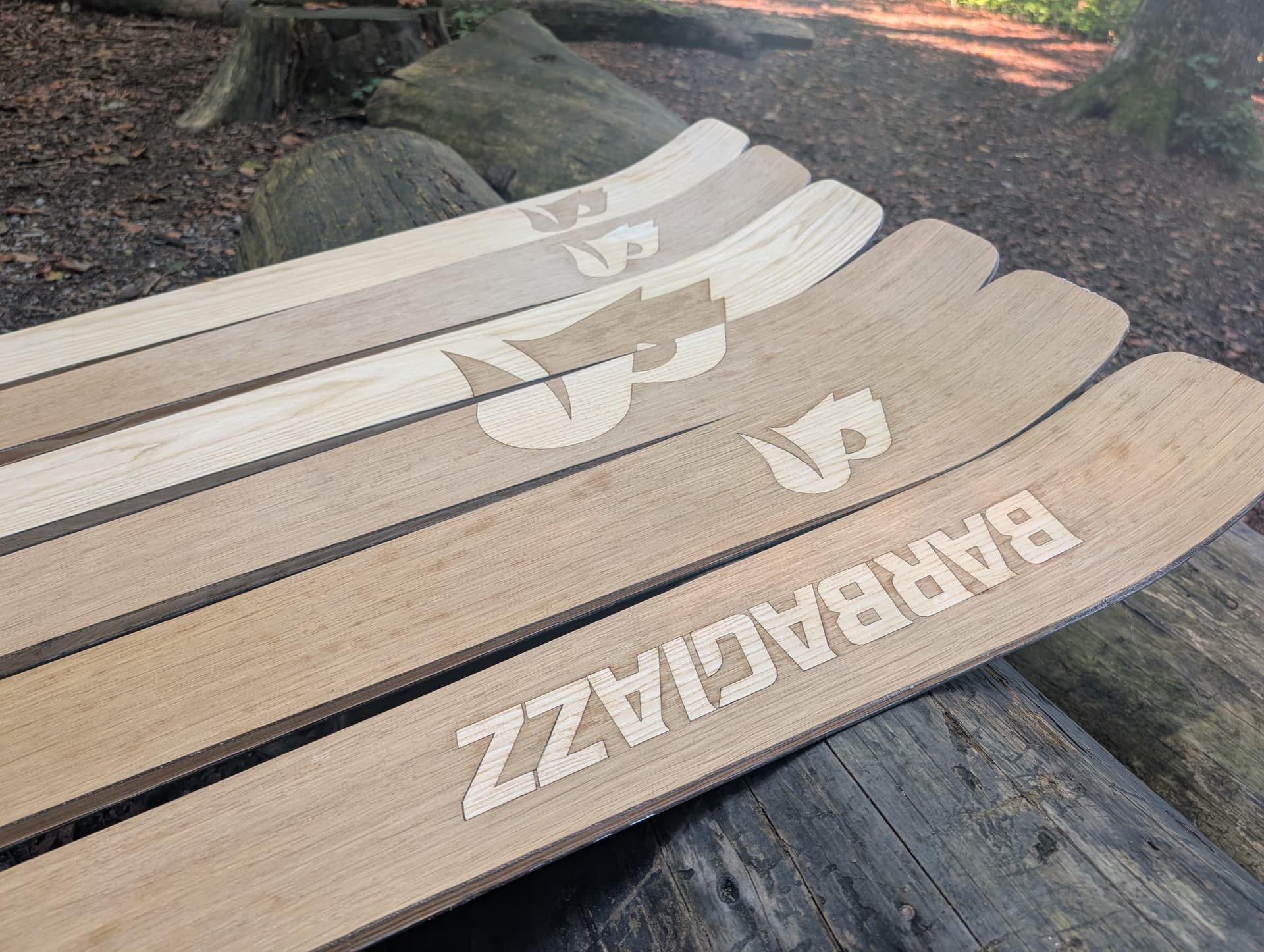

As suggested by some users in another post here a few pics of the skis I make.
I use the LR4 for:
  • cutting the core
  • cutting the base with a drag knife
  • cutting the tip and base inserts from a cork sheet with a drag knife
  • cutting the drawings of the top sheet with a laser module
I also use(d) the LR4 to build the adaptable mold for rocker/camber that I use with a vacuum press.
I use FreeCAD for drawings and as CAM excepted for the laser cutting for which I use Inkscape with a specific plugin to generate GCode.

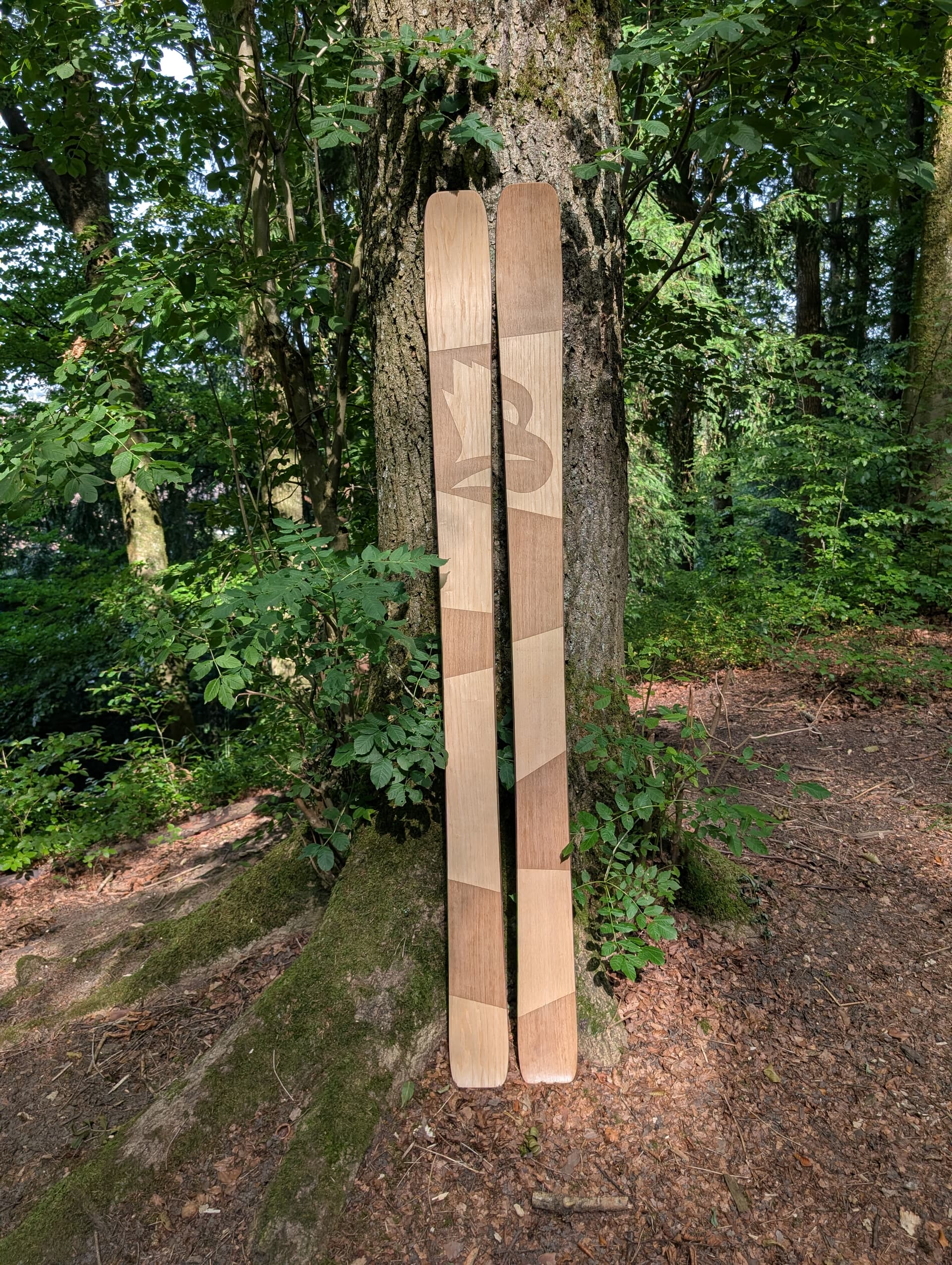

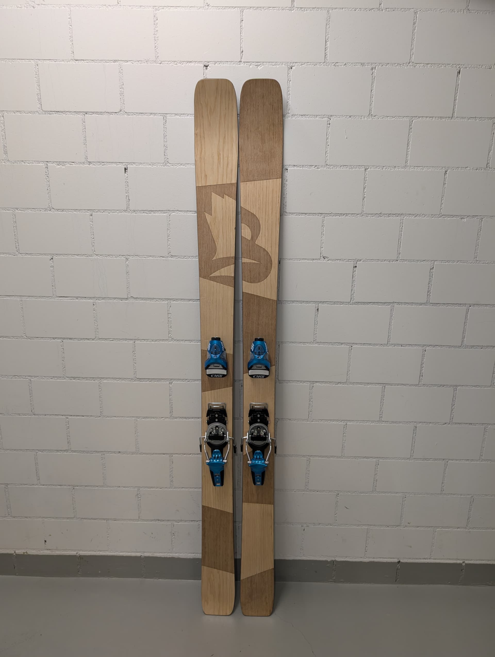

Aria 189 cm 141/114/130, the specific model below is made with a beech/poplar core and oak sidewalls. Topsheet ash/oak. I also make it full ash core and in 175 cm.
Here a picture with Look Pivot 2.0 18 bindings and CAST conversion
Here a few different topsheets
