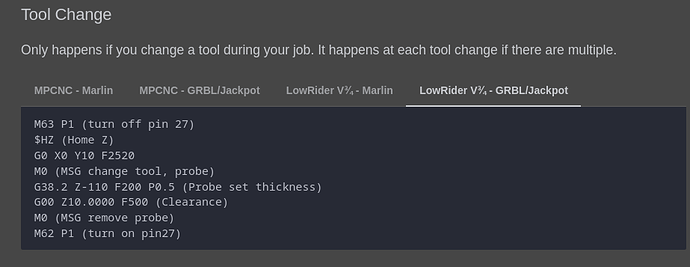

does anyone use freecad cam to generate gcode?
I have a problem with setting the tool change, it seems that $HZ is not recognized in the program.
I use grbl PP in Freecad
When I adding
I get an error
and after removing from snippet “Z home” line then the program is happy
any suggestion?

I haven’t tried FreeCAD CAM but $HZ (and anything starting with $) is FluidNC specific and not a GRBL command. It seems that it must be trying to parse it.

That’s the normal FluidNC tool change code from the V1 documentation. It just seems that FreeCAD doesn’t like the non-GRBL commands.

Worse, because if I replacing $HZ for #define HOMING CYCLE 0 (1<<Z AXIS) (grbl homing) it’s doesn’t working either

Right. I believe it requires some kind of code change to work with FluidNC. I’m not sure if that’s to FreeCAD or the GRBL post processor.

You are probably right, i think something should be done one FreeCAD side because grbl should support the $H command.

UPDATE
Kind of working but not working.
STEP support is really bad, it does everything for you but not good at all. You have 0 capabilities to change
WORK AROUND
main goal - tool change
manually put the code (modified code from the website) in NC files
(Begin operation: tool change)
(Path: tool change)
(tool change)
(Begin Custom)
(1turn off pin 27)
$HZ (home Z)
G0 X10.000 Y10.000
M0
(1turn on pin27)
(End Custom)
(Finish operation: tool change)

EDIT
Code need to be like this to be able to back to the workpiece
$HZ (home Z)
G0 X0.000 Y0.000 (powrot do poczastku wspolrzednych)
M0 (zatrzymanie maszyny)
G38.2 G91 Z-110 F200 P0.50 (Probe set thickness)
G90
G00 Z35.0000 F500 (Clearance)
M0 (MSG remove probe)
