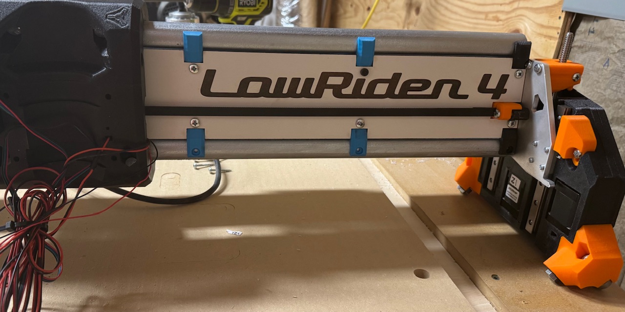

off topic, but where did you get that Lowrider IV font on your strut? that looks wild
@Neilp, are you hunting down this post? Doug’s strut with KnightRider vibes is pretty sweet.
i was curious about maybe lasering it onto my struts. Looks awesome. i found the logo dxf, and understand doug had to do huge edits to the ‘Comfortaa’ font to make that one.
@Neilp Feel free to use any of what I shared! I’d be thrilled to my design work utilized!

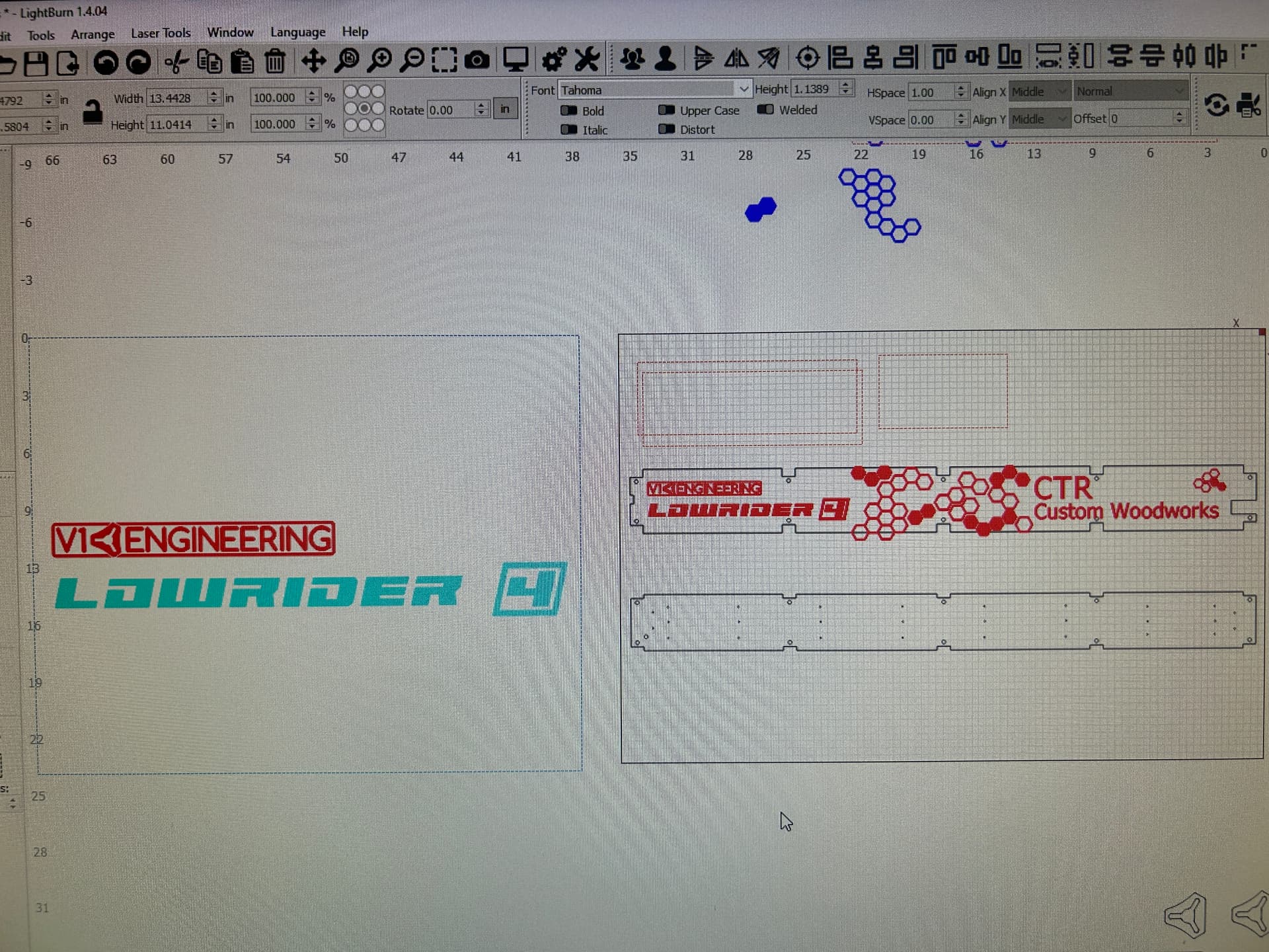

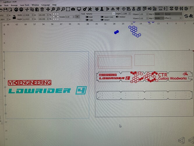

After @azab2c pointed me in the right direction, I stayed up until 3 adding your and Ryan’s logos and nameplates to both my front strut AND a big engraving on my spoilboard (in lightburn). Can’t wait to get time in the CO2 to get these done.

Incase you/someone’s interested… shared custom strut with measurement markers and mini a LR4 diagram with holes for optic fiber light guides for the JackPot V1 endstop lights… https://github.com/aaronse/v1engineering-mods/tree/main/lowrider4/mods/aza-strut
Remember that there is a belt! It will cover a lot of your design, making it unreadable in pictures and videos. Ask me how I know. :sweat_smile:
The most important advice I can give, is to digitally draw the X belt across that artwork. If you cover up key elements with the belt you will regret it. Ask several how they know.. :slight_smile:
@Tokoloshe beat me to it… :slight_smile:
@Tokoloshe and @DougJoseph I hadn’t even considered that. Lol . Back to the drawing board
Thanks to you both
:100:, consider which Strut areas are obscured by the (slightly set forward…) X belt given the viewing angle(s) you care about. I designed with face on in-mind, but actually spend 99% of my time standing, and looking downward. I got dumb lucky for how dust shoe mod’s view port turned out. But, belt partially obscures the numbers when viewing from standing height…

Yeah, I blocked out the middle 8” for the core, it then added the honeycomb because I didn’t like the blank space. I’ll see that when the machine is working.
I completely blanked on the belt, so everything else needs redesigned, lol
