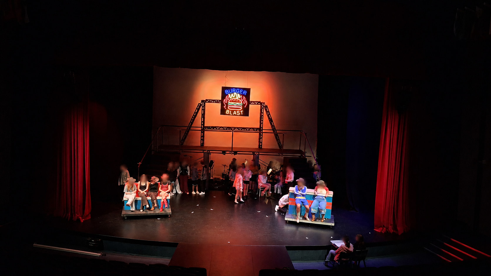

'Footloose' stage set

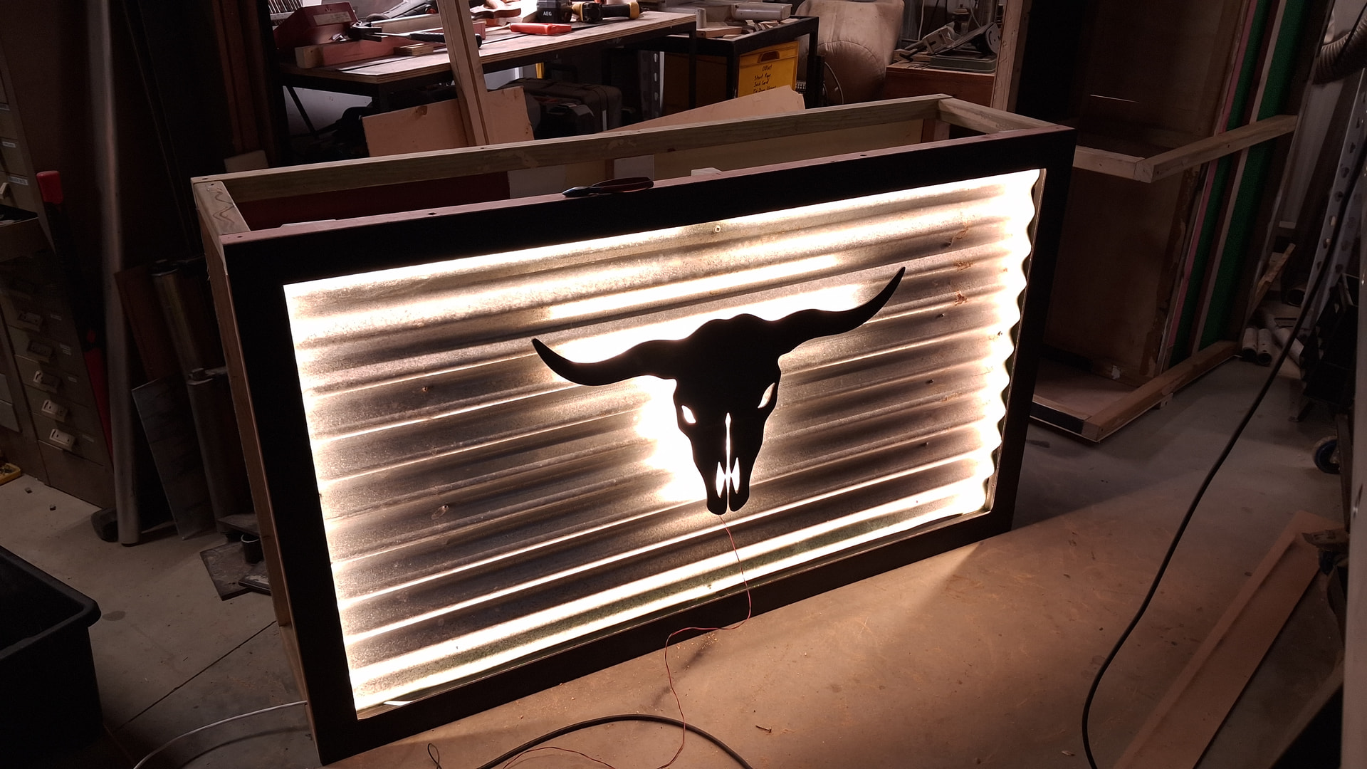

Built some set elements for a high school production of ‘Footloose: The Musical”

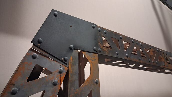

Key part of the set is a bridge structure - this one constructed of scaffolding with light ply trusses all cut on the LR4. Can recommend self adhesive googly eyes for rivet heads

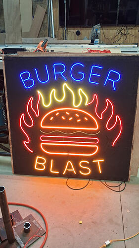

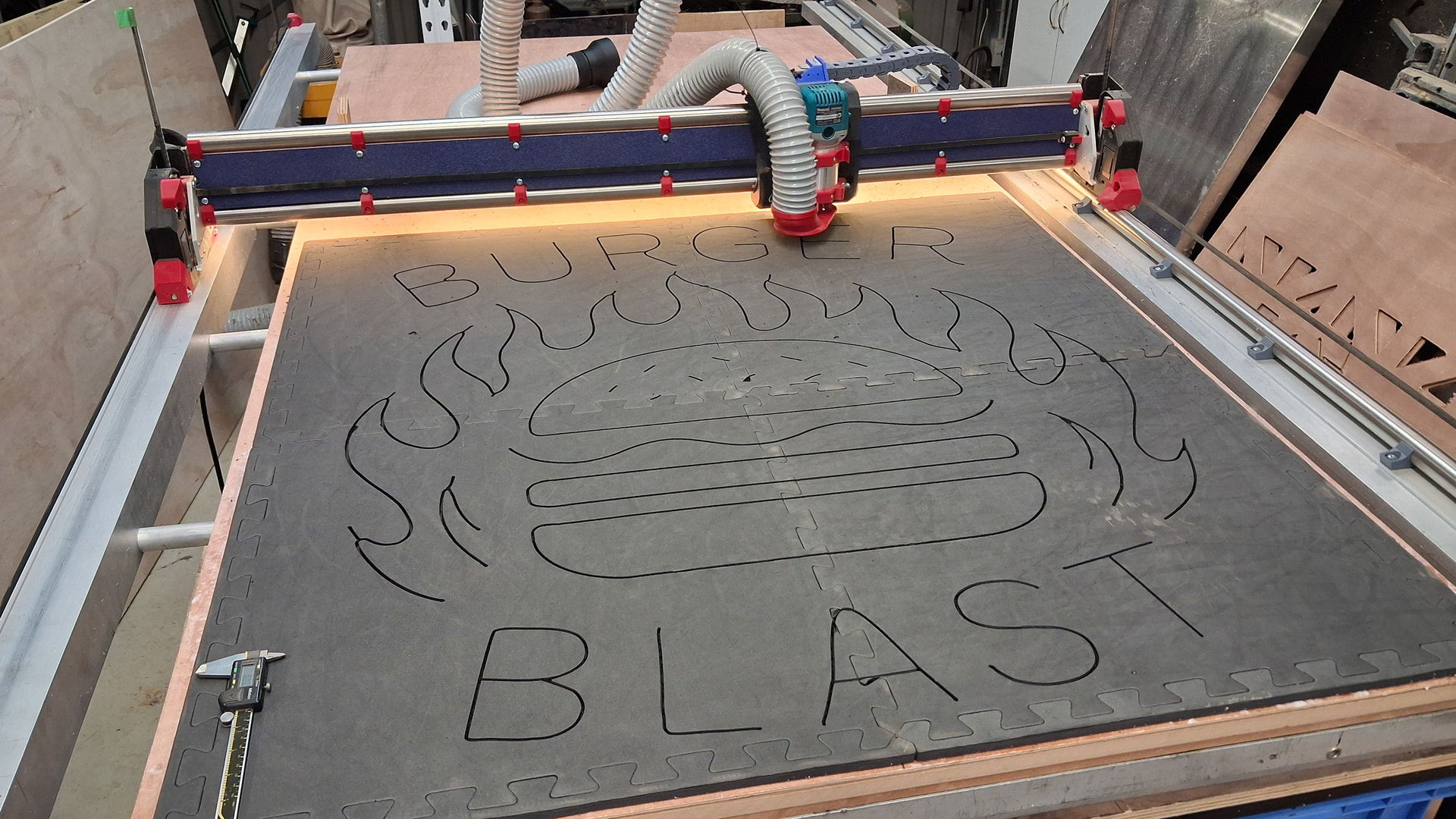

One scene is in a burger joint - fake neon sign using EVA foam gym mats as the base for the LED strips. Design brought into Estlcam as a SVG & cut with a 4mm endmill to allow a press fit for the 5mm LEDs

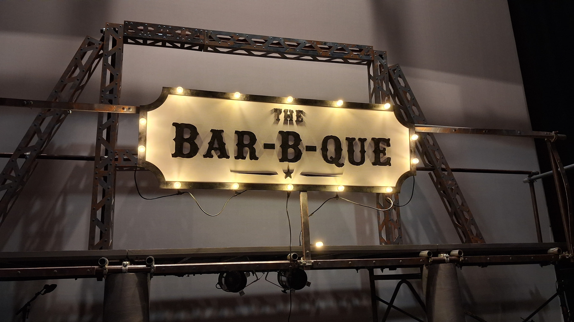

Bar scene bar leaner - sure I could have cut it with a jigsaw but so much better watching the LR4 do its thing.
Build pic of the bar sign - again could have been painted on the backboard but easier/quicker/better to have lettering cnc’d. Black frame is in 4 parts to save material. Holes for festoon fittings cut through frame & backboard using modifications of the same dxf so all line up.
Fun project - almost ended up looking for ways to use the cnc rather than use power tools.

The EVA foam sign trick has my head abuzz with thinks!
Love the use of eva foam for ledneon. I have used acrylic for it, but that is difficult to fit at times. The foam would be more forgiving and cheap. Great idea!
Out of necessity really - was initially going to use extruded polystyrene insulation board but due to cost & availability EVA was the better option.
It’s laminated to a light plywood enclosure that houses all the wiring and give a frame to fly it from
