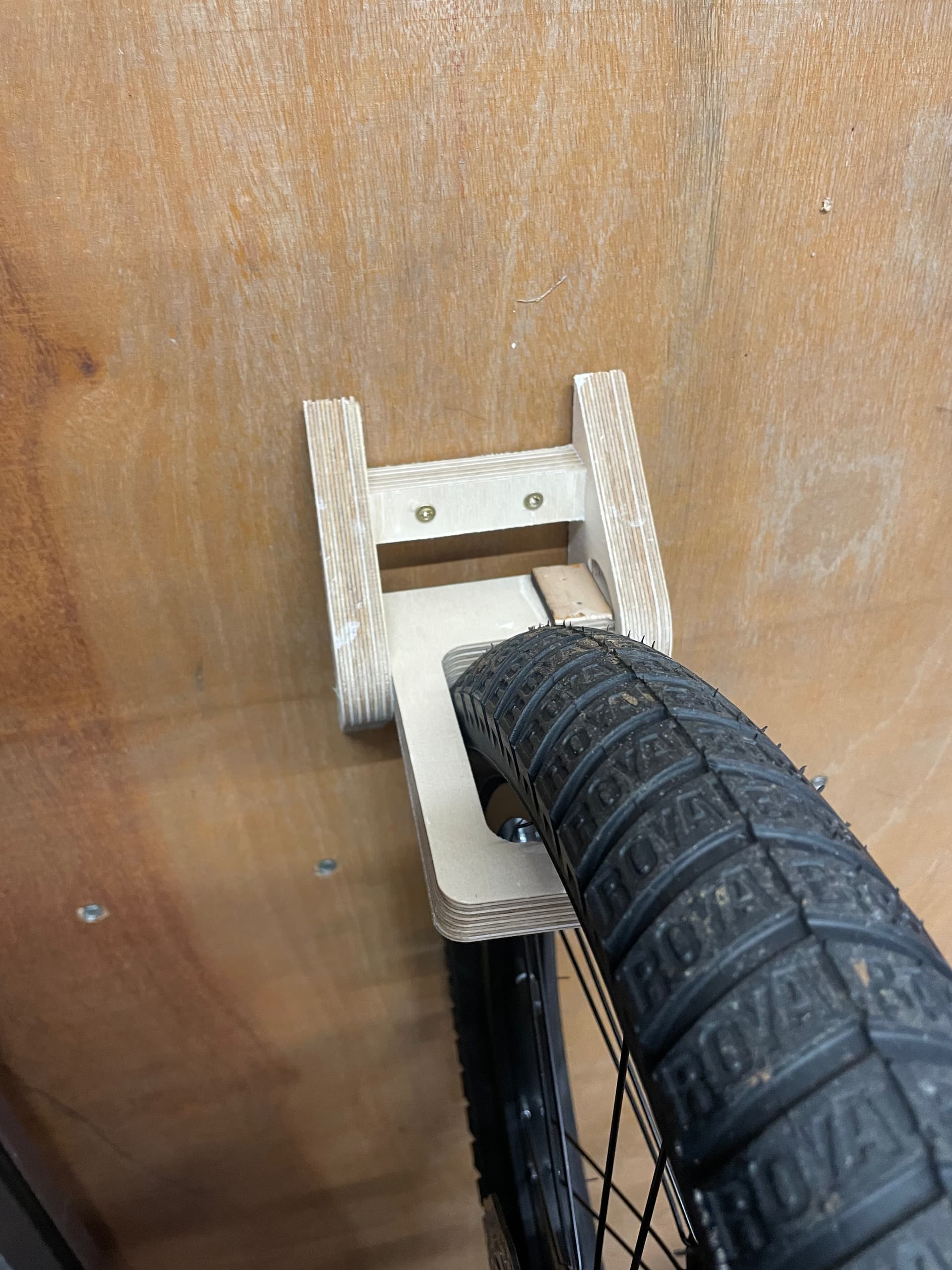

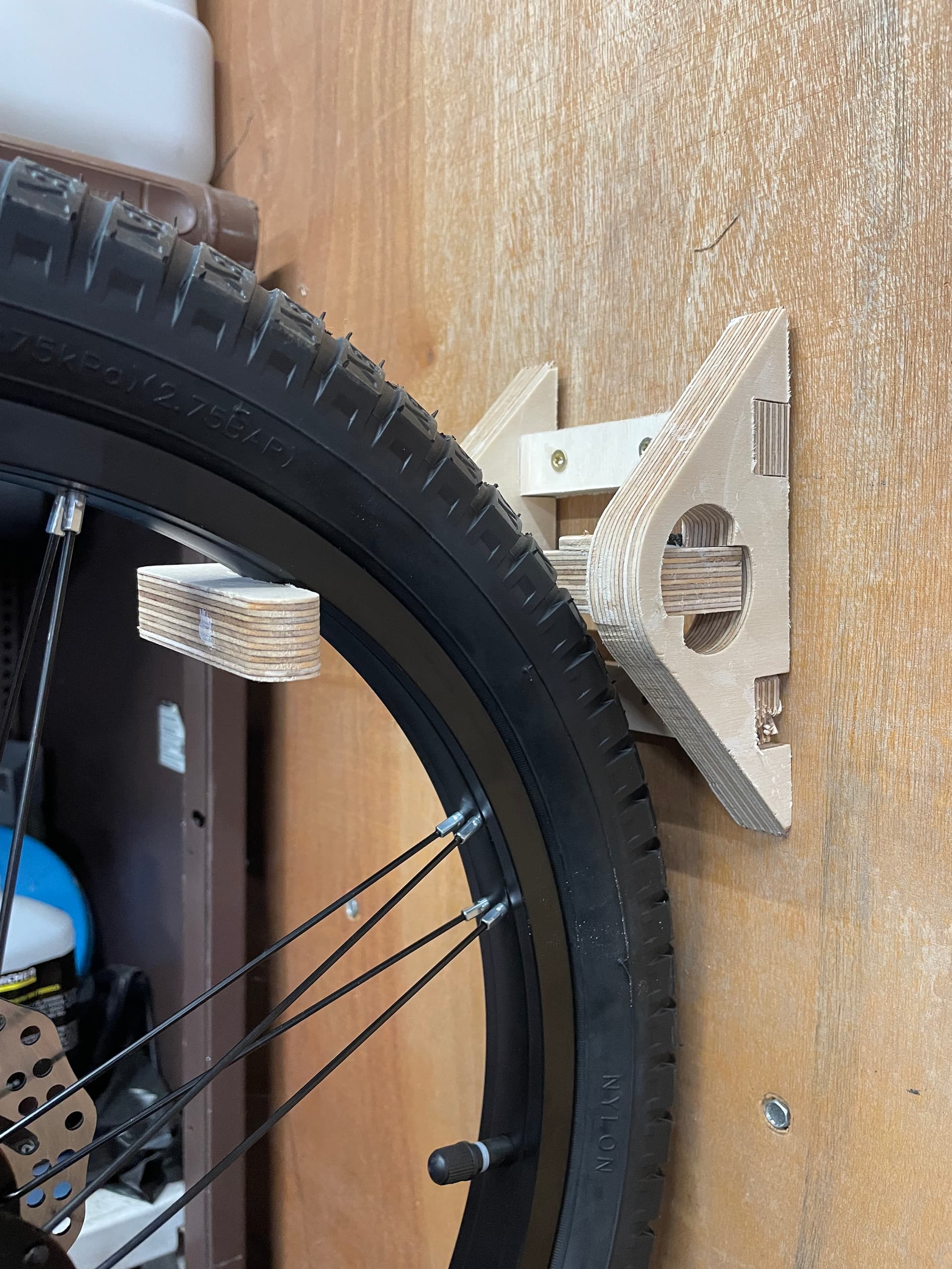

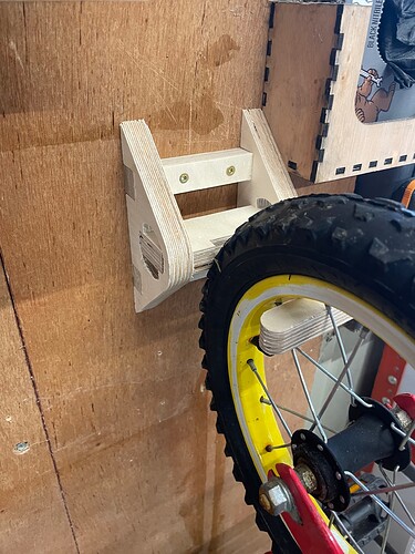

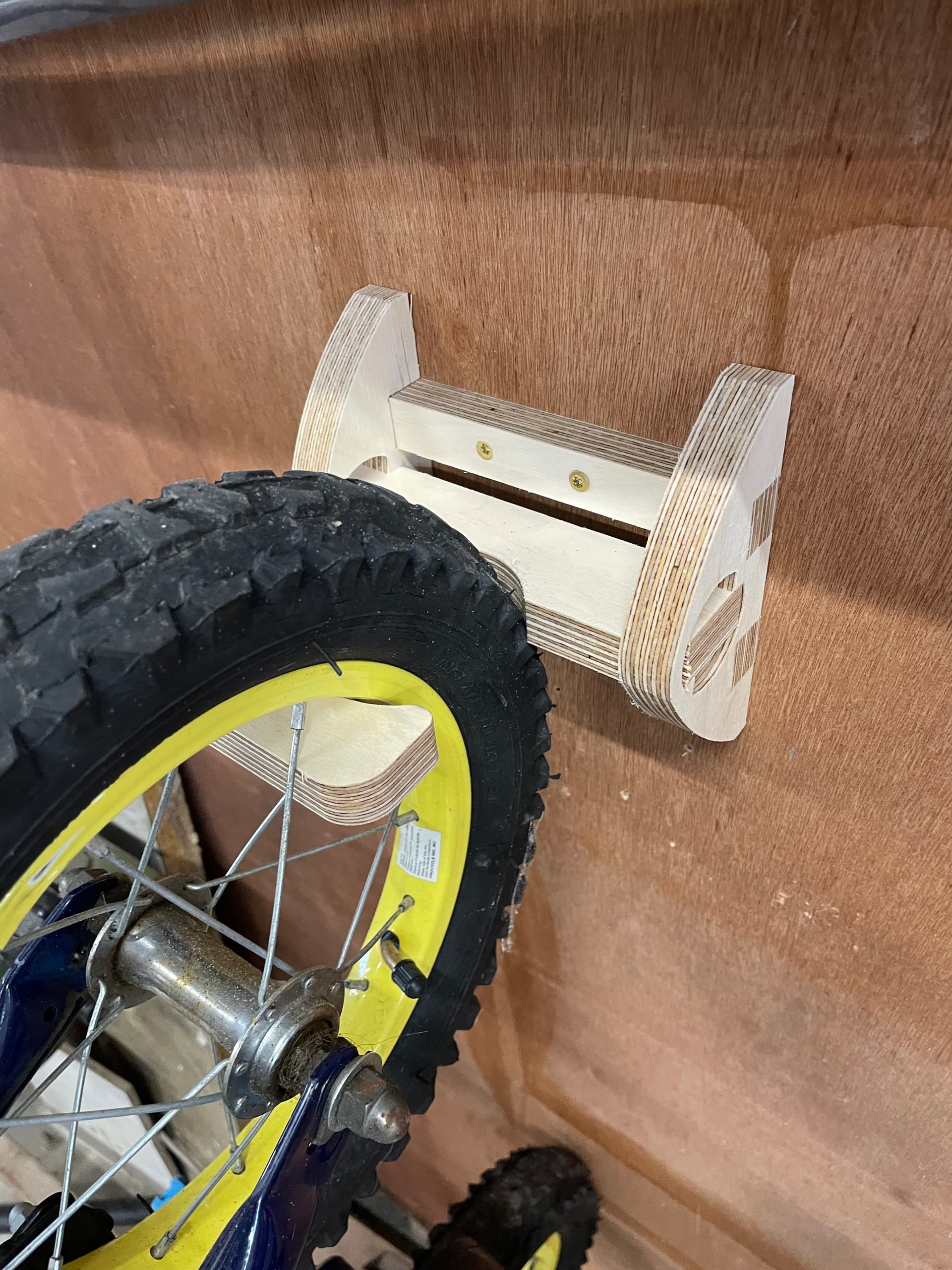

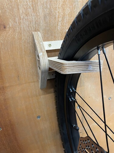

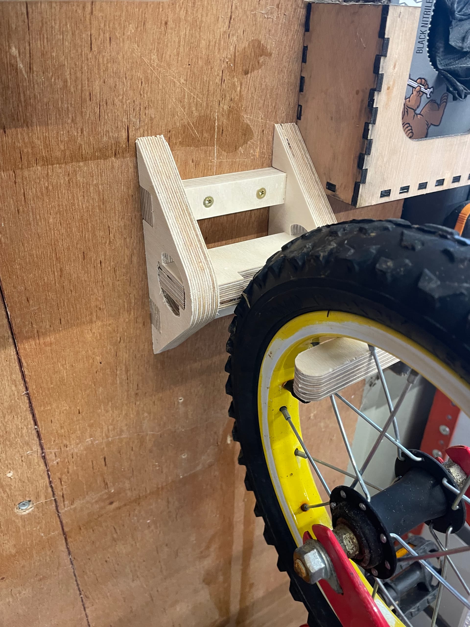

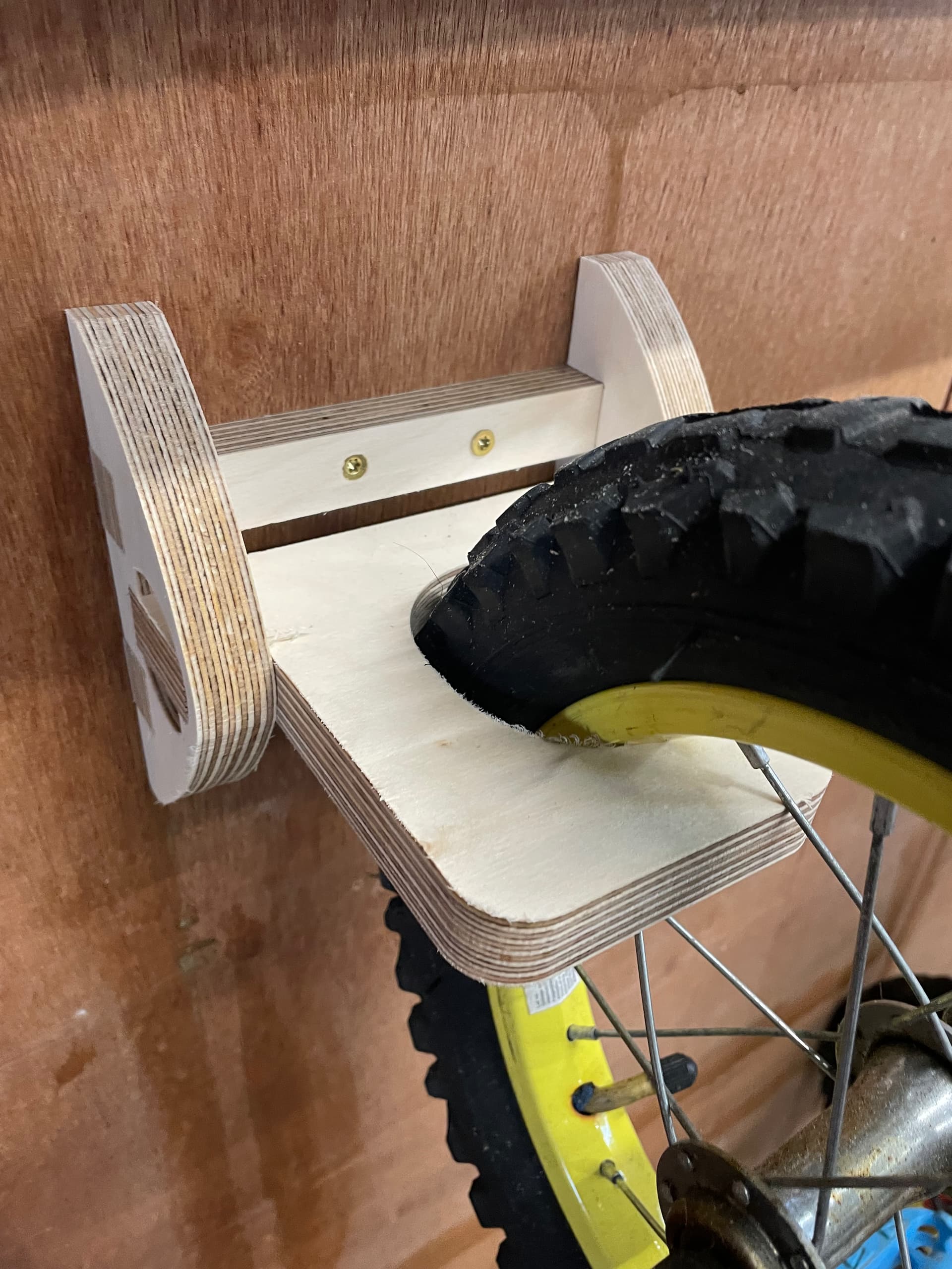

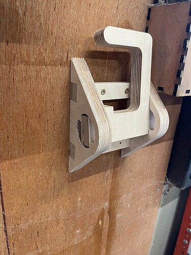

Reusing the captured ring hinge again I made some bike wall storage hooks. A 15 minute cut each. I don’t like the way the hook flexes so I both shortened it and also thicker it a bit to try and compensate. Got a couple more bikes to hang so there’s nothing wasted.

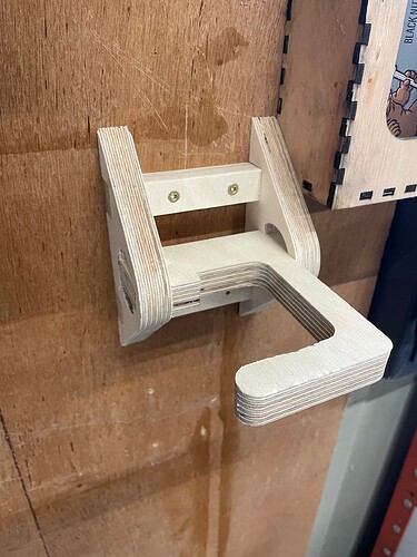

I made the hook a bit thicker and rounded off the back corners. You can see in the first ones I did there is some tear out in the acute corner angles, this solves that.
I’ve also been told that a coat of wax will help preserve them and reduce wear.
