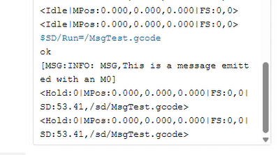

I did a screen recording with a simple test gcode program and captured some frames to show here. The gcode I ran is
M0 (MSG This is a message emitted with an M0)
M0 (MSG And this is another message)
M30

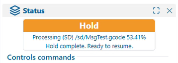

After pressing the Run button on the uploaded gcode file, I see
and about a second later it changes to
and stays that way until I hit the Resume (play) button.
The message also appears in the Terminal panel, but quickly scrolls out of sight as the terminal gets updated with repeated “Hold” lines.

The Status in this area only reports whatever status is being returned to the UI from the firmware. M0 is just an informational message, and does not set it to a certain state.
The Terminal is, well, just a terminal, so as new info messages come in, it will scroll off. This can somewhat be controlled by how often you have updates coming, but there’s not much there that can be done.
This, unfortunately, is the world we live in where the UI and the firmware are developed in a completely disconnected way.
This is likely going to be your best option for what you want
