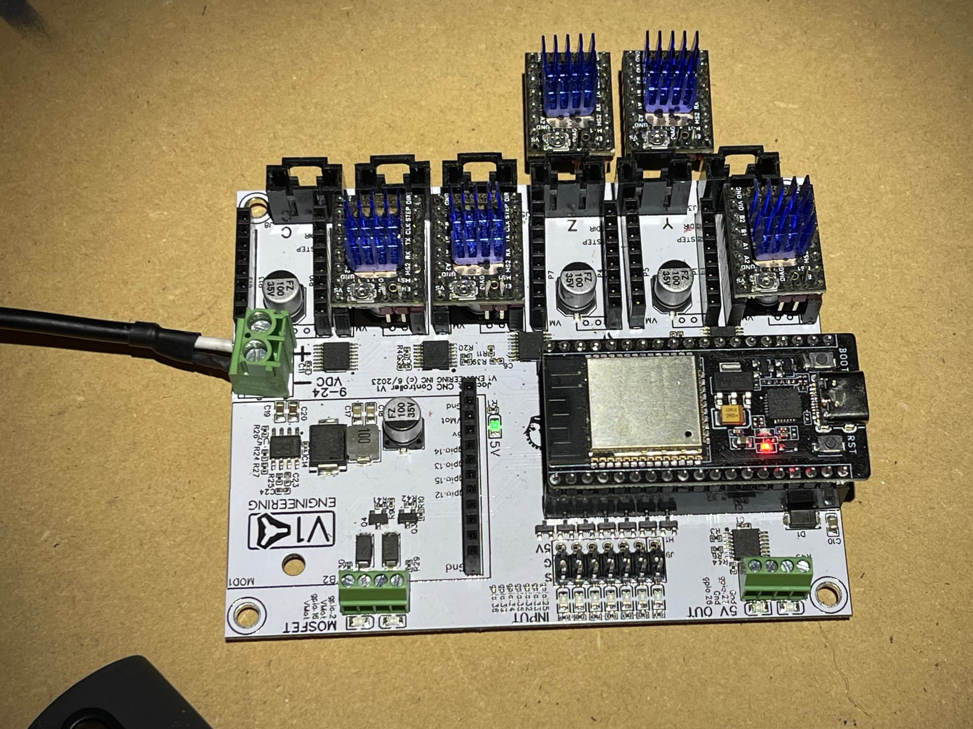

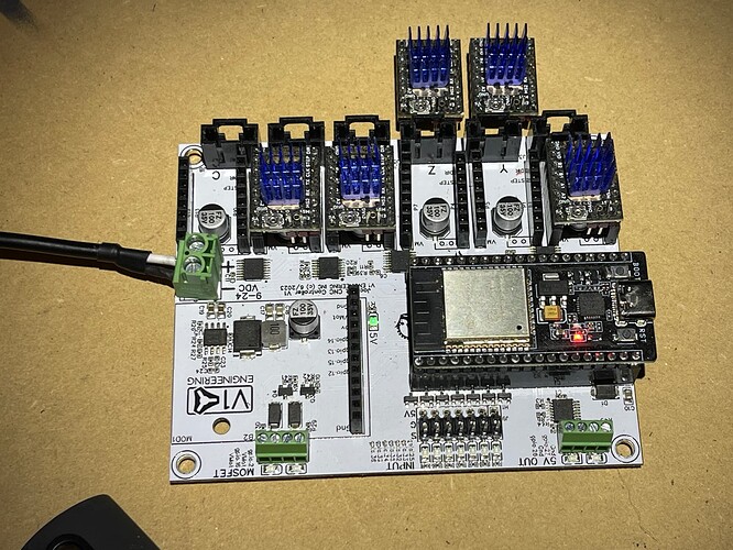

As requested, this is the “good” configuration that boots.
I have looked at the Jackpot and ESP32 board with my microscope. I know Ryan tested it too. I don’t think there is anything physically wrong with the board or the drivers.

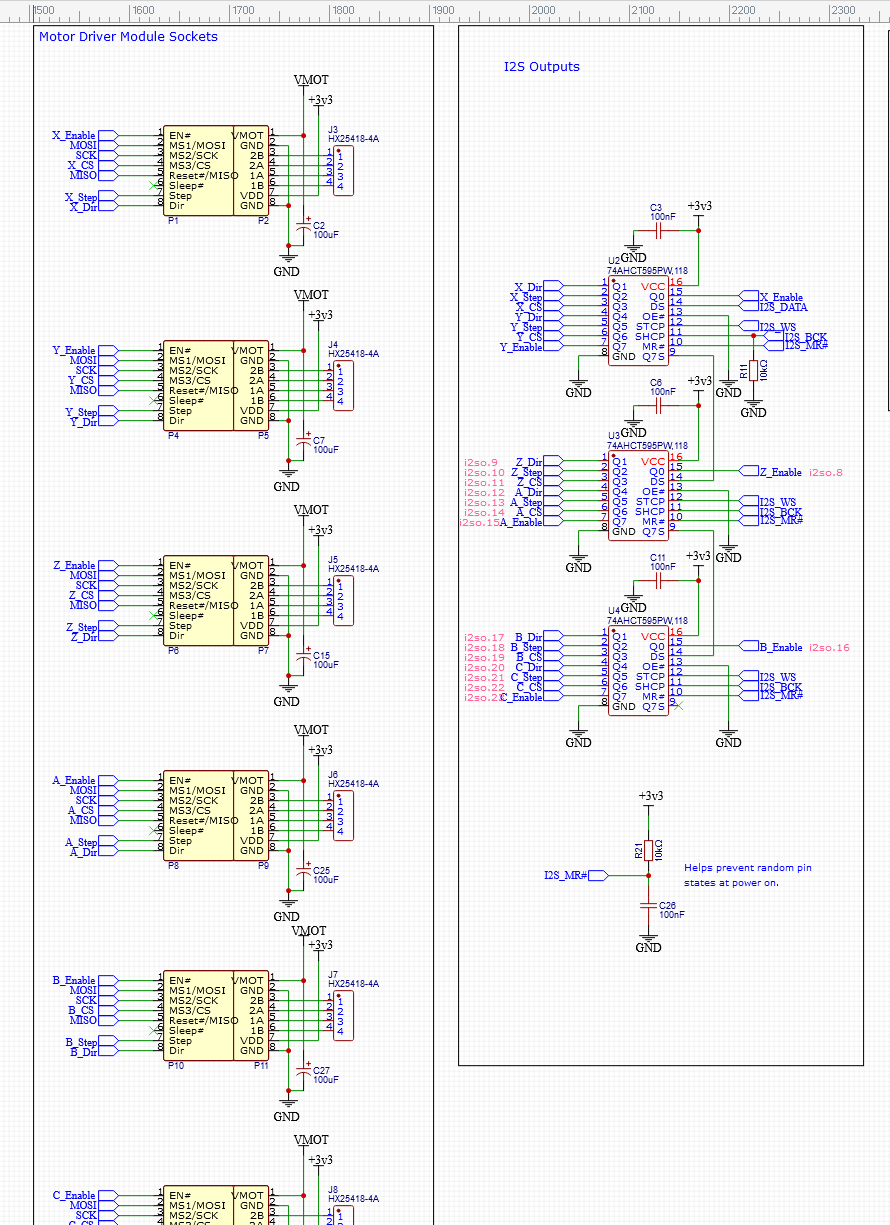

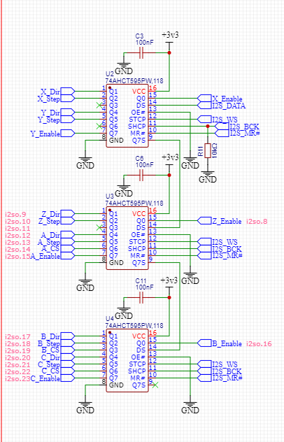

@vicious1 - Looking at your schematics, the pink IO Definitions aren’t present on U2 like they are on the others.

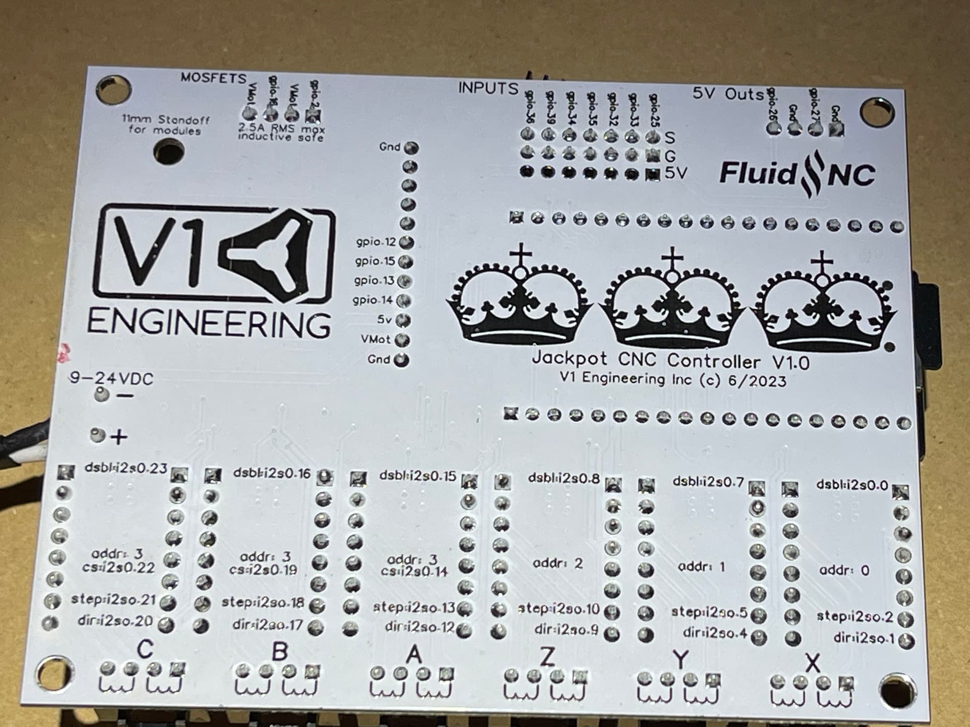

From the bottom of the board, The first (X) driver uses S0.0, s0.1, and s0.2. It then jumps over to s0.4, so.5, s0.7 for the Y driver, and s0.8 , s0.9 and s0.10 for Z.
What are s0.3, s0.6 used for? Do you remember discussion before in the design cycle about why Q3 and Q6 were floating and whether they should be?

Nothing special about YZ, XY are shared and ZA are shared. Grounds and power are all good, ST UART is shared so why is X okay?
X uses the lower IO pins on the 74AHCT595PW118. Then there’s a pair of floating outputs interspersed with the control lines for the Y and Z. Y and Z don’t work at times (but only at some times).
Then all the rest use the MUX UART scheme, and there’s only one floating GPIO in the set of muxed drivers.
I think that whatever is happening here, it impacts the IO going to the Y and Z stepper drivers in some way that pisses them off, preventing booting far enough that the WiFI stack gets loaded. Probably this is impacting UART communication between FluidNC and the stepper drivers in Y and Z.
Is it the case that X, Y, and Z are all using distinct UART intefaces on the ESP32? (I’ll go look at the schematic again to verify) I wonder what the ESP32 looks like inside as far as references. Maybe this is actually a case of a defective ESP32 that’s been jacking with us in a really weird way.

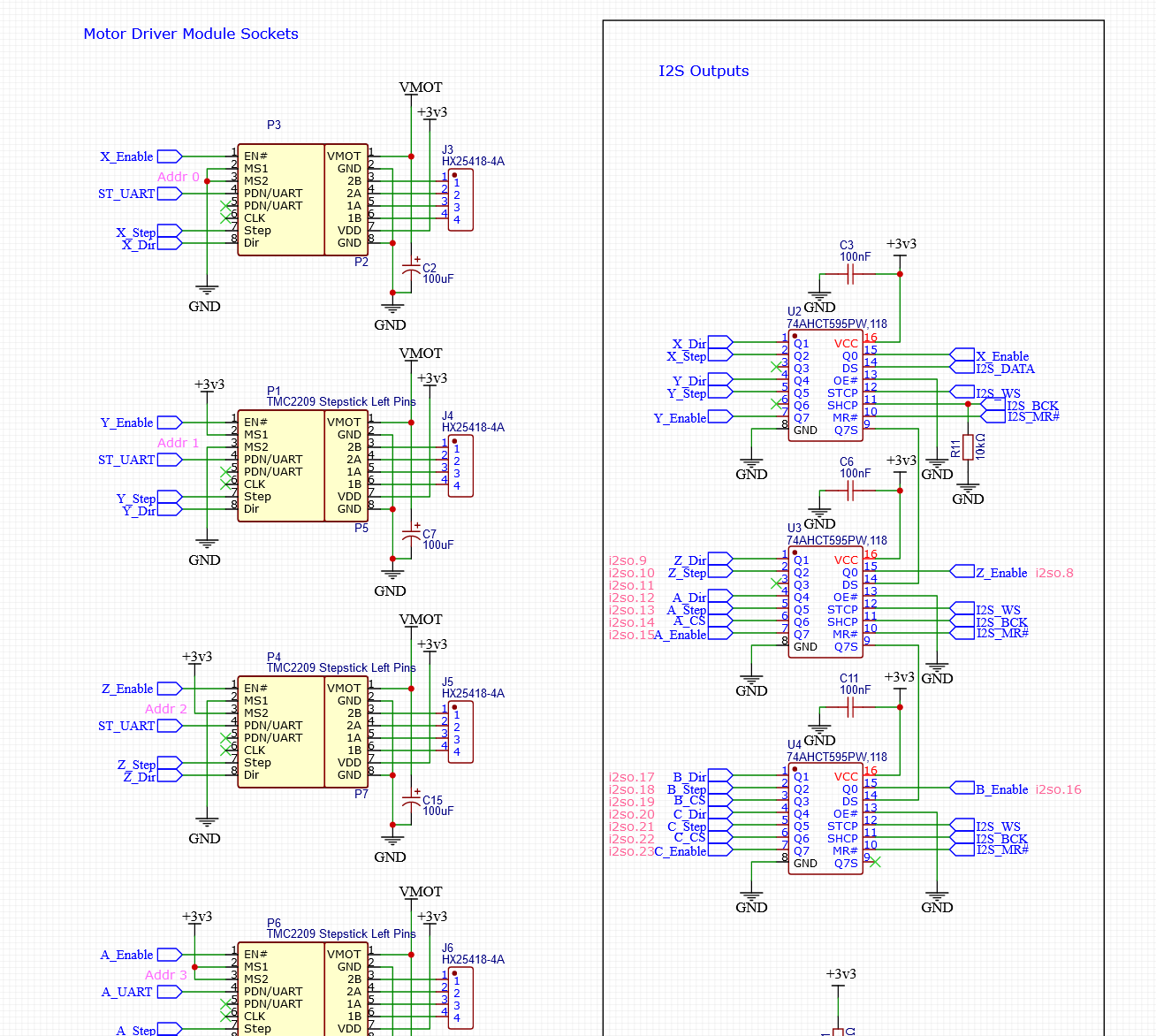

I honestly think it was just because before the multiplexing it made the layout easier. The UARTs were set up with more room. Someone else asked about the floating part and it doesn’t matter on those chips (from what I remember).
Previous unreleased board we made.
They look to be unused CS pins the layout was not changed much.
No XYZABC all use one channel.
The ST_UART pin they all share is connected to gpio-0 with a resistor…Mitch does not like that but I assume that is from the 6 pack as well. The resistor is there but it is a boot pin…but if that was a thing X would mess with it as well
I see that now. I see in the schematic that the TMCs also have floating pins. Too many short little unterminated antennas on these floating pins, perfect to pick up noise in a busy RFI environment. Noise to mess up serial communications, or noise to set them into oscillation.
I don’t like it either, but I suspect it’s because that is also the BOOT pin, the resistor is there in case the user pushes the BOOT button.

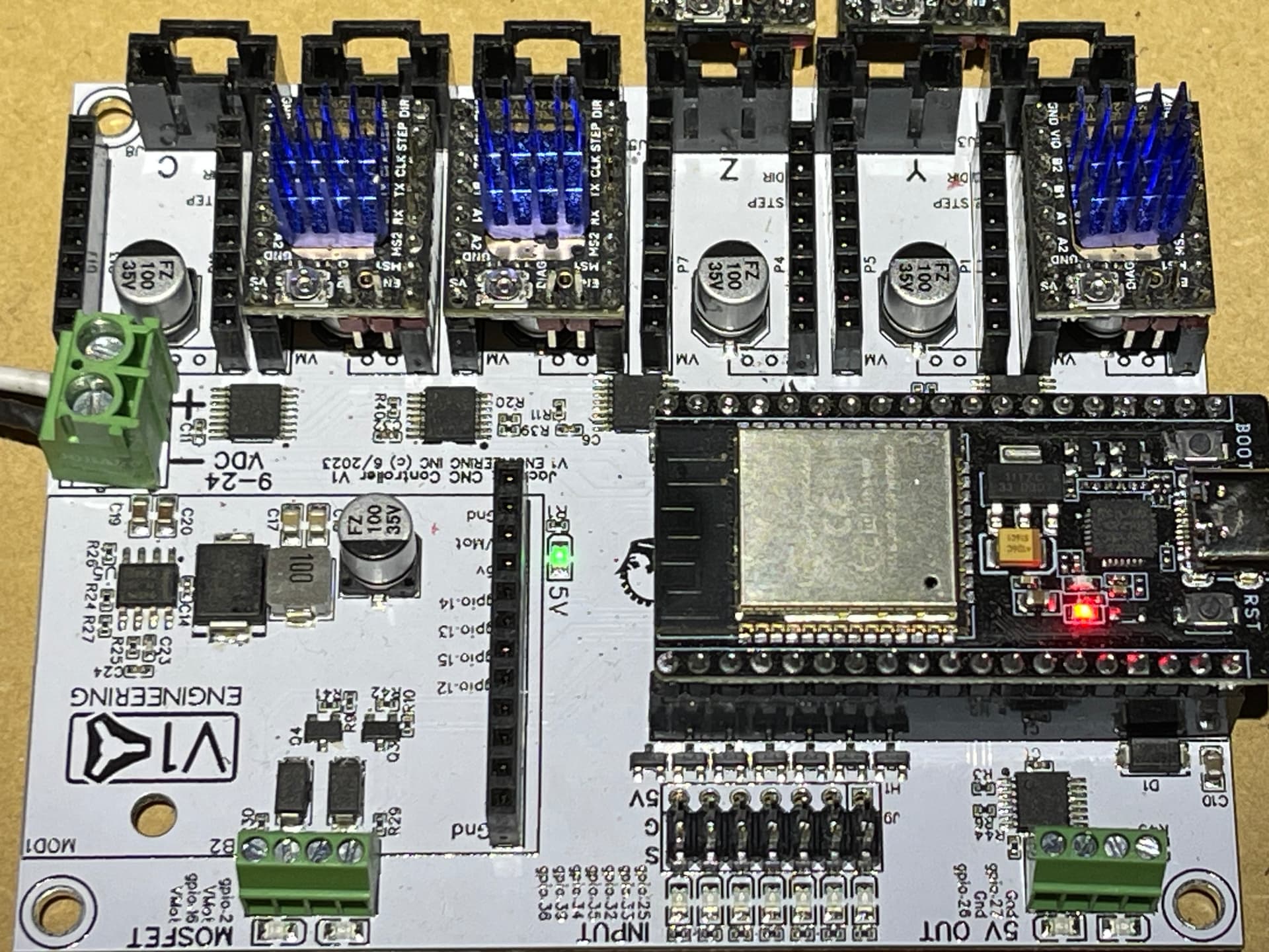

OK - this is interesting. I’ll show my work below. (now switched to XYZABC designations)
Summary - Only one of the X, Y, Z spots can be occupied. A, B, and C can all be occupied without changing the behavior.
Testing method - (X only, X+Y, X+Z, X+A, X+B, X+C, X+AB, X+ABC then Y only etc.)
If only X is occupied it boots. X also boots with A, B, C
If only Y is occupied it boots. Y also boots with A, B, C
If only Z is occupied it boots. Z also boots with A, B, C
X + Y , X + Z, Y + Z all fail to boot. (These are the only combos that failed, although I did not test a failed combo with ABC.)
