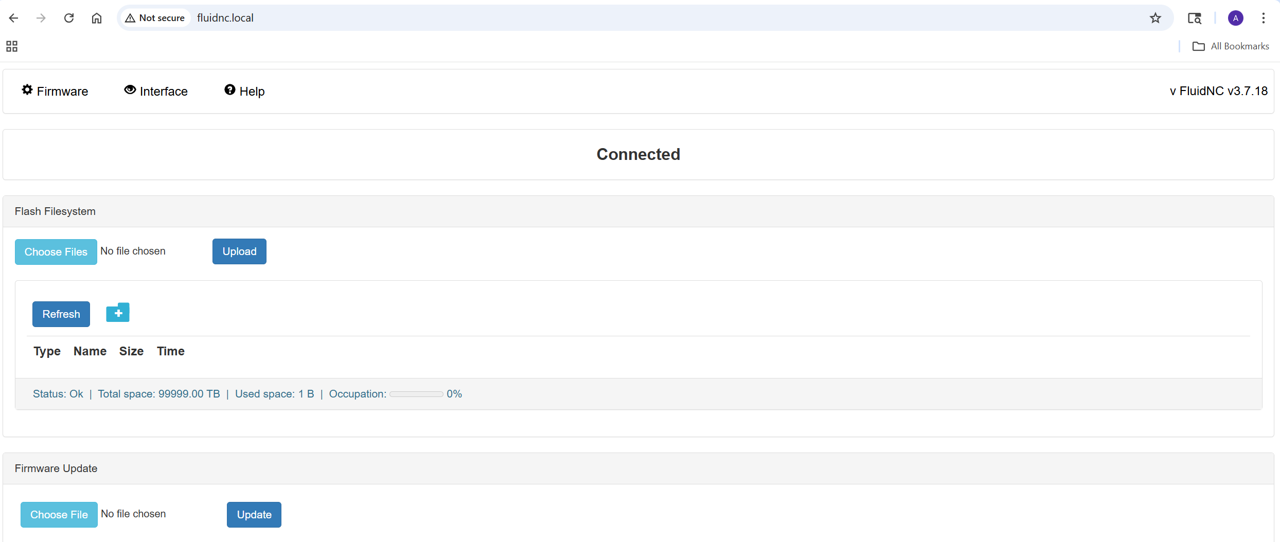

FluidNC is not showing normal interface when I connect to it
This is all that I see when I connect to jackpot, any idea how to get back the normal inteface?
You are missing the web interface files.
You need to upload the index.html.gz for either WebUI 2 or WebUI3
You can download a version from GitHub, or you can use the web installer at installer.FluidNC.com to copy one over when flashing.

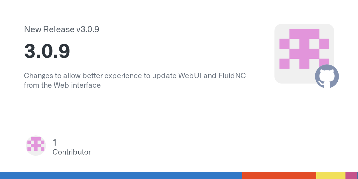

Latest WebUI 3 is here
I see you are running 3.7.18. It might be worth upgrading the firmware to 3.9.9 anyway, then you can get the interface fixed at the same time.
The new WebUI3 has probably not been tested with the old versions of the firmware.
If it’s been a while, I presume you were probably running WebUI2 before.
Sounds good. I have whatever version that it was shipped out with back in Oct 2024. I’ll try upgrading it tomorrow.
