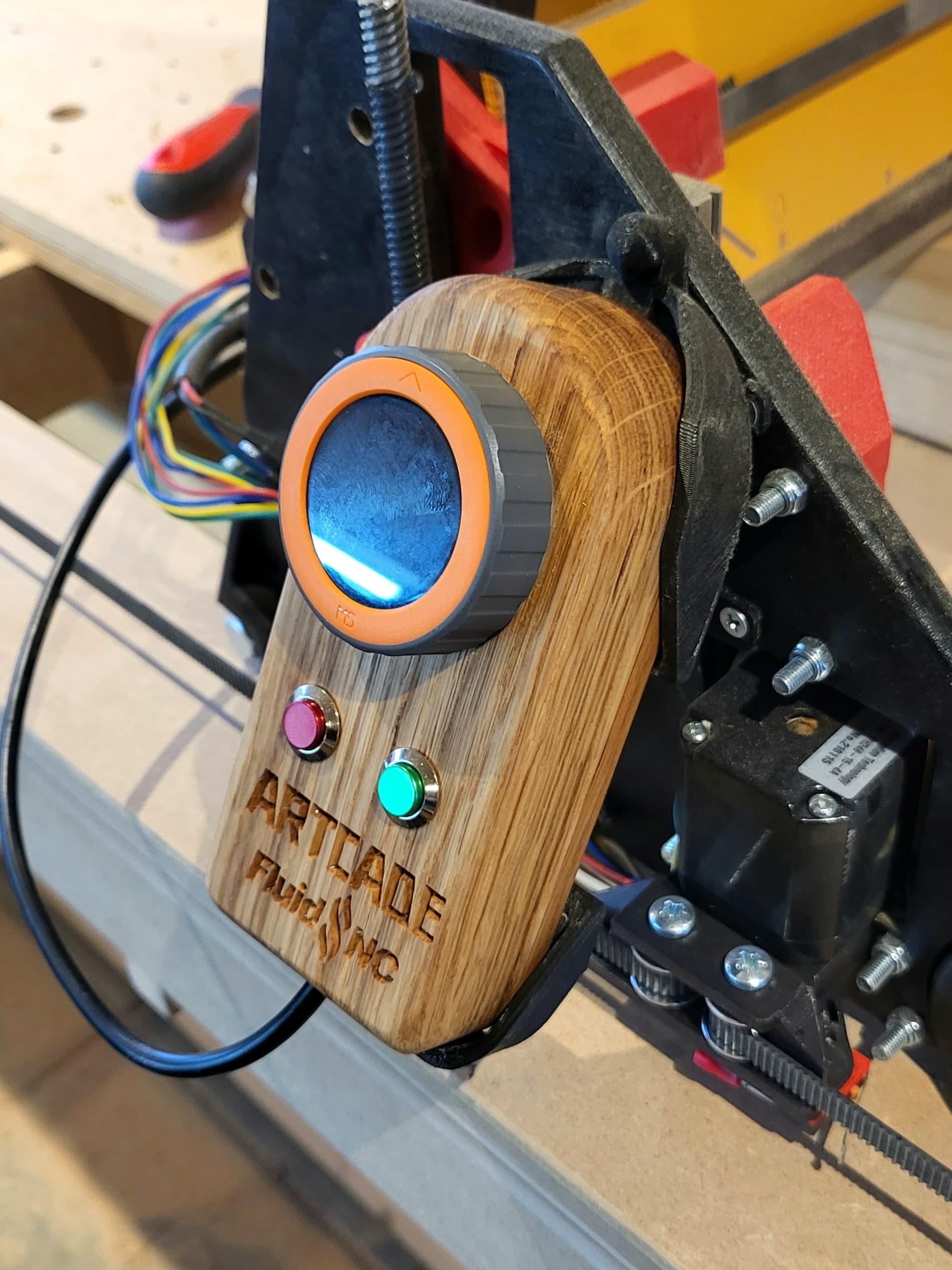

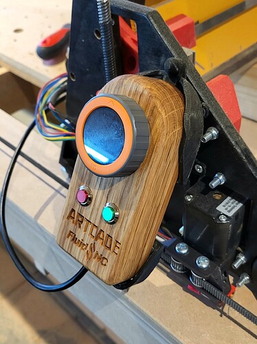

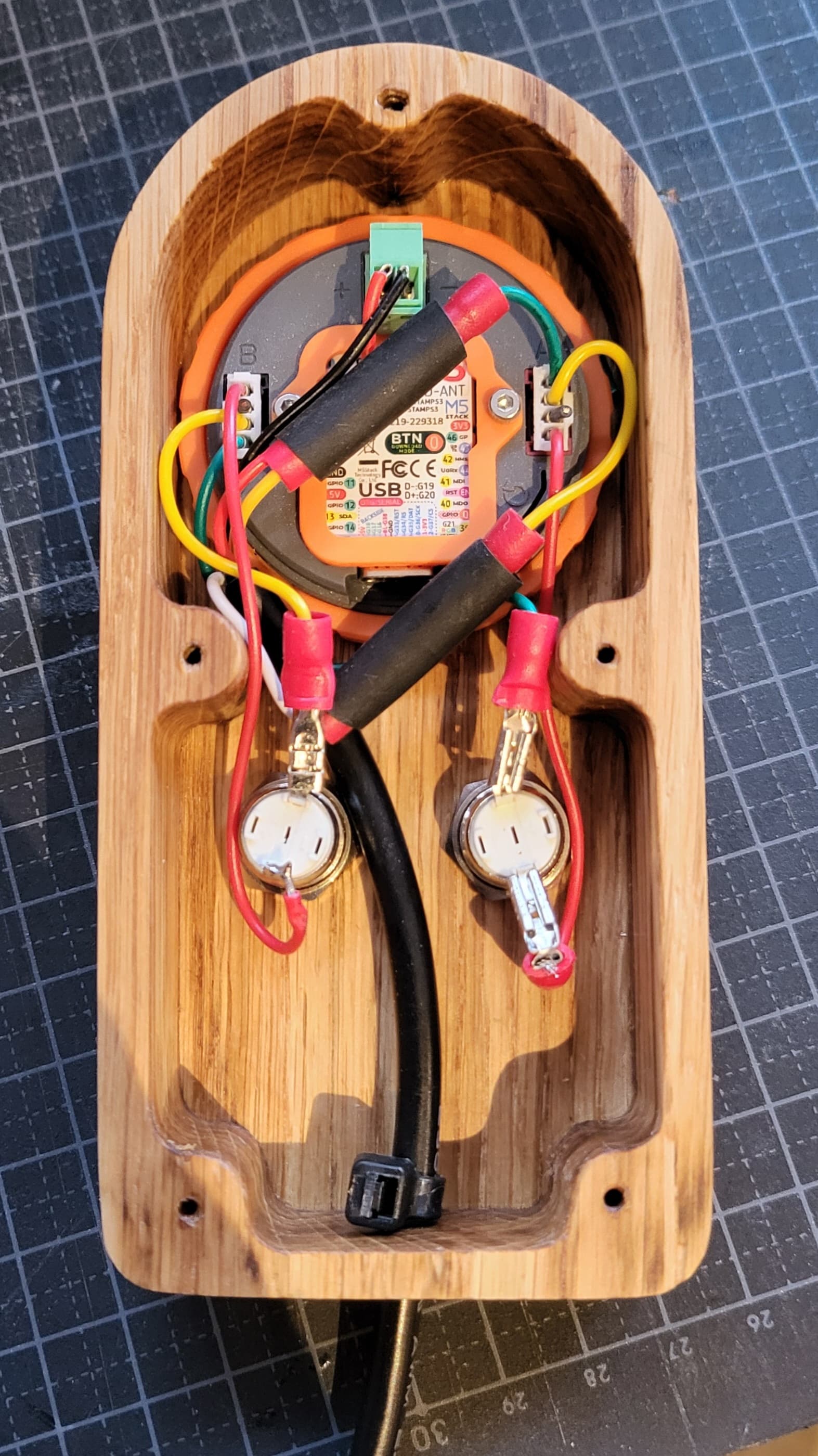

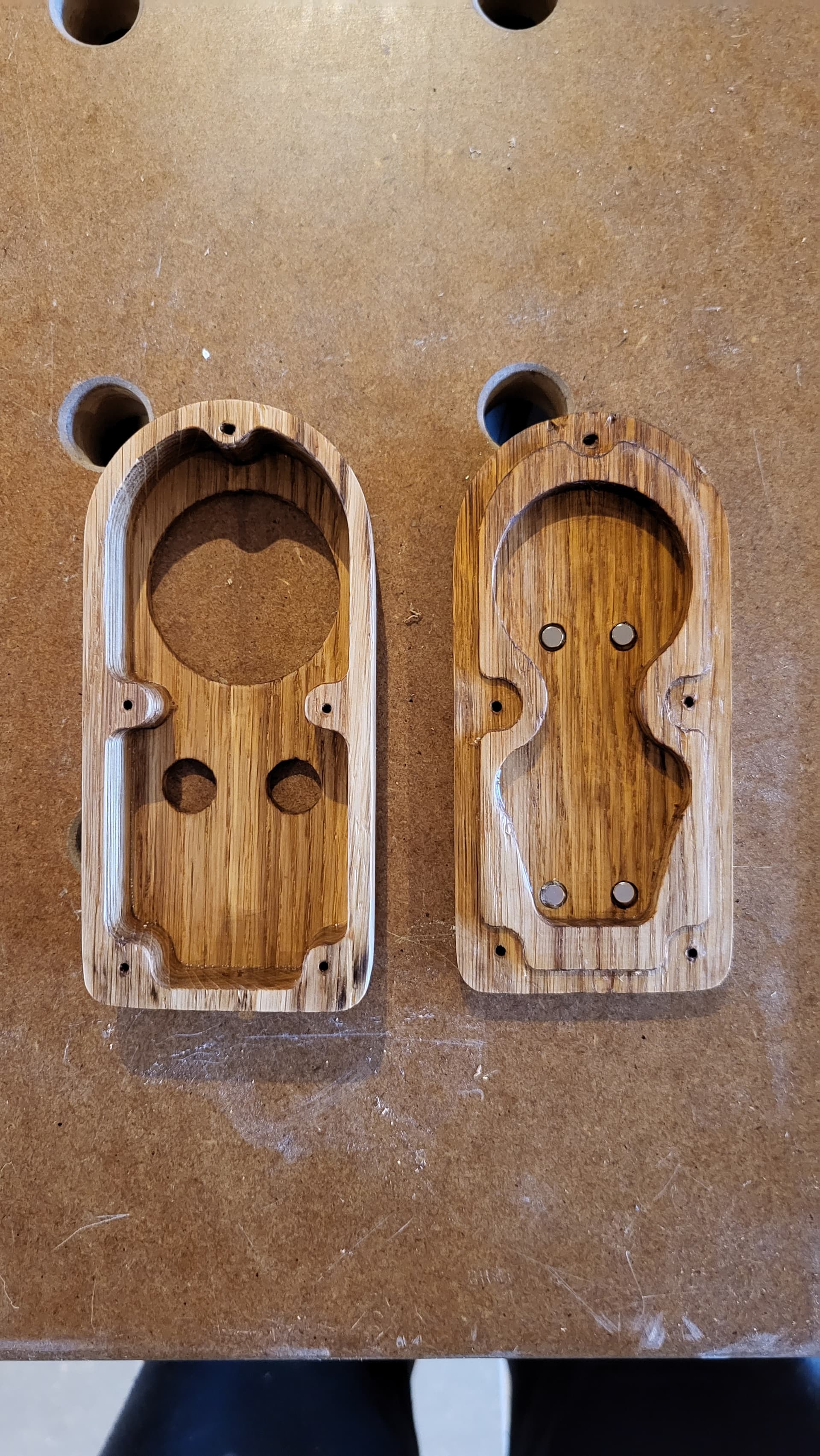

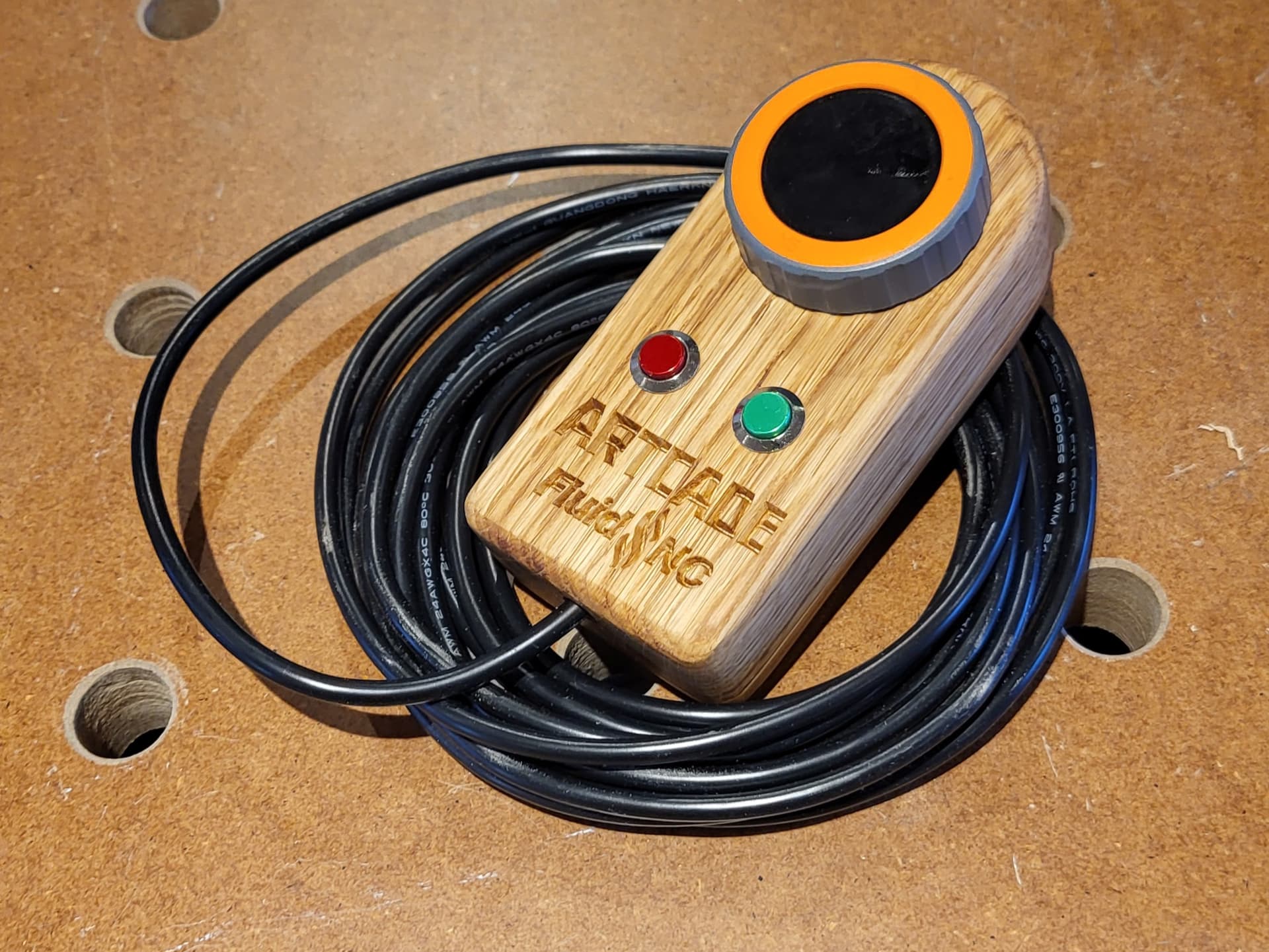

I made one to that fits Doug’s Cradle, made of oak.
Now I just need to upload firmware and connect it to my lowrider.
This is my DXF file.
Fluid Dial fits design8studio cradle.dxf (54.3 KB)

Very nice! I haven’t figured out a cradle solution yet, maybe I’ll just toss my first one and make v2.0 from your dxf!

Looks awesome. Please consider posting this as a make over on the Printable listing for the cradle.
Yes, i will do that. but I designed it in vetric so i only have a dxf file to share and not a 3d model. but can probably find some time to make a model in sketchup at a later date.
I was mainly referring to the cradle, but you could post your DXF file(s) (and pics of the pendant case) in a “make” of the cradle, since you printed that, and it definitely qualifies as a “make.”
Also, you could post the cradle as a make, with the DXF file(s) and pics, and also post the DXF and pics as a “remix” of the pendant case… Not everything on Printables is a 3D model. There are various 2D resources there as well.
Done and done… I’ve made a post to your cradle and a remix of your case. :grinning:
Awesome, thanks!
