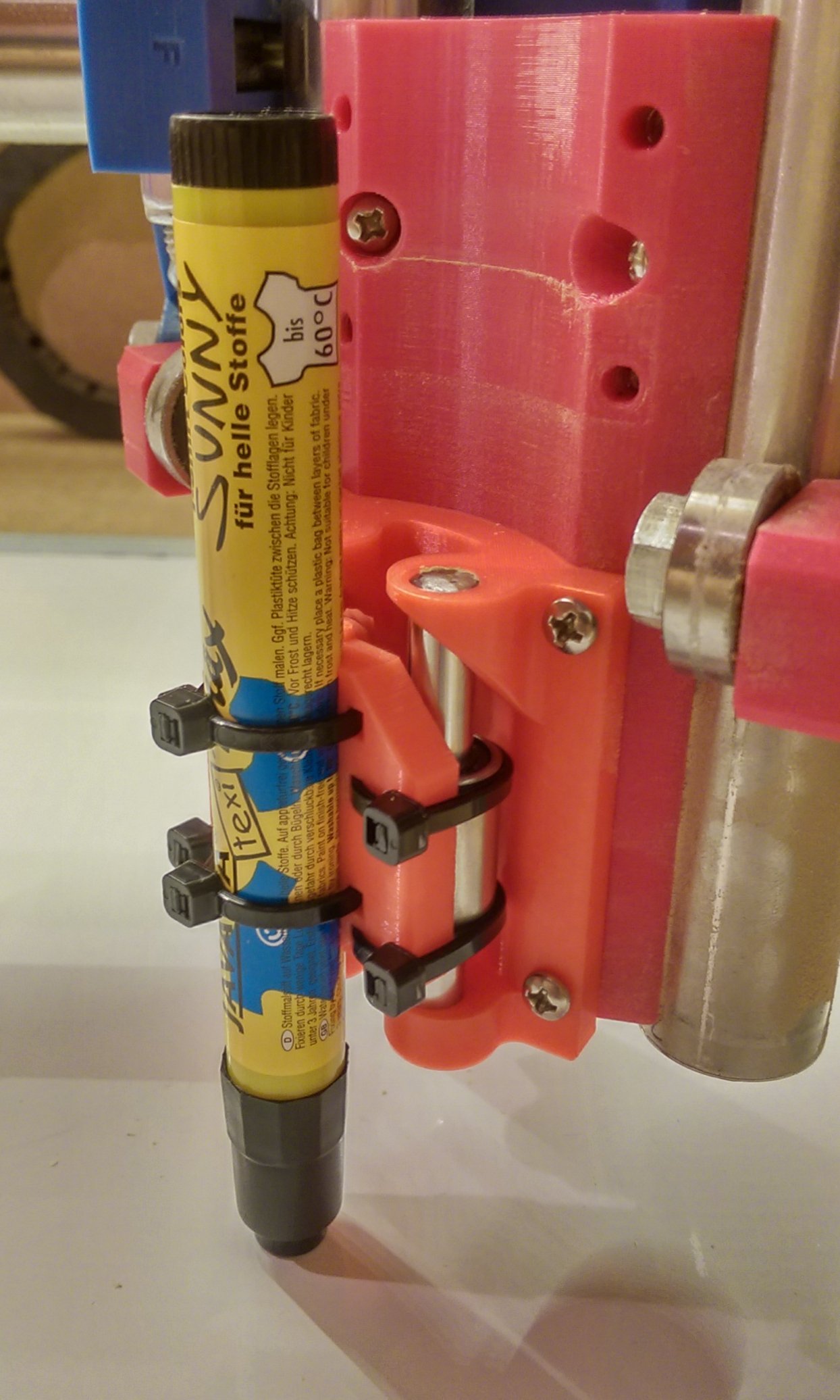

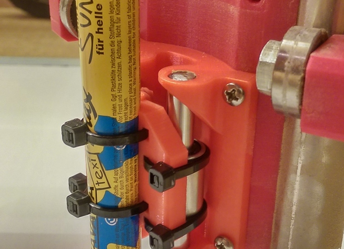

Hey, I made a floating z axis tool holder and you only need a rubber band, 2 LM8UU bearings, a bit of 8mm smooth rod and a 3d printer to make it :slight_smile:
https://www.thingiverse.com/thing:3234120
I use it to hold a textile marker, but I’m sure it could also be very usefull for drag knifes and other things.
