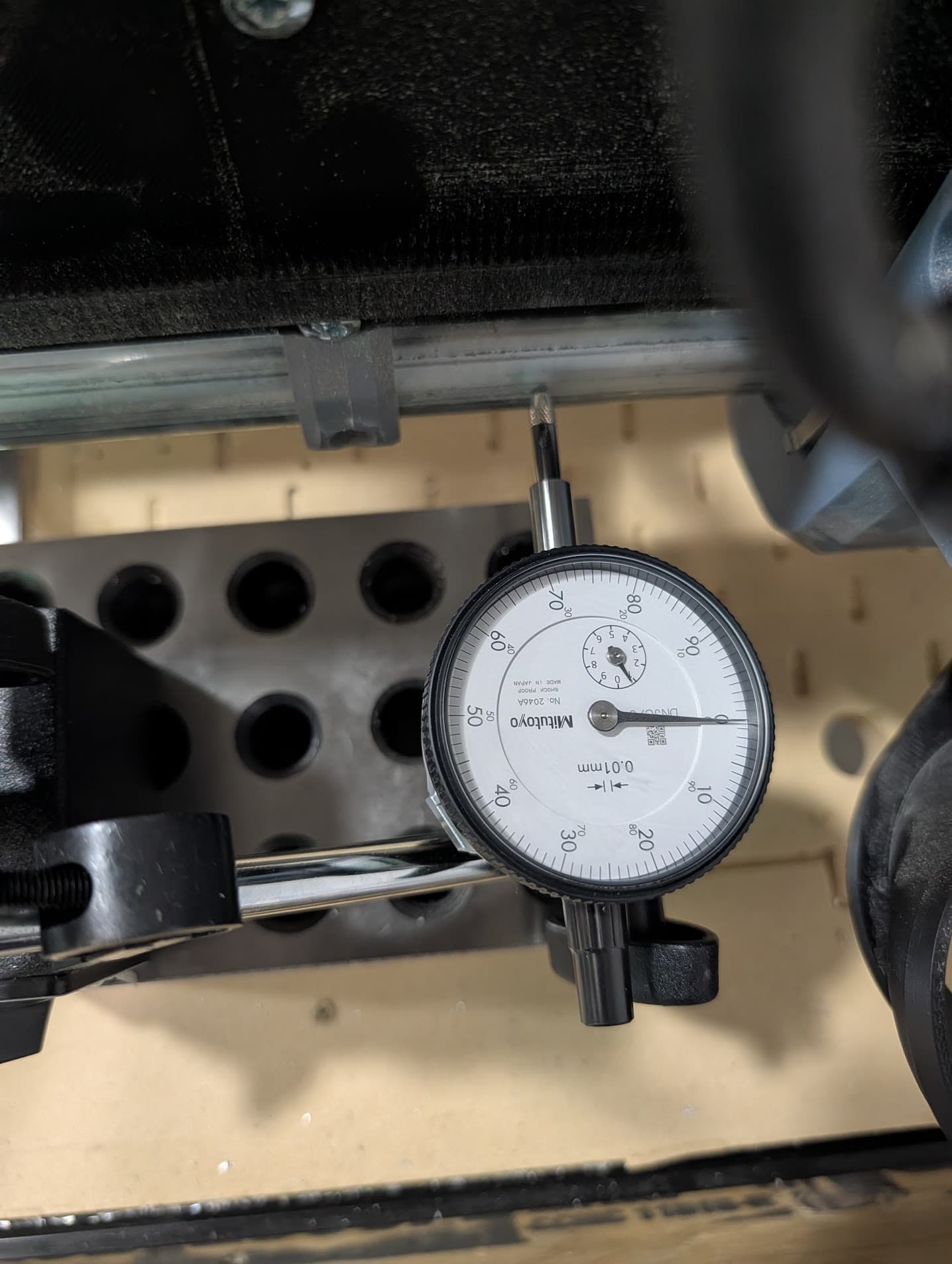

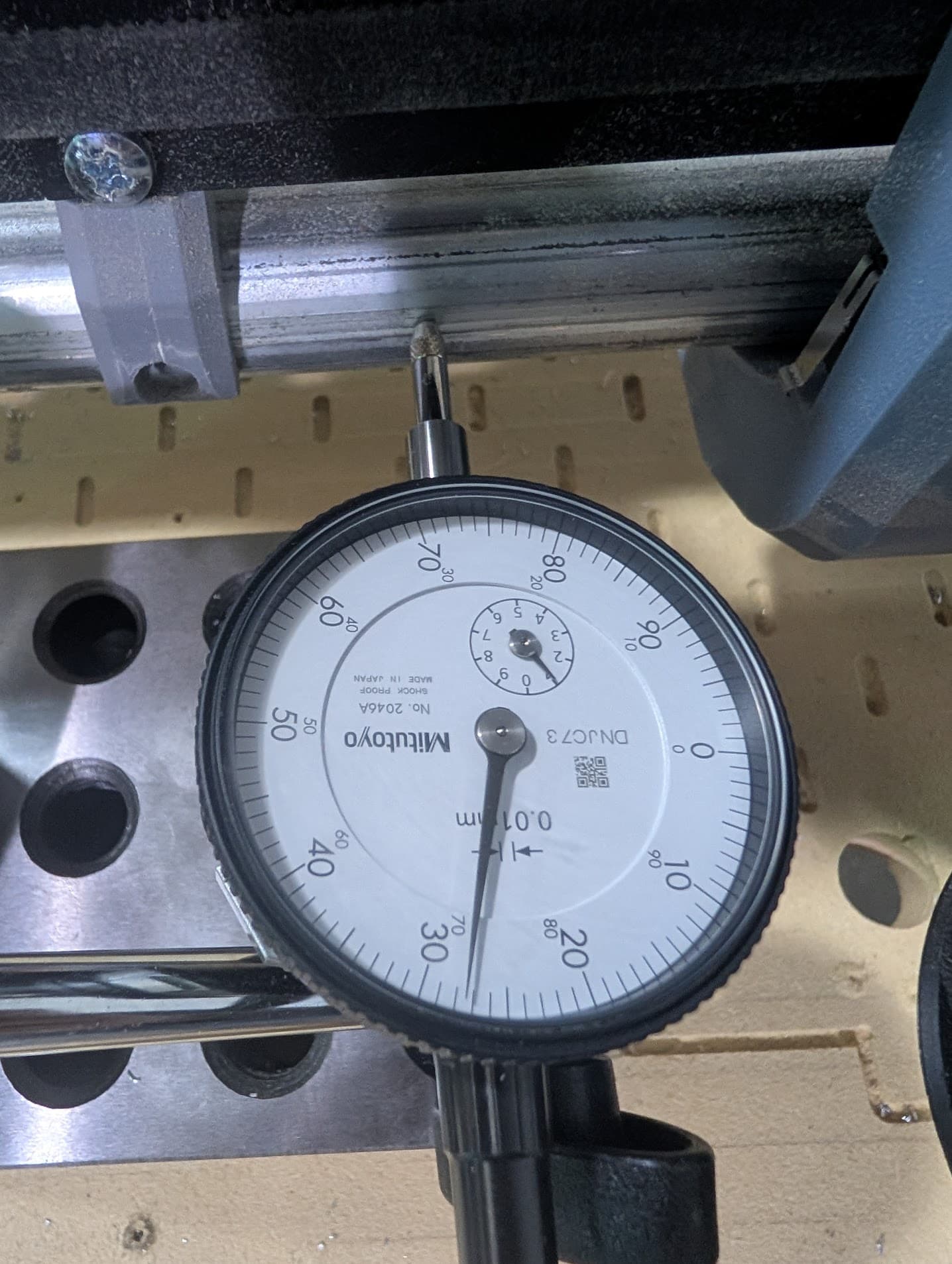

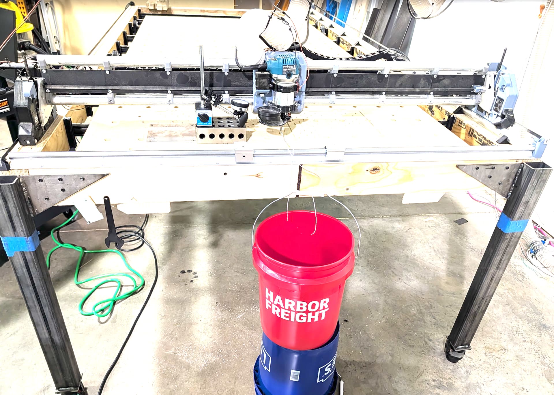

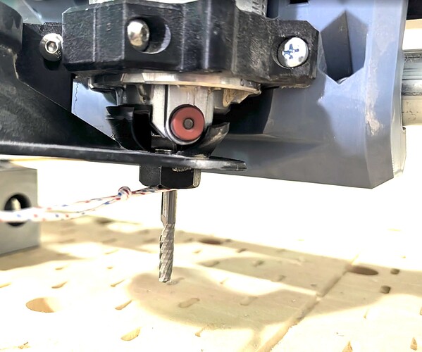

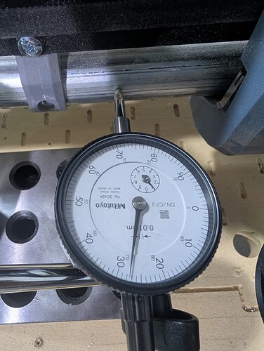

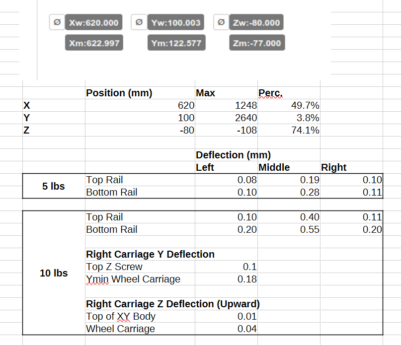

To try and diagnose the issue, I setup a relatively crude test.
  • I positioned the spindle/main body in the middle of the gantry, dropped my Z to approx. 75% of the way down (80mm from Z-home)
  • Using a dial indicator, I measured the displacement at 10 different points when a known force was exerted (5lbs/2.3kg and then 10lbs/4.5kg) at the base of the collet
  • I ran the “test” a few times in different orders of measurement to ensure the results were similar (on the first run, I did discover my X-max side belt was a bit looser than X-min, but that batch of measurements were thrown out of the averages).
  • NOTE: I did the 5lb tests first, once I got to the 10lb tests, I started wondering about the potential tilt of the XY carriages (i.e. a wheel lifting off the bed), so I did add some more measurement points in that batch (6 points of measure for 5lbs, 10 points measured at 10lbs).

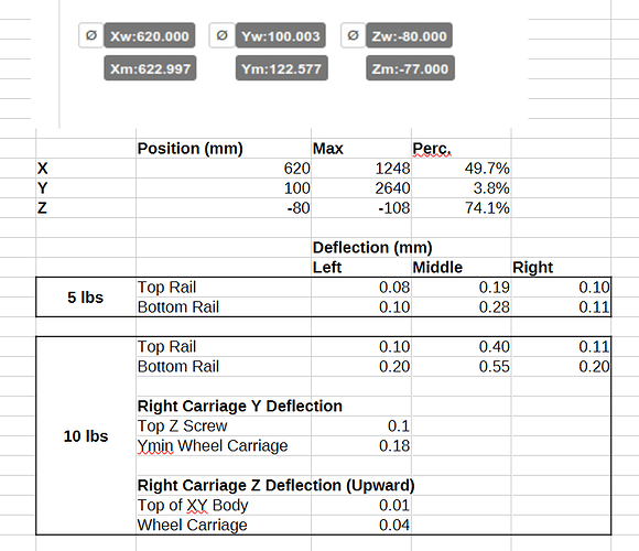

Here’s a screenshot of the data. I’ll also upload a few pics of the test setup. I took a bunch in case they end up being helpful, but I don’t want to make this post any longer than necessary.
I guess my question is, do you think these deflections are “normal” for a Lowrider v4? I feel like this amount of deflection is likely abnormal as the forces I’ve applied are roughly withing the radial + tangential forces that the gantry would experience when cutting aluminum. And if it’s deflecting this much, it wouldn’t be able to cut aluminum (i.e. it would absolutely chatter like I’m experiencing).
Thanks in advance for (a) reading this far and (b) sharing any ideas you may have.
I didn’t put any of my initial impressions in the first post, as I thought it would be better to leave it a “blank slate” for reactions. A couple things jumped out at me.
  • I does appear that the gantry is flexing in the center, (the difference in deflection between the middle of the rail and the ends of the rail, noticeable in both the 5lb and 10lb test ).
  • It also appears that the whole assembly may be “lifting” off the bed, i.e. one set of wheels lifting up. I say this based on the additional measurements I did on the 10lb test.
In regards to the flex of the conduit/gantry, maybe that could be caused by a poor build (I missed something, need to tighten something, etc) and exacerbated by the width of my gantry (1.2m) . However, the lifting/tilting of the whole assembly seems like a pure physics/geometry situation and it’s should be independent of the size of build (the geometry of the XY bodies doesn’t change based off of build size, and it’s just based on the weight/base/leverage of those bodies to resist that type of torque).
Just some first/rough thoughts based on these initial measurements.

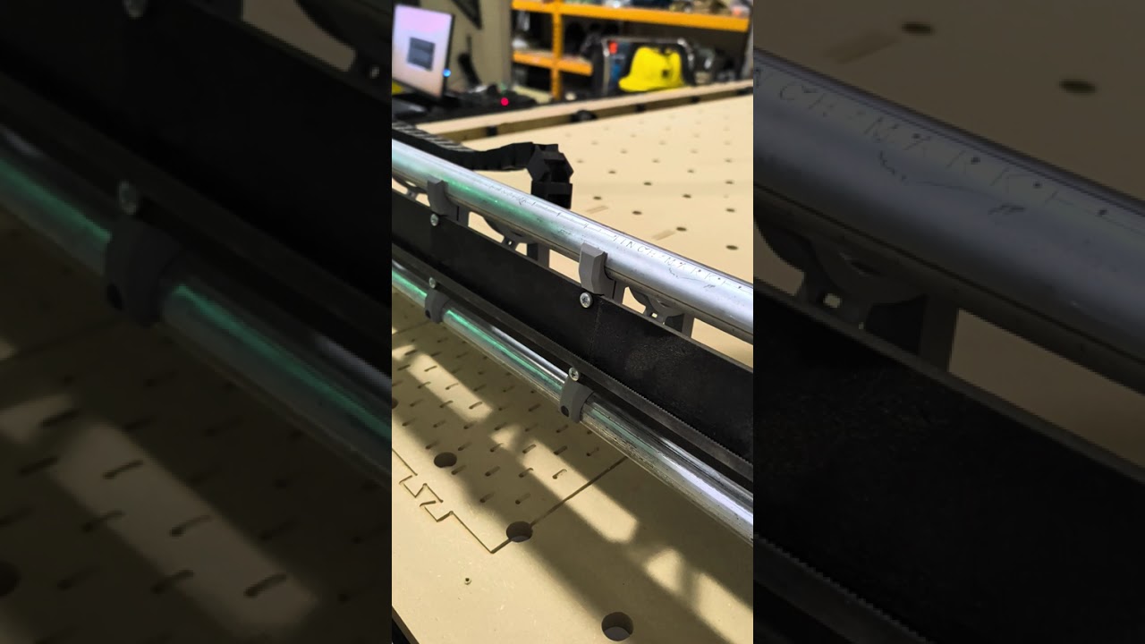

Edit to add a quick video showing the flex. It’s not of the test, just my brother putting a moderate amount of pressure with his hand.
The video looks pretty normal to me, the cutting forces shouldn’t be too high obviously. Did you try trochoidal for aluminium?
Wow. That center bow is telling. How wide is your gantry? Did you make the interlocking strut plate for the underside? If not. I wonder if that would help.
The gantry is 1440mm wide (measured end to end of the EMT tubing). I didn’t know about the interlocking strut plates for the underside. Somehow I must have missed that part. I’ll check them out and maybe crank them out with so CF filament.

I just looked at your video. It almost seems like the gantry is “rocking” on the table. This could be due to a twist in the gantry (common) that results in the bearings in the YZ plates not all resting against the table surface/Y rail at the same time. Have you checked to see if one or more of the bearings aren’t contacting the table surface/Y rail when at rest?
